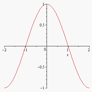

Below is the wavefunction of psi[1], ideally i'd like to change the axis labels to show an 'a' and '-a' where the 1's are - is that possible?
plot(cos((Pi*x)/2),x=-2..2)
