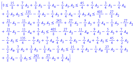

for j from 1 to n do
 eqs := eqs union { A[j] <= B[j] };
 eqs := eqs union {1/(2^(n-k-1))*(add(P[j](2*r)*A[2*r],r=0..floor(n/2))) >= B[j]};
od:
eqs;
{0 <= 15/8+(7/8)*A[2]+(3/8)*A[3]-(1/8)*A[4]-(5/8)*A[5], A[2] <= 45/4+(5/4)*A[2]-(3/4)*A[3]-(3/4)*A[4]+(5/4)*A[5], A[3] <= 135/4-(9/4)*A[2]-(5/4)*A[3]+(7/4)*A[4]-(5/4)*A[5], A[4] <= 405/8-(27/8)*A[2]+(21/8)*A[3]-(11/8)*A[4]+(5/8)*A[5], A[5] <= 243/8+(27/8)*A[2]-(9/8)*A[3]+(3/8)*A[4]-(1/8)*A[5], -(27/8)*A[2]+(21/8)*A[3]-(11/8)*A[4]+(5/8)*A[5] <= 405/8-(27/4)*A[2]-(11/4)*A[4], -(9/4)*A[2]-(5/4)*A[3]+(7/4)*A[4]-(5/4)*A[5] <= 135/4-(9/2)*A[2]+(7/2)*A[4], (5/4)*A[2]-(3/4)*A[3]-(3/4)*A[4]+(5/4)*A[5] <= 45/4+(5/2)*A[2]-(3/2)*A[4], (7/8)*A[2]+(3/8)*A[3]-(1/8)*A[4]-(5/8)*A[5] <= 15/8+(7/4)*A[2]-(1/4)*A[4], (27/8)*A[2]-(9/8)*A[3]+(3/8)*A[4]-(1/8)*A[5] <= 243/8+(27/4)*A[2]+(3/4)*A[4]}
