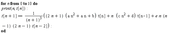

a := 10:
t := array(-2 .. 100):
for n from 0 to 10 do print(n, t[n]); t[n+1] := ((2*n+1)*(a*n^2+a*n+b)*t[n]+n*(c*n^2+d)*t[n-1]+e*n*(n-1)*(2*n-1)*t[n-2])/(n+1)^3 end do:
