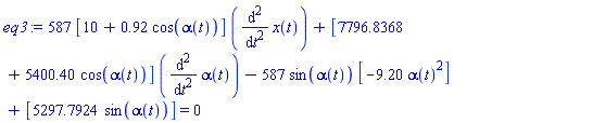

eq3:=mp*[d+l*cos(alpha(t))]*diff(x(t),t$2)+[Ip+mp*l^2+mp*d*l*cos(alpha(t))]*diff(alpha(t),t$2)-mp*sin(alpha(t))*[-l*d*alpha(t)^2]+mp*[l*9.81*sin(alpha(t))]=0;
587*[10+.92*cos(alpha(t))]*(diff(diff(x(t), t), t))+[7796.8368+5400.40*cos(alpha(t))]*(diff(diff(alpha(t), t), t))-587*sin(alpha(t))*[-9.20*alpha(t)^2]+[5297.7924*sin(alpha(t))] = 0
