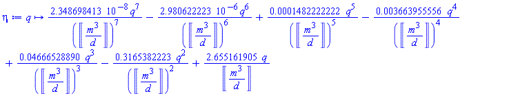

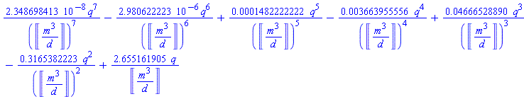

CurveFitting[PolynomialInterpolation](`pointsη`, q)
0.2348698413e-7*q^7/Units:-Unit(m^3/d)^7-0.2980622223e-5*q^6/Units:-Unit(m^3/d)^6+0.1482222222e-3*q^5/Units:-Unit(m^3/d)^5-0.3663955556e-2*q^4/Units:-Unit(m^3/d)^4+0.4666528890e-1*q^3/Units:-Unit(m^3/d)^3-.3165382223*q^2/Units:-Unit(m^3/d)^2+2.655161905*q/Units:-Unit(m^3/d)
eta := proc (q) options operator, arrow; 0.2348698413e-7*q^7/Units:-Unit(m^3/d)^7-0.2980622223e-5*q^6/Units:-Unit(m^3/d)^6+0.1482222222e-3*q^5/Units:-Unit(m^3/d)^5-0.3663955556e-2*q^4/Units:-Unit(m^3/d)^4+0.4666528890e-1*q^3/Units:-Unit(m^3/d)^3-.3165382223*q^2/Units:-Unit(m^3/d)^2+2.655161905*q/Units:-Unit(m^3/d) end proc

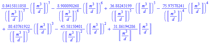

eta(12*Unit('m'^3/'day'))
.8415811058*Units:-Unit(m^3/d)^7/Units:-Unit(m^3/d)^7-8.900090268*Units:-Unit(m^3/d)^6/Units:-Unit(m^3/d)^6+36.88243199*Units:-Unit(m^3/d)^5/Units:-Unit(m^3/d)^5-75.97578241*Units:-Unit(m^3/d)^4/Units:-Unit(m^3/d)^4+80.63761922*Units:-Unit(m^3/d)^3/Units:-Unit(m^3/d)^3-45.58150401*Units:-Unit(m^3/d)^2/Units:-Unit(m^3/d)^2+31.86194286*Units:-Unit(m^3/d)/Units:-Unit(m^3/d)
simplify(19.76619849)
Error, (in Units:-Standard:-+) the units `m^21/s^7` and `m^18/s^6` have incompatible dimensions

I got a function (from CurveFitting), that produce a polynomial with the some units inside:
As i can see, it can be easy simplified, but i get:
Is where any trick to do it, without stripping units with convert(unit_free) or something?
