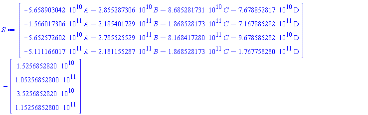

How I can solve this algebraic equations to find unknowns A,B,C,D?
I want to gain A,B,C,D automatically without input the coefficients in solve rule by hand.
Because I should run the code for many input data

S:=(Matrix([[rho*h*omega[m,n]^2+k[1, 1],k[1,2],k[1,3],k[1,4]],[k[2,1],rho*h*omega[m,n]^2+k[2,2],k[2,3],k[2,4]],[k[3,1],k[3,2],k[3,3]+rho*h*omega[m,n]^2,k[3,4]],[k[4,1],k[4,2],k[4,3],k[4,4]+rho*h*omega[m,n]^2]])).(Vector(1..4,[[A],[B],[C],[D]]))=-E*(Vector(1..4,[k[1,5],k[2, 5],k[3,5],k[4,5]]));
(Vector(4, {(1) = -0.5658903042e11*A-0.2855287306e11*B-0.8685281731e11*C-0.7678852817e11*D, (2) = -0.1566017306e12*A-0.2185401729e12*B-0.1868528173e12*C-0.7167885282e12*D, (3) = -0.5652572602e11*A-0.2785525529e12*B-0.8168417280e12*C-0.9678585282e11*D, (4) = -0.5111166017e12*A-0.2181155287e12*B-0.1868528173e12*C-0.1767758280e12*D})) = (Vector(4, {(1) = 0.1525685282e11, (2) = 0.1052568528e12, (3) = 0.3525685282e11, (4) = 0.1152568528e12}))
