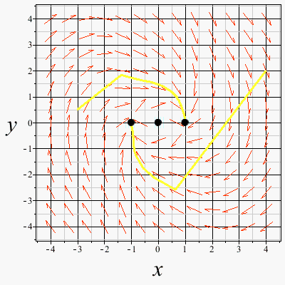

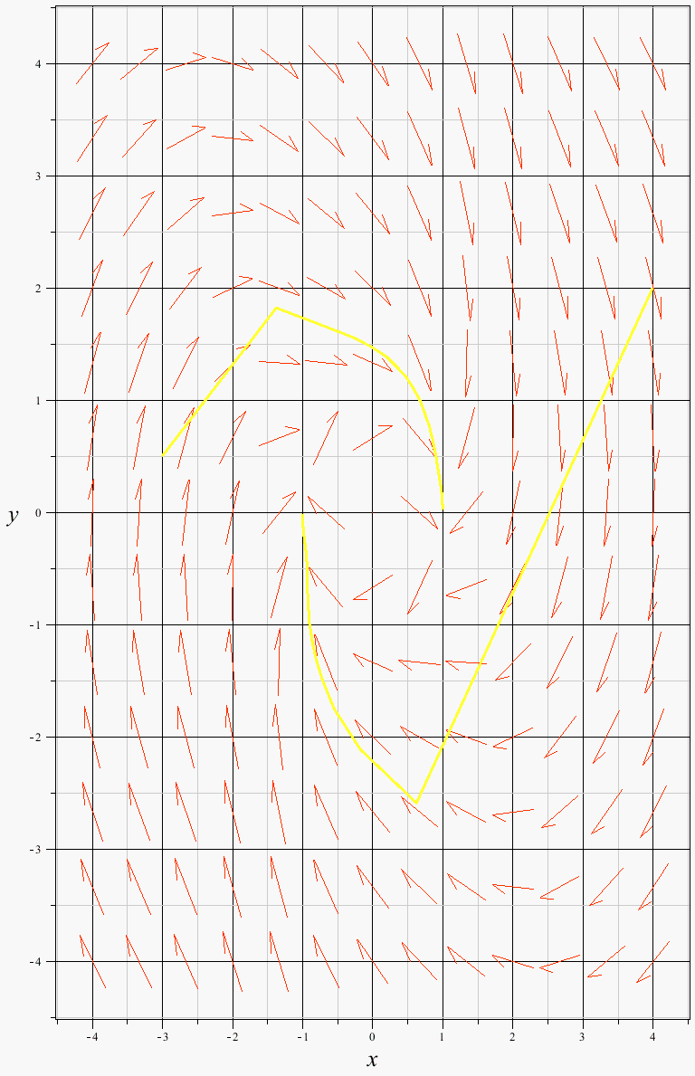

Question: problem with ode
why is  the figure  so weird ? How can I get the smooth trajectories of the ode system?

p1 := phaseportrait([diff(x(t), t) = x(t)*(1-x(t)^2-y(t)^2)+y(t)*(y(t)^2+(x(t)^2-1)^2), diff(y(t), t) = y(t)*(1-x(t)^2-y(t)^2)-x(t)*(y(t)^2+(x(t)^2-1)^2)], [x(t), y(t)], t = 0 .. 50, [[x(0) = -3, y(0) = .5], [x(0) = 4, y(0) = 2]], x = -4 .. 4, y = -4 .. 4, dirgrid = [13, 13], stepsize = 0.5e-1, axes = BOXED)

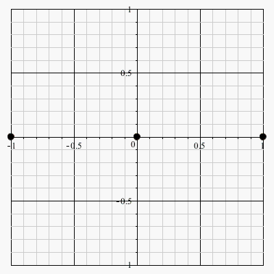

p2 := pointplot([[1, 0], [-1, 0], [0, 0]], symbolsize = 20, symbol = solidcircle, color = black)
display(p1, p2)
