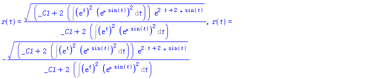

solve it by Maple , get the following form solution, what's the Int(1,0)
ODE :=diff(r(t),t)=r(t)*(1-r(t)^2)+mu*r(t)*cos(t)
diff(r(t), t) = r(t)*(1-r(t)^2)+mu*r(t)*cos(t)
dsolve(ODE)
r(t) = ((_C1+2*(Int((exp(t))^2*(exp(mu*sin(t)))^2, t)))*exp(2*t+2*mu*sin(t)))^(1/2)/(_C1+2*(Int((exp(t))^2*(exp(mu*sin(t)))^2, t))), r(t) = -((_C1+2*(Int((exp(t))^2*(exp(mu*sin(t)))^2, t)))*exp(2*t+2*mu*sin(t)))^(1/2)/(_C1+2*(Int((exp(t))^2*(exp(mu*sin(t)))^2, t)))
g := unapply(sqrt((C1+2*(Int((exp(t))^2*(exp(mu*sin(t)))^2, t)))*exp(2*t+2*mu*sin(t)))/(C1+2*(Int((exp(t))^2*(exp(mu*sin(t)))^2, t))), t)
proc (t) options operator, arrow; ((C1+2*(Int((exp(t))^2*(exp(mu*sin(t)))^2, t)))*exp(2*t+2*mu*sin(t)))^(1/2)/(C1+2*(Int((exp(t))^2*(exp(mu*sin(t)))^2, t))) end proc
g(0)
1/(C1+2*(Int(1, 0)))^(1/2)
