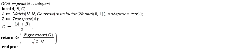

First create a procedure for the Gaussian orthogonal ensemble, GOE, with mean 0 and variance 1. This procedure extracts the normalised eigenvalues for a symmetric matrix added to its transpose and divided by 2:
GOE := proc (N::integer) local A, B, C; A := Matrix(N, N, Generate(distribution(Normal(0, 1)), makeproc = true)); B := Transpose(A); C := (1/2)*A+(1/2)*B; return Re(Eigenvalues(C)/sqrt(2*N)) end proc

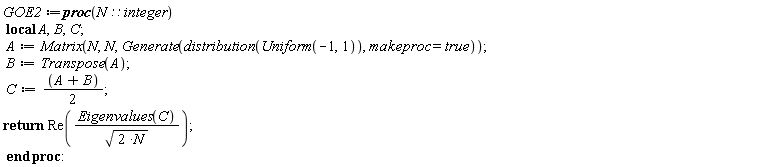

The histogram shows a normal distribution centred around 0, as expected. Increasing the value of N makes the distribution trend more and more towards the ideal Gaussian distribution as N tends to infinity, since a bigger sample size tends to the statistical mean. This procedure can be repeated for uniformly distributed random numbers in the range -1 to +1:
GOE2 := proc (N::integer) local A, B, C; A := Matrix(N, N, Generate(distribution(Uniform(-1, 1)), makeproc = true)); B := Transpose(A); C := (1/2)*A+(1/2)*B; return Re(Eigenvalues(C)/sqrt(2*N)) end proc

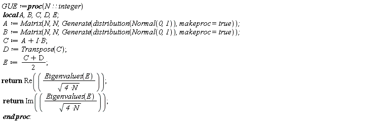

The same principle also applies to complex Hermitian matrices in the Gaussian unitary emsemble (GUE), though complex numbers cannot be normally graphed on histograms. By taking the real and imaginary parts of the eigenvalues separately, it is possible to plot the distribution on a histogram, since both parts have the same distribution.
GUE := proc (N::integer) local A, B, C, D, E; A := Matrix(N, N, Generate(distribution(Normal(0, 1)), makeproc = true)); B := Matrix(N, N, Generate(distribution(Normal(0, 1)), makeproc = true)); C := A+I*B; D := Transpose(C); E := (1/2)*C+(1/2)*D; return Re(Eigenvalues(E)/sqrt(4*N)); return Im(Eigenvalues(E)/sqrt(4*N)) end proc

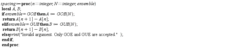

Finally, a procedure can return the spacings between the nth energy levels of the eigenvalues, taking the nth level spacing as "lambda[n+1]-lambda[n]."This procedure can work for the GOE or GUE distributions, and must check for these as valid arguments.
spacing := proc (n::integer, N::integer, ensemble) local A, B; if ensemble = GOE then A := GOE(N); return A[n+1]-A[n] elif ensemble = GUE then B := GUE(N); return B[n+1]-B[n] else print("Invalid argument. Only GOE and GUE are accepted.") end if end proc
