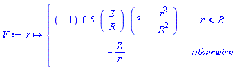

V := proc (r) options operator, arrow; piecewise(r < R, (-1)*.5*(Z/R)*(3-r^2/R^2), -Z/r) end proc

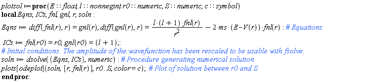

plotsol := proc (E::float, l::nonnegint, r0::numeric, S::numeric, c::symbol) local Eqns, ICs, fnl, gnl, r, soln; Eqns := diff(fnl(r), r) = gnl(r), diff(gnl(r), r) = l*(l+1)*fnl(r)/r^2-2*ms*(E-V(r))*fnl(r); ICs := fnl(r0) = r0, gnl(r0) = l+1; soln := dsolve({Eqns, ICs}, numeric); plots[odeplot](soln, [r, fnl(r)], r0 .. S, color = c) end proc
We are looking for a solution with l=0, and the offset r0 to prvent division by 0 must be much smaller than the Bohr radius given the scale of the orbit. We need to estimate bounds for the energy and set an upper bound for the effective range of the potential. This upper bound must be low enough for Maple to calculate the function, which unfortunately means only a few Bohr radii out.

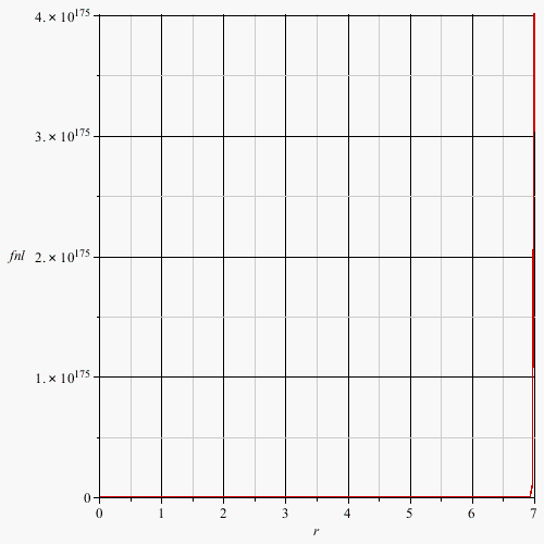

plotsol(-38.5, 0, 0.1e-9, 7.0, red)NULL
plotsol(-38.6, 0, 0.1e-9, 7.0, blue)
These bounds show that the ground state binding energy is between -39 and -38 Hartrees, since fnl tends to negative infinity at one bound and positive infinity at the other. To home in on the correct value, we plot the function between the bounds and find the zero.

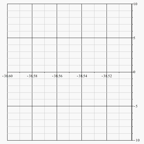

plot(proc (x) options operator, arrow; fnl_at_S(x, 0.1e-9, 0, 4.0) end proc, -38.6 .. -38.5)
Warning, unable to evaluate the function to numeric values in the region; see the plotting command's help page to ensure the calling sequence is correct

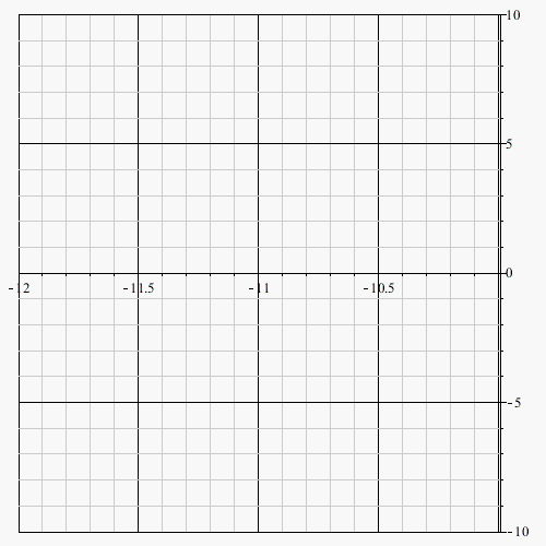

plot(proc (x) options operator, arrow; fnl_at_S(x, 0.1e-9, 1, 8.0) end proc, -12.0 .. -10.0)
