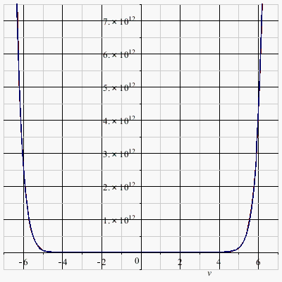

I made an integration and it gave me a really long answer. The answer of the book is the same, as you can see, i "smartplotted" the two answers, and they are the same. But how do i get the nice short answer? I tried a lot of different things, but nothing gave me that short answer.

smartplot(f(v), f1(v))
