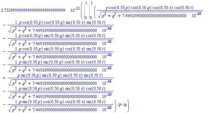

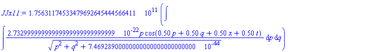

Hope you are fine. I am facing issues in integration evaluations. I have attched code and pic as well. Kindly guide me. I am waiting for your kind response.

ff11 := cos(1.0*k*(p+q+x+t)):
JJx11 := QQ*(int(int(p*ff11/`&gamma;&gamma;Exact`, p), q))/m;
175631174533.479692645444566411*(int(int(0.273299999999999999999999999999e-21*p*cos(.50*p+.50*q+.50*x+.50*t)/(p^2+q^2+0.746928900000000000000000000000e-43)^(1/2), p), q))
evalf(IntegrationTools:-Expand(%));
Warning,  computation interrupted
int(int(p*ff11/`&gamma;&gamma;Exact`, p = 0 .. 1), q = 0 .. 1); evalf(IntegrationTools:-Expand(%))
int(int(0.273299999999999999999999999999e-21*p*cos(.50*p+.50*q+.50*x+.50*t)/(p^2+q^2+0.746928900000000000000000000000e-43)^(1/2), p = 0 .. 1), q = 0 .. 1)
0.273299999999999999999999999999e-21*(Int(Int(p*cos(.50*p)*cos(.50*q)*cos(.50*x)*cos(.50*t)/(p^2+q^2+0.746928900000000000000000000000e-43)^(1/2)-1.*p*cos(.50*p)*cos(.50*q)*sin(.50*x)*sin(.50*t)/(p^2+q^2+0.746928900000000000000000000000e-43)^(1/2)-1.*p*cos(.50*p)*sin(.50*q)*sin(.50*x)*cos(.50*t)/(p^2+q^2+0.746928900000000000000000000000e-43)^(1/2)-1.*p*cos(.50*p)*sin(.50*q)*cos(.50*x)*sin(.50*t)/(p^2+q^2+0.746928900000000000000000000000e-43)^(1/2)-1.*p*sin(.50*p)*sin(.50*q)*cos(.50*x)*cos(.50*t)/(p^2+q^2+0.746928900000000000000000000000e-43)^(1/2)+p*sin(.50*p)*sin(.50*q)*sin(.50*x)*sin(.50*t)/(p^2+q^2+0.746928900000000000000000000000e-43)^(1/2)-1.*p*sin(.50*p)*cos(.50*q)*sin(.50*x)*cos(.50*t)/(p^2+q^2+0.746928900000000000000000000000e-43)^(1/2)-1.*p*sin(.50*p)*cos(.50*q)*cos(.50*x)*sin(.50*t)/(p^2+q^2+0.746928900000000000000000000000e-43)^(1/2), p = 0. .. 1.), q = 0. .. 1.))
