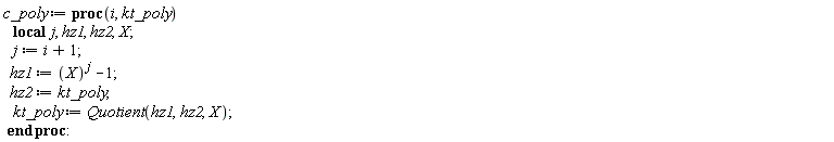

c_poly := proc (i, kt_poly) local j, hz1, hz2, X; j := i+1; hz1 := X^j-1; hz2 := kt_poly; kt_poly := Quotient(hz1, hz2, X) end proc
cyclo_poly[2] := c_poly(i, cyclo_poly[i])
Error, (in c_poly) illegal use of a formal parameter

Why doesn't Quotient(x,y,z) not work within a procedure whereas it works well standing alone? See example.
