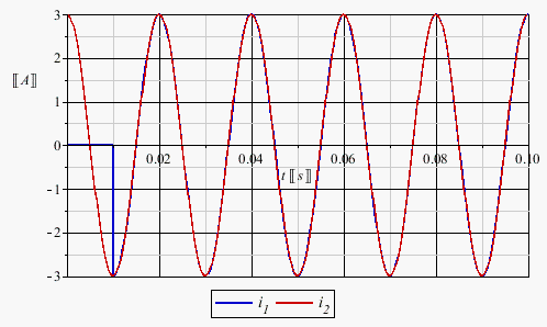

I use Maple and Maple Flow and want to work with physical units. However, I am quickly reaching the limits of what is possible. Now the question: Would it be possible to work with units and the piecewise function? In the attached example, the integration of a defined function is no longer possible. Or should I proceed differently in principle? Many thanks for any advice

Definition of current functions
"`i__1`(t):={[[0&lobrk;A&robrk;,t<0.01&lobrk;s&robrk;],[3&lobrk;A&robrk;*cos((2*Pi*t)/(T)),t>=0.01&lobrk;s&robrk;]]:"
"`i__2`(t):=3&lobrk;A&robrk;*cos((2*Pi*t)/(T)):"
"`i__3`(t):={[[0,t<0.01],[3*cos((2*Pi*t)/(`T__3`)),t>=0.01]]:"
T := 0.2e-1*Unit('s')
plot([i__1(t), i__2(t)], t = 0 .. .1*Unit('s'), color = [blue, red], legend = [i__1, i__2])
