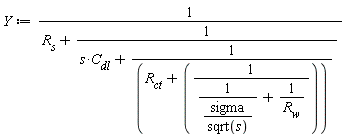

I am fairly new to Maple and would like to programatically simplify the output form using Maple's pade function on an arbitrary function: Y := 1/(R__s + 1/(s*C__dl + 1/(R__ct + 1/(sqrt(s)/sigma + 1/R__w))))

Y := 1/(R__s+1/(s*C__dl+1/(R__ct+1/(sqrt(s)/sigma+1/R__w))))
1/(R__s+1/(s*C__dl+1/(R__ct+1/(s^(1/2)/sigma+1/R__w))))
