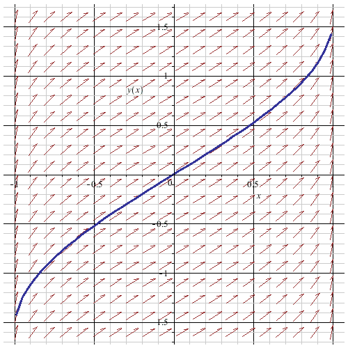

But this works
ode:=diff(y(x),x)-1/(-x^2+1)^(1/2) = 0;
x_range:=-0.99 .. 0.99;
DEtools:-DEplot(ode,y(x),x =x_range,y = -1.6 .. 1.6,[y(0) = 0])

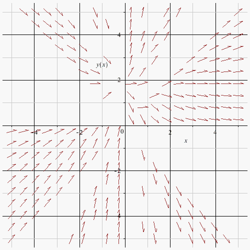

Update FEB 18, 2025
FYI, This is another example of DEplot failing. This time when using arrows=comet.
I hope Maplesoft can fix these problems in Maple 2025.
interface(version);
`Standard Worksheet Interface, Maple 2024.2, Windows 10, October 29 2024 Build ID 1872373`
Physics:-Version();
`The "Physics Updates" version in the MapleCloud is 1843 and is the same as the version installed in this computer, created 2025, January 25, 22:5 hours Pacific Time.`
ode:=diff(y(x),x) = y(x)/x-2/x*sin(3*y(x)/x)^(1/2);
diff(y(x), x) = y(x)/x-2*sin(3*y(x)/x)^(1/2)/x
DEtools:-DEplot( ode, y(x), x=-5..5,y=-5..5);
DEtools:-DEplot( ode, y(x), x=-5..5,y=-5..5,'arrows'='comet');
Error, (in DEtools/DEplot/direction) cannot assign a complex value to a hardware float Array
DEtools:-DEplot( ode, y(x), x=-5..5,y=-5..5,'arrows'='comet',arrowsize =  magnitude);
