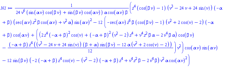

N1 := simplify((1 - z^2/2) + z^4 * (b^+ . AUX), size)
(1/24)*(z^4*(cos(beta*v)-1)*(v^3-24*v+24*sin(v))*(-alpha+beta)*(sec(alpha*v)*z^2*beta*cos(alpha*v)+v^2*alpha)*sin(alpha*v)^2-12*(-sec(alpha*v)*z^6*beta*(cos(beta*v)-1)*(v^2+2*cos(v)-2)*(-alpha+beta)*cos(alpha*v)+((2*z^4*(-alpha+beta)^2*cos(v)+(-alpha+beta)^2*(v^2-2)*z^4+v^4*z^2*beta*alpha-2*v^4*beta*alpha)*cos(beta*v)-(1/12)*(-alpha+beta)*z^4*((v^3-24*v+24*sin(v))*(beta+alpha)*sin(beta*v)-12*alpha*(v^2+2*cos(v)-2)))*v^2)*cos(alpha*v)*sin(alpha*v)-12*sin(beta*v)*(-2*(-alpha+beta)*z^4*cos(v)-(v^2-2)*(-alpha+beta)*z^4+v^4*z^2*beta-2*v^4*beta)*v^2*alpha*cos(alpha*v)^2)/(v^6*(sin(alpha*v)*cos(beta*v)+sin(beta*v)*cos(alpha*v))*alpha*cos(alpha*v)*beta)

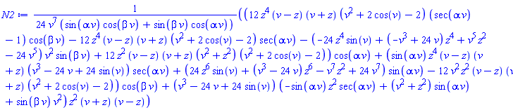

N2 := simplify(1 - z^2 * (b^+ . L1 . e), size)
(1/24)*((12*z^4*(v-z)*(v+z)*(v^2+2*cos(v)-2)*(sec(alpha*v)-1)*cos(beta*v)-12*z^4*(v-z)*(v+z)*(v^2+2*cos(v)-2)*sec(alpha*v)-(-24*z^4*sin(v)+(-v^3+24*v)*z^4+v^5*z^2-24*v^5)*v^2*sin(beta*v)+12*z^2*(v-z)*(v+z)*(v^2+z^2)*(v^2+2*cos(v)-2))*cos(alpha*v)+(sin(alpha*v)*z^4*(v-z)*(v+z)*(v^3-24*v+24*sin(v))*sec(alpha*v)+(24*z^6*sin(v)+(v^3-24*v)*z^6-v^7*z^2+24*v^7)*sin(alpha*v)-12*v^2*z^2*(v-z)*(v+z)*(v^2+2*cos(v)-2))*cos(beta*v)+(v^3-24*v+24*sin(v))*(-sin(alpha*v)*z^2*sec(alpha*v)+(v^2+z^2)*sin(alpha*v)+sin(beta*v)*v^2)*z^2*(v+z)*(v-z))/(v^7*(sin(alpha*v)*cos(beta*v)+sin(beta*v)*cos(alpha*v)))

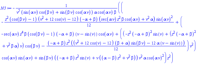

N3 := simplify(-z^2 + z^4 * (bp^+ . AUX), size)
-(-(1/12)*z^2*(cos(beta*v)-1)*(v^2+12*cos(v)-12)*(-alpha+beta)*(sec(alpha*v)*z^2*beta*cos(alpha*v)+v^2*alpha)*sin(alpha*v)^2+(-sec(alpha*v)*z^4*beta*(cos(beta*v)-1)*(-alpha+beta)*(v-sin(v))*cos(alpha*v)+((-z^2*(-alpha+beta)^2*sin(v)+(z^2*(-alpha+beta)^2+v^2*beta*alpha)*v)*cos(beta*v)-(1/12)*(-alpha+beta)*z^2*((v^2+12*cos(v)-12)*(beta+alpha)*sin(beta*v)-12*alpha*(v-sin(v))))*v^2)*cos(alpha*v)*sin(alpha*v)+sin(beta*v)*((-alpha+beta)*z^2*sin(v)+v*((alpha-beta)*z^2+v^2*beta))*v^2*alpha*cos(alpha*v)^2)*z^2/(v^5*(sin(alpha*v)*cos(beta*v)+sin(beta*v)*cos(alpha*v))*alpha*cos(alpha*v)*beta)

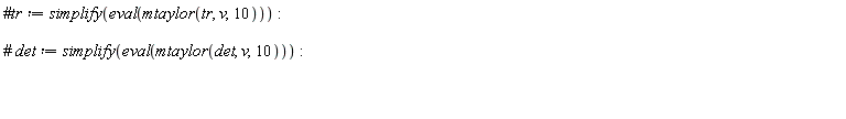

#eq1:=algsubs(v=lambda*h,det):
#eq2:=algsubs(z=mu*h,eq1):
#eq3:=algsubs(lambda=mu*k,eq2):
#eq4:=algsubs(v=lambda*h,eq3):
#csgn(sqrt(mu^10*k^10/v^10)*h^5):=1:
#simplify(series(sqrt(eq4),h,10));
#series(simplify(algsubs(v=,simplify(series(1-sqrt(det),z,8)))),z,8);
