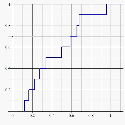

S := Statistics:-Sample(Uniform(0, 1), 10):
ecdf(S)

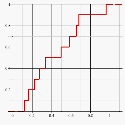

ecdf(S, ecdf_color="red", ecdf_thickness=3)
