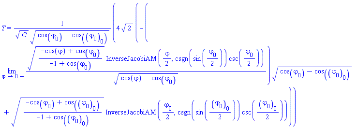

isolate(`assuming`([simplify(value((1/4)*T = Int(1/(2*C*cos(varphi)-2*C*cos(varphi[0]))^(1/2), varphi = 0 .. varphi[0], continuous)))], [C > 0, 0 < `&varphi;`[0] and `&varphi;`[0] < Pi]), T)
T = 4*2^(1/2)*(-(limit(((-cos(varphi)+cos(varphi[0]))/(-1+cos(varphi[0])))^(1/2)*InverseJacobiAM((1/2)*varphi, csgn(sin((1/2)*varphi[0]))*csc((1/2)*varphi[0]))/(cos(varphi)-cos(varphi[0]))^(1/2), varphi = 0, right))*(cos(varphi[0])-cos(varphi[0][0]))^(1/2)+((-cos(varphi[0])+cos(varphi[0][0]))/(-1+cos(varphi[0][0])))^(1/2)*InverseJacobiAM((1/2)*varphi[0], csgn(sin((1/2)*varphi[0][0]))*csc((1/2)*varphi[0][0])))/(C^(1/2)*(cos(varphi[0])-cos(varphi[0][0]))^(1/2))
The double indices in the above limit do not make sense.
In case this is a bug: Is there any workaround for indexed names? I want to use them to have numbers in indices in roman which seems to be not possible with subscripts.
