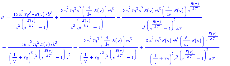

B:=int(diff(Sol_nu,nu),t=t..t+Tq);
16*Pi^2*Tq^3*nu*E(nu)*rb^3/(c^3*(exp(E(nu)/(k*T))-1))+8*Pi^2*Tq^3*nu^2*(diff(E(nu), nu))*rb^3/(c^3*(exp(E(nu)/(k*T))-1))-8*Pi^2*Tq^3*nu^2*E(nu)*rb^3*(diff(E(nu), nu))*exp(E(nu)/(k*T))/(c^3*(exp(E(nu)/(k*T))-1)^2*k*T)-16*Pi^2*Tq^3*E(nu)*rb^3/((1/nu+Tq)^3*c^3*(exp(E(nu)/(k*T))-1)*nu^2)-8*Pi^2*Tq^3*(diff(E(nu), nu))*rb^3/((1/nu+Tq)^2*c^3*(exp(E(nu)/(k*T))-1))+8*Pi^2*Tq^3*E(nu)*rb^3*(diff(E(nu), nu))*exp(E(nu)/(k*T))/((1/nu+Tq)^2*c^3*(exp(E(nu)/(k*T))-1)^2*k*T)

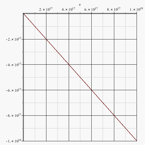

plot(-nu - 2*A*Tq*ln(Tq*nu + 1) + 3*A*Tq*ln(nu) + A*Tq*ln(Tq*nu + 2),nu=10^14..10^18);#Approx neglecting => -A*Tq*ln(exp(E(nu)/(k*T)) - 1) + A*Tq*ln(E(nu))

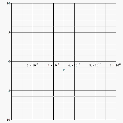

plot(E(nu),nu=10^14..10^18);
Warning, expecting only range variable nu in expression ln(exp(RootOf(-A*Tq*ln(nu^3/(Tq*nu+1)^2*(Tq*nu+2)*ln(exp(_Z)+1)*T*k)+_Z*A*Tq+ln(exp(_Z)+1)*T*k-C1+nu))+1)*T*k to be plotted but found names [A, C1, T, Tq, k]
