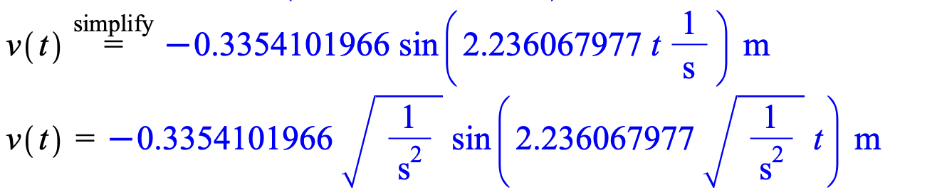

In Maple 2025, some units which are f.x. obviously 'J' is not recognices as 'J'.
In Maple 2025, part of units dissapears from expressions.
Just an example; the function v(t) below has correct units m/s, but when using simplify, the unit is changes to m
