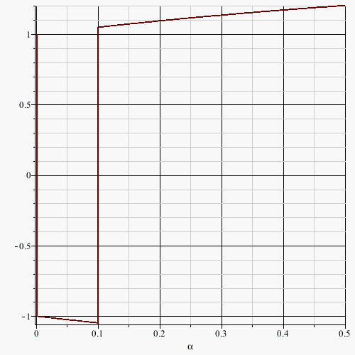

In the below plot switches between to solutions of a RootOf expression when the plot range starts at zero.

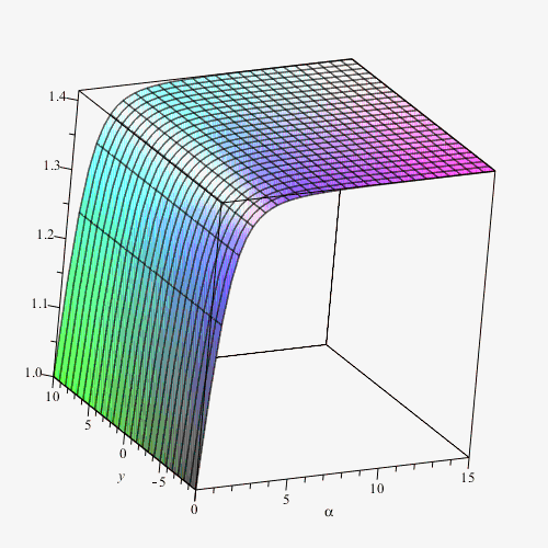

plot3d on the other hand sticks to one root.

plot(a, alpha = 0 .. .5)

plot3d(a)
