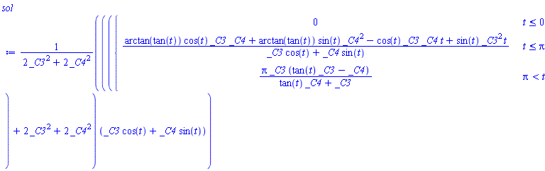

sol:=(piecewise(t <= 0,0,t <= Pi,(arctan(tan(t))*cos(t)*_C3*_C4+arctan(tan(t))*sin(t)*_C4^2-cos(t)*_C3*_C4*t+sin(t)*_C3^2*t)/(_C3*cos(t)+_C4*sin(t)),Pi < t,Pi*_C3*(tan(t)*_C3-_C4)/(tan(t)*_C4+_C3))+2*_C3^2+2*_C4^2)*(_C3*cos(t)+_C4*sin(t))/(2*_C3^2+2*_C4^2)
sol := (piecewise(t <= 0, 0, t <= Pi, (arctan(tan(t))*cos(t)*_C3*_C4+arctan(tan(t))*sin(t)*_C4^2-cos(t)*_C3*_C4*t+sin(t)*_C3^2*t)/(cos(t)*_C3+_C4*sin(t)), Pi < t, Pi*_C3*(tan(t)*_C3-_C4)/(tan(t)*_C4+_C3))+2*_C3^2+2*_C4^2)*(cos(t)*_C3+_C4*sin(t))/(2*_C3^2+2*_C4^2)
limit(sol,[_C3 = 0, _C4 = 0])
Error, (in limit/multi/ldegree1) invalid input: limit/multi/ReIm expects its 1st argument, f, to be of type polynom, but received _DIR1*cos(t)+_DIR2*sin(t)
