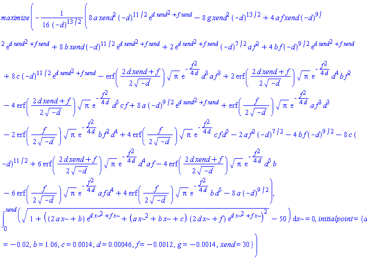

Question: Calculating the maximum with a constraint
...and starting values. I want to reproduce the maximum in Maple using the solution structure in the attached file, similar to the old Mathcad method. Instead of using the Euler-Lagrange equation, I want to separately enter the objective function, then the boundary conditions, and finally the starting values ​​for an iteration (as was done in the old Mathcad solution block). I entered the latter into the "maximize" command using the Maple help text. But nothing is being calculated. What am I doing wrong? As I said, I only want a numerically generated approximate solution.test.mw

maximize(wn(a, b, c, d, f, g, xend), constr(a, b, c, d, f, g, xend), initialpoint = {a = -0.2e-1, b = 1.06, c = 0.14e-2, d = 0.46e-3, f = -0.12e-2, g = -0.14e-2, xend = 30})
maximize(-(1/16)*(8*a*xend^2*(-d)^(11/2)*exp(d*xend^2+f*xend)-8*g*xend^2*(-d)^(13/2)+4*a*f*xend*(-d)^(9/2)*exp(d*xend^2+f*xend)+8*b*xend*(-d)^(11/2)*exp(d*xend^2+f*xend)+2*exp(d*xend^2+f*xend)*(-d)^(7/2)*a*f^2+4*b*f*(-d)^(9/2)*exp(d*xend^2+f*xend)+8*c*(-d)^(11/2)*exp(d*xend^2+f*xend)-erf((1/2)*(2*d*xend+f)/(-d)^(1/2))*Pi^(1/2)*exp(-(1/4)*f^2/d)*d^3*a*f^3+2*erf((1/2)*(2*d*xend+f)/(-d)^(1/2))*Pi^(1/2)*exp(-(1/4)*f^2/d)*d^4*b*f^2-4*erf((1/2)*(2*d*xend+f)/(-d)^(1/2))*Pi^(1/2)*exp(-(1/4)*f^2/d)*d^5*c*f+8*a*(-d)^(9/2)*exp(d*xend^2+f*xend)+erf((1/2)*f/(-d)^(1/2))*Pi^(1/2)*exp(-(1/4)*f^2/d)*a*f^3*d^3-2*erf((1/2)*f/(-d)^(1/2))*Pi^(1/2)*exp(-(1/4)*f^2/d)*b*f^2*d^4+4*erf((1/2)*f/(-d)^(1/2))*Pi^(1/2)*exp(-(1/4)*f^2/d)*c*f*d^5-2*a*f^2*(-d)^(7/2)-4*b*f*(-d)^(9/2)-8*c*(-d)^(11/2)+6*erf((1/2)*(2*d*xend+f)/(-d)^(1/2))*Pi^(1/2)*exp(-(1/4)*f^2/d)*d^4*a*f-4*erf((1/2)*(2*d*xend+f)/(-d)^(1/2))*Pi^(1/2)*exp(-(1/4)*f^2/d)*d^5*b-6*erf((1/2)*f/(-d)^(1/2))*Pi^(1/2)*exp(-(1/4)*f^2/d)*a*f*d^4+4*erf((1/2)*f/(-d)^(1/2))*Pi^(1/2)*exp(-(1/4)*f^2/d)*b*d^5-8*a*(-d)^(9/2))/(-d)^(13/2), int((1+((2*a*x+b)*exp(d*x^2+f*x)+(a*x^2+b*x+c)*(2*d*x+f)*exp(d*x^2+f*x))^2)^(1/2)-50, x = 0 .. xend) = 0, initialpoint = {a = -0.2e-1, b = 1.06, c = 0.14e-2, d = 0.46e-3, f = -0.12e-2, g = -0.14e-2, xend = 30})
