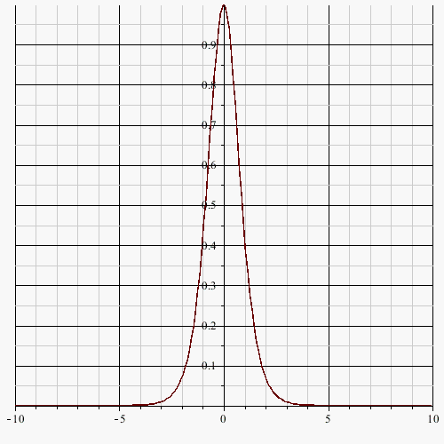

I could not figure out why Maple does not return tanh. Instead a complex valued function for real arguments is returned. This is not recent. I tried down to Maple 2020.  Is that correct?
D(tanh);
plot(%)
-tanh^2+1
int(D(tanh)(x),x);# I expected tanh
plot(%);# ok, no plot for real valued x
x+tanh(x)+(1/2)*ln(tanh(x)-1)-(1/2)*ln(tanh(x)+1)
Warning, unable to evaluate the function to numeric values in the region; complex values were detected
int(D(tanh)(x),x=0..infinity);# this result seems to be known in advance and fits to the above plot
int(D(tanh)(x),x=a..b);
eval(%,[a=0,b=infinity]);# I expected 1 from (1)
eval(%%,[a=0,b=50.]);# retruns complex for small values
-a-tanh(a)-(1/2)*ln(tanh(a)-1)+(1/2)*ln(tanh(a)+1)+b+tanh(b)+(1/2)*ln(tanh(b)-1)-(1/2)*ln(tanh(b)+1)
Error, (in ln) numeric exception: division by zero
-Float(infinity)-((1/2)*I)*Pi
evalf(int(D(tanh)(x),x=0..50))
1.000000000
