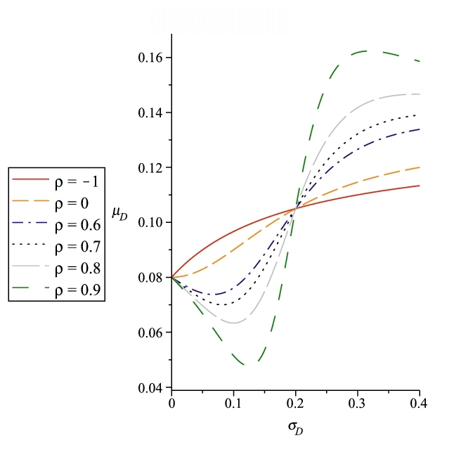

I have a plot with a vertical legend. The legend squeezes the axis to a very narrow width. The default sizes are definitely not optimal. So I'd like to make it wider. Topped up with the landscape option, which works. And no I don't want the legend above it or under it. Am I unreasonable?
But the plot comes out in the same size, no matter what I do. I can resize by hand to widen it inline or I can use acer's package (http://www.mapleprimes.com/posts/125899-Presized-Plots) to display the plots of a chosen size, but
what I need now is the ability to export in a custom size, and preferably to ps.

The plot below should appear quite narrow:
