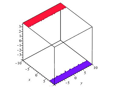

plot3d(subs(t=1,rhs(Sol2)),x=-10..10,y=-10..10,axes=boxed,grid=[50,50],
style=patchnogrid,shading=Z,orientation=[-40,50]);

plot3d(subs(t=1,rhs(Sol4[3])),x=-10..10,y=-10..10,axes=boxed,grid=[50,50],
