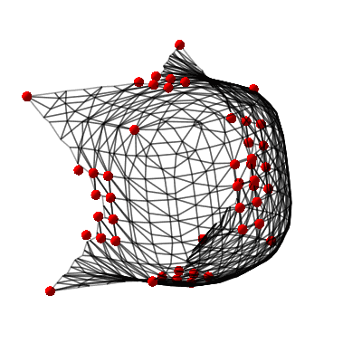

When I select the points with values of f(x,y,z) "close" to zero, I only get a few points on the surface:

The red balls are extracted from the ISOSURFACE structure. How can I get all points that are calculated when rendering this structure?
