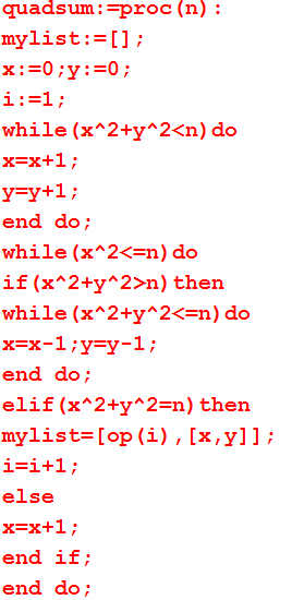

Question: procedure that takes integer n and returns an ordered pair (x,y) of solutions
I need to write a procedure that does the following :
Write a procedure quadsum whose input is an integer n and whose output is a list of pairs of solutions [x,y] to the above formula.
Your procedure should implement the following algorithm.
1 Initialization
Set
"mylist = []."
Start at
x = 0
and
y = 0.
2 Phase A
Increment both
x
and
y
until
"x^2+y^2 >=n."
Phase B
Repeat the following until
x^2>n
If you are above the circle
x^2 + y^2 = n
then go down in unit steps until you are on or below the circle.
If you are on the circle, add the point to the list
"mylist. "
If you are on or below the circle
x^2 + y^2 = n
then go one step to the right. My procedure is as follows: but it runs into an infinite loop(most probably because of the while loop defined inside the while loop). What am I doing incorrectly?
I have atta
