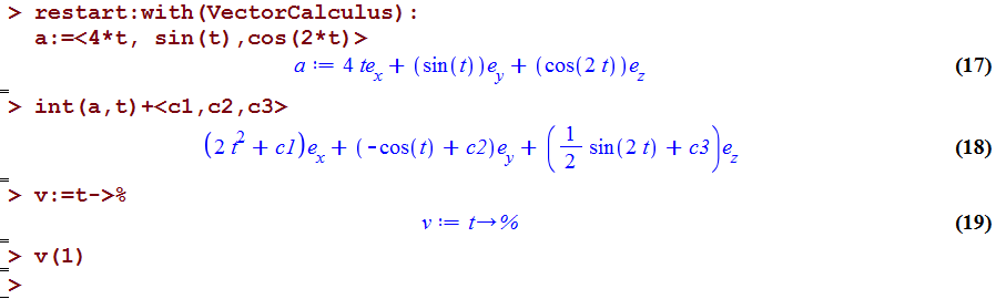

There is no output.

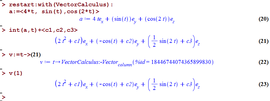

Another attempt. This time using a label

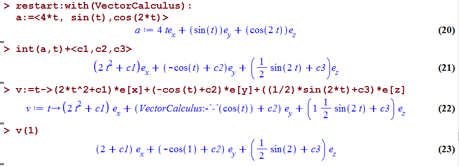

This time i do get an output, but v(1) should be (2 + c1) e_x + (-cos(1) + c2) e_y + (1/2 sin(2) + c3)e_z
The only way for it to work is to copy paste manually the output from line (21) as shown here
