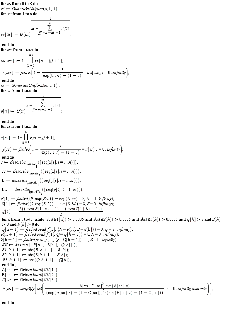

Question: fsolve in iteration
  here my loop; after  8 iteration maple couldnt solve the equations and give me this error .
Is there any method to garentee that fsolve could work intire the 1000 iteration

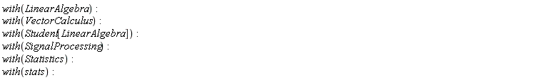

with(LinearAlgebra):

for so from 0 to K do W := GenerateUniform(n, 0, 1); for iii to n do vv[iii] := W[iii]^(1/(iii+sum(a[jjj], jjj = n-iii+1 .. n))) end do; for sss to n do uu[sss] := 1-product(vv[n-jjj+1], jjj = 1 .. sss); x[sss] := fsolve(1-3/(exp(.3*t)-(1-3)) = uu[sss], t = 0 .. infinity) end do; U := GenerateUniform(m, 0, 1); for ii to m do v[ii] := U[ii]^(1/(ii+sum(b[jj], jj = m-ii+1 .. m))) end do; for ss to m do u[ss] := 1-product(v[m-jj+1], jj = 1 .. ss); y[ss] := fsolve(1-3/(exp(.1*t)-(1-3)) = u[ss], t = 0 .. infinity) end do; c := describe[quartile[1]]([seq(x[i], i = 1 .. n)]); cc := describe[quartile[3]]([seq(x[i], i = 1 .. n)]); L := describe[quartile[1]]([seq(y[i], i = 1 .. m)]); LL := describe[quartile[3]]([seq(y[i], i = 1 .. m)]); R[1] := fsolve(9*exp(R*c)-exp(R*cc) = 8, R = 0 .. infinity); S[1] := fsolve(9*exp(S*L)-exp(S*LL) = 8, S = 0 .. infinity); Q[1] := 3*(exp(R[1]*c)-1+(exp(S[1]*L)-1))*(1/2); for h to 40 while `and`(`and`(`and`(`and`(`and`(abs(E1[h]) > 0.5e-3, abs(E2[h]) > 0.5e-3), abs(E3[h]) > 0.5e-3), Q[h] > 2), S[h] > 0), R[h] > 0) do Q[h+1] := fsolve(eval(f[3], {R = R[h], S = S[h]}) = 0, Q = 2 .. infinity); R[h+1] := fsolve(eval(f[1], Q = Q[h+1]) = 0, R = 0 .. infinity); S[h+1] := fsolve(eval(f[2], Q = Q[h+1]) = 0, S = 0 .. infinity); KK := Matrix([[R[h]], [S[h]], [Q[h]]]); E1[h+1] := abs(R[h+1]-R[h]); E2[h+1] := abs(S[h+1]-S[h]); E3[h+1] := abs(Q[h+1]-Q[h]) end do; A[so] := Determinant(KK[1]); B[so] := Determinant(KK[2]); C[so] := Determinant(KK[3]); P[so] := simplify(int(A[so]*C[so]^2*exp(A[so]*x)/((exp(A[so]*x)-1+C[so])^2*(exp(B[so]*x)-1+C[so])), x = 0 .. infinity, numeric)) end do

Error, (in fsolve) Q is in the equation, and is not solved for

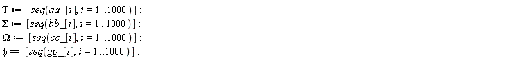

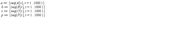

a := [seq(A[i], i = 1 .. 1000)]:

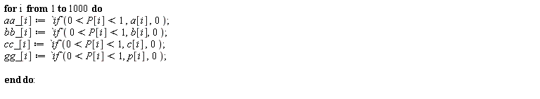

for i to 1000 do aa_[i] := `if`(0 < P[i] and P[i] < 1, a[i], 0); bb_[i] := `if`(0 < P[i] and P[i] < 1, b[i], 0); cc_[i] := `if`(0 < P[i] and P[i] < 1, c[i], 0); gg_[i] := `if`(0 < P[i] and P[i] < 1, p[i], 0) end do:
Tau := [seq(aa_[i], i = 1 .. 1000)]:

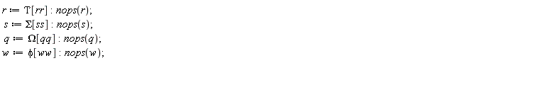

rr := [seq(`if`(Tau[i] = 0, NULL, i), i = 1 .. 1000)]:
r := Tau[rr]:
