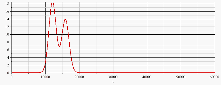

g := proc (t) options operator, arrow; 20*exp(-(1/2000000)*(t-10000)^2)+15*exp(-(1/2000000)*(t-13800)^2) end proc:
plot(g(t), t = 0 .. 60000)

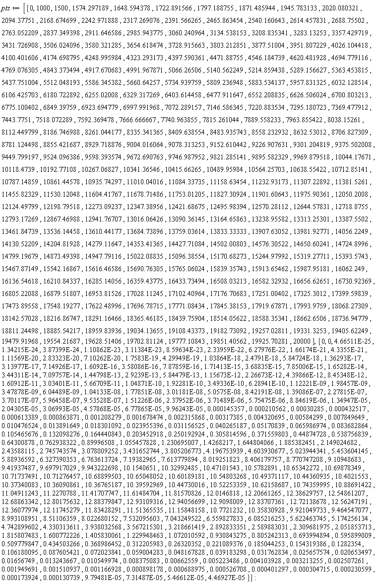

Typesetting:-mrow(Typesetting:-mi("pts", italic = "true", mathvariant = "italic"), Typesetting:-mo("≔", mathvariant = "normal", fence = "false", separator = "false", stretchy = "false", symmetric = "false", largeop = "false", movablelimits = "false", accent = "false", lspace = "0.2777778em", rspace = "0.2777778em"), Typesetting:-mfenced(Typesetting:-mrow(Typesetting:-mfenced(Typesetting:-mrow(Typesetting:-mi(""), Typesetting:-mtable(Typesetting:-mtr(Typesetting:-mtd(Typesetting:-mrow(Typesetting:-mn("0", executable = "false", mathvariant = "normal")), rowalign = "", columnalign = "", groupalign = "", rowspan = "1", columnspan = "1"), Typesetting:-mtd(Typesetting:-mrow(Typesetting:-mn("1000", executable = "false", mathvariant = "normal")), rowalign = "", columnalign = "", groupalign = "", rowspan = "1", columnspan = "1"), Typesetting:-mtd(Typesetting:-mrow(Typesetting:-mn("1500", executable = "false", mathvariant = "normal")), rowalign = "", columnalign = "", groupalign = "", rowspan = "1", columnspan = "1"), Typesetting:-mtd(Typesetting:-mrow(Typesetting:-mn("1574.297189", executable = "false", mathvariant = "normal")), rowalign = "", columnalign = "", groupalign = "", rowspan = "1", columnspan = "1"), Typesetting:-mtd(Typesetting:-mrow(Typesetting:-mn("1648.594378", executable = "false", mathvariant = "normal")), rowalign = "", columnalign = "", groupalign = "", rowspan = "1", columnspan = "1"), Typesetting:-mtd(Typesetting:-mrow(Typesetting:-mn("1722.891566", executable = "false", mathvariant = "normal")), rowalign = "", columnalign = "", groupalign = "", rowspan = "1", columnspan = "1"), Typesetting:-mtd(Typesetting:-mrow(Typesetting:-mn("1797.188755", executable = "false", mathvariant = "normal")), rowalign = "", columnalign = "", groupalign = "", rowspan = "1", columnspan = "1"), Typesetting:-mtd(Typesetting:-mrow(Typesetting:-mn("1871.485944", executable = "false", mathvariant = "normal")), rowalign = "", columnalign = "", groupalign = "", rowspan = "1", columnspan = "1"), Typesetting:-mtd(Typesetting:-mrow(Typesetting:-mn("1945.783133", executable = "false", mathvariant = "normal")), rowalign = "", columnalign = "", groupalign = "", rowspan = "1", columnspan = "1"), Typesetting:-mtd(Typesetting:-mrow(Typesetting:-mn("2020.080321", executable = "false", mathvariant = "normal")), rowalign = "", columnalign = "", groupalign = "", rowspan = "1", columnspan = "1"), Typesetting:-mtd(Typesetting:-mrow(Typesetting:-mn("2094.37751", executable = "false", mathvariant = "normal")), rowalign = "", columnalign = "", groupalign = "", rowspan = "1", columnspan = "1"), Typesetting:-mtd(Typesetting:-mrow(Typesetting:-mn("2168.674699", executable = "false", mathvariant = "normal")), rowalign = "", columnalign = "", groupalign = "", rowspan = "1", columnspan = "1"), Typesetting:-mtd(Typesetting:-mrow(Typesetting:-mn("2242.971888", executable = "false", mathvariant = "normal")), rowalign = "", columnalign = "", groupalign = "", rowspan = "1", columnspan = "1"), Typesetting:-mtd(Typesetting:-mrow(Typesetting:-mn("2317.269076", executable = "false", mathvariant = "normal")), rowalign = "", columnalign = "", groupalign = "", rowspan = "1", columnspan = "1"), Typesetting:-mtd(Typesetting:-mrow(Typesetting:-mn("2391.566265", executable = "false", mathvariant = "normal")), rowalign = "", columnalign = "", groupalign = "", rowspan = "1", columnspan = "1"), Typesetting:-mtd(Typesetting:-mrow(Typesetting:-mn("2465.863454", executable = "false", mathvariant = "normal")), rowalign = "", columnalign = "", groupalign = "", rowspan = "1", columnspan = "1"), Typesetting:-mtd(Typesetting:-mrow(Typesetting:-mn("2540.160643", executable = "false", mathvariant = "normal")), rowalign = "", columnalign = "", groupalign = "", rowspan = "1", columnspan = "1"), Typesetting:-mtd(Typesetting:-mrow(Typesetting:-mn("2614.457831", executable = "false", mathvariant = "normal")), rowalign = "", columnalign = "", groupalign = "", rowspan = "1", columnspan = "1"), Typesetting:-mtd(Typesetting:-mrow(Typesetting:-mn("2688.75502", executable = "false", mathvariant = "normal")), rowalign = "", columnalign = "", groupalign = "", rowspan = "1", columnspan = "1"), Typesetting:-mtd(Typesetting:-mrow(Typesetting:-mn("2763.052209", executable = "false", mathvariant = "normal")), rowalign = "", columnalign = "", groupalign = "", rowspan = "1", columnspan = "1"), Typesetting:-mtd(Typesetting:-mrow(Typesetting:-mn("2837.349398", executable = "false", mathvariant = "normal")), rowalign = "", columnalign = "", groupalign = "", rowspan = "1", columnspan = "1"), Typesetting:-mtd(Typesetting:-mrow(Typesetting:-mn("2911.646586", executable = "false", mathvariant = "normal")), rowalign = "", columnalign = "", groupalign = "", rowspan = "1", columnspan = "1"), Typesetting:-mtd(Typesetting:-mrow(Typesetting:-mn("2985.943775", executable = "false", mathvariant = "normal")), rowalign = "", columnalign = "", groupalign = "", rowspan = "1", columnspan = "1"), Typesetting:-mtd(Typesetting:-mrow(Typesetting:-mn("3060.240964", executable = "false", mathvariant = "normal")), rowalign = "", columnalign = "", groupalign = "", rowspan = "1", columnspan = "1"), Typesetting:-mtd(Typesetting:-mrow(Typesetting:-mn("3134.538153", executable = "false", mathvariant = "normal")), rowalign = "", columnalign = "", groupalign = "", rowspan = "1", columnspan = "1"), Typesetting:-mtd(Typesetting:-mrow(Typesetting:-mn("3208.835341", executable = "false", mathvariant = "normal")), rowalign = "", columnalign = "", groupalign = "", rowspan = "1", columnspan = "1"), Typesetting:-mtd(Typesetting:-mrow(Typesetting:-mn("3283.13253", executable = "false", mathvariant = "normal")), rowalign = "", columnalign = "", groupalign = "", rowspan = "1", columnspan = "1"), Typesetting:-mtd(Typesetting:-mrow(Typesetting:-mn("3357.429719", executable = "false", mathvariant = "normal")), rowalign = "", columnalign = "", groupalign = "", rowspan = "1", columnspan = "1"), Typesetting:-mtd(Typesetting:-mrow(Typesetting:-mn("3431.726908", executable = "false", mathvariant = "normal")), rowalign = "", columnalign = "", groupalign = "", rowspan = "1", columnspan = "1"), Typesetting:-mtd(Typesetting:-mrow(Typesetting:-mn("3506.024096", executable = "false", mathvariant = "normal")), rowalign = "", columnalign = "", groupalign = "", rowspan = "1", columnspan = "1"), Typesetting:-mtd(Typesetting:-mrow(Typesetting:-mn("3580.321285", executable = "false", mathvariant = "normal")), rowalign = "", columnalign = "", groupalign = "", rowspan = "1", columnspan = "1"), Typesetting:-mtd(Typesetting:-mrow(Typesetting:-mn("3654.618474", executable = "false", mathvariant = "normal")), rowalign = "", columnalign = "", groupalign = "", rowspan = "1", columnspan = "1"), Typesetting:-mtd(Typesetting:-mrow(Typesetting:-mn("3728.915663", executable = "false", mathvariant = "normal")), rowalign = "", columnalign = "", groupalign = "", rowspan = "1", columnspan = "1"), Typesetting:-mtd(Typesetting:-mrow(Typesetting:-mn("3803.212851", executable = "false", mathvariant = "normal")), rowalign = "", columnalign = "", groupalign = "", rowspan = "1", columnspan = "1"), Typesetting:-mtd(Typesetting:-mrow(Typesetting:-mn("3877.51004", executable = "false", mathvariant = "normal")), rowalign = "", columnalign = "", groupalign = "", rowspan = "1", columnspan = "1"), Typesetting:-mtd(Typesetting:-mrow(Typesetting:-mn("3951.807229", executable = "false", mathvariant = "normal")), rowalign = "", columnalign = "", groupalign = "", rowspan = "1", columnspan = "1"), Typesetting:-mtd(Typesetting:-mrow(Typesetting:-mn("4026.104418", executable = "false", mathvariant = "normal")), rowalign = "", columnalign = "", groupalign = "", rowspan = "1", columnspan = "1"), Typesetting:-mtd(Typesetting:-mrow(Typesetting:-mn("4100.401606", executable = "false", mathvariant = "normal")), rowalign = "", columnalign = "", groupalign = "", rowspan = "1", columnspan = "1"), Typesetting:-mtd(Typesetting:-mrow(Typesetting:-mn("4174.698795", executable = "false", mathvariant = "normal")), rowalign = "", columnalign = "", groupalign = "", rowspan = "1", columnspan = "1"), Typesetting:-mtd(Typesetting:-mrow(Typesetting:-mn("4248.995984", executable = "false", mathvariant = "normal")), rowalign = "", columnalign = "", groupalign = "", rowspan = "1", columnspan = "1"), Typesetting:-mtd(Typesetting:-mrow(Typesetting:-mn("4323.293173", executable = "false", mathvariant = "normal")), rowalign = "", columnalign = "", groupalign = "", rowspan = "1", columnspan = "1"), Typesetting:-mtd(Typesetting:-mrow(Typesetting:-mn("4397.590361", executable = "false", mathvariant = "normal")), rowalign = "", columnalign = "", groupalign = "", rowspan = "1", columnspan = "1"), Typesetting:-mtd(Typesetting:-mrow(Typesetting:-mn("4471.88755", executable = "false", mathvariant = "normal")), rowalign = "", columnalign = "", groupalign = "", rowspan = "1", columnspan = "1"), Typesetting:-mtd(Typesetting:-mrow(Typesetting:-mn("4546.184739", executable = "false", mathvariant = "normal")), rowalign = "", columnalign = "", groupalign = "", rowspan = "1", columnspan = "1"), Typesetting:-mtd(Typesetting:-mrow(Typesetting:-mn("4620.481928", executable = "false", mathvariant = "normal")), rowalign = "", columnalign = "", groupalign = "", rowspan = "1", columnspan = "1"), Typesetting:-mtd(Typesetting:-mrow(Typesetting:-mn("4694.779116", executable = "false", mathvariant = "normal")), rowalign = "", columnalign = "", groupalign = "", rowspan = "1", columnspan = "1"), Typesetting:-mtd(Typesetting:-mrow(Typesetting:-mn("4769.076305", executable = "false", mathvariant = "normal")), rowalign = "", columnalign = "", groupalign = "", rowspan = "1", columnspan = "1"), Typesetting:-mtd(Typesetting:-mrow(Typesetting:-mn("4843.373494", executable = "false", mathvariant = "normal")), rowalign = "", columnalign = "", groupalign = "", rowspan = "1", columnspan = "1"), Typesetting:-mtd(Typesetting:-mrow(Typesetting:-mn("4917.670683", executable = "false", mathvariant = "normal")), rowalign = "", columnalign = "", groupalign = "", rowspan = "1", columnspan = "1"), Typesetting:-mtd(Typesetting:-mrow(Typesetting:-mn("4991.967871", executable = "false", mathvariant = "normal")), rowalign = "", columnalign = "", groupalign = "", rowspan = "1", columnspan = "1"), Typesetting:-mtd(Typesetting:-mrow(Typesetting:-mn("5066.26506", executable = "false", mathvariant = "normal")), rowalign = "", columnalign = "", groupalign = "", rowspan = "1", columnspan = "1"), Typesetting:-mtd(Typesetting:-mrow(Typesetting:-mn("5140.562249", executable = "false", mathvariant = "normal")), rowalign = "", columnalign = "", groupalign = "", rowspan = "1", columnspan = "1"), Typesetting:-mtd(Typesetting:-mrow(Typesetting:-mn("5214.859438", executable = "false", mathvariant = "normal")), rowalign = "", columnalign = "", groupalign = "", rowspan = "1", columnspan = "1"), Typesetting:-mtd(Typesetting:-mrow(Typesetting:-mn("5289.156627", executable = "false", mathvariant = "normal")), rowalign = "", columnalign = "", groupalign = "", rowspan = "1", columnspan = "1"), Typesetting:-mtd(Typesetting:-mrow(Typesetting:-mn("5363.453815", executable = "false", mathvariant = "normal")), rowalign = "", columnalign = "", groupalign = "", rowspan = "1", columnspan = "1"), Typesetting:-mtd(Typesetting:-mrow(Typesetting:-mn("5437.751004", executable = "false", mathvariant = "normal")), rowalign = "", columnalign = "", groupalign = "", rowspan = "1", columnspan = "1"), Typesetting:-mtd(Typesetting:-mrow(Typesetting:-mn("5512.048193", executable = "false", mathvariant = "normal")), rowalign = "", columnalign = "", groupalign = "", rowspan = "1", columnspan = "1"), Typesetting:-mtd(Typesetting:-mrow(Typesetting:-mn("5586.345382", executable = "false", mathvariant = "normal")), rowalign = "", columnalign = "", groupalign = "", rowspan = "1", columnspan = "1"), Typesetting:-mtd(Typesetting:-mrow(Typesetting:-mn("5660.64257", executable = "false", mathvariant = "normal")), rowalign = "", columnalign = "", groupalign = "", rowspan = "1", columnspan = "1"), Typesetting:-mtd(Typesetting:-mrow(Typesetting:-mn("5734.939759", executable = "false", mathvariant = "normal")), rowalign = "", columnalign = "", groupalign = "", rowspan = "1", columnspan = "1"), Typesetting:-mtd(Typesetting:-mrow(Typesetting:-mn("5809.236948", executable = "false", mathvariant = "normal")), rowalign = "", columnalign = "", groupalign = "", rowspan = "1", columnspan = "1"), Typesetting:-mtd(Typesetting:-mrow(Typesetting:-mn("5883.534137", executable = "false", mathvariant = "normal")), rowalign = "", columnalign = "", groupalign = "", rowspan = "1", columnspan = "1"), Typesetting:-mtd(Typesetting:-mrow(Typesetting:-mn("5957.831325", executable = "false", mathvariant = "normal")), rowalign = "", columnalign = "", groupalign = "", rowspan = "1", columnspan = "1"), Typesetting:-mtd(Typesetting:-mrow(Typesetting:-mn("6032.128514", executable = "false", mathvariant = "normal")), rowalign = "", columnalign = "", groupalign = "", rowspan = "1", columnspan = "1"), Typesetting:-mtd(Typesetting:-mrow(Typesetting:-mn("6106.425703", executable = "false", mathvariant = "normal")), rowalign = "", columnalign = "", groupalign = "", rowspan = "1", columnspan = "1"), Typesetting:-mtd(Typesetting:-mrow(Typesetting:-mn("6180.722892", executable = "false", mathvariant = "normal")), rowalign = "", columnalign = "", groupalign = "", rowspan = "1", columnspan = "1"), Typesetting:-mtd(Typesetting:-mrow(Typesetting:-mn("6255.02008", executable = "false", mathvariant = "normal")), rowalign = "", columnalign = "", groupalign = "", rowspan = "1", columnspan = "1"), Typesetting:-mtd(Typesetting:-mrow(Typesetting:-mn("6329.317269", executable = "false", mathvariant = "normal")), rowalign = "", columnalign = "", groupalign = "", rowspan = "1", columnspan = "1"), Typesetting:-mtd(Typesetting:-mrow(Typesetting:-mn("6403.614458", executable = "false", mathvariant = "normal")), rowalign = "", columnalign = "", groupalign = "", rowspan = "1", columnspan = "1"), Typesetting:-mtd(Typesetting:-mrow(Typesetting:-mn("6477.911647", executable = "false", mathvariant = "normal")), rowalign = "", columnalign = "", groupalign = "", rowspan = "1", columnspan = "1"), Typesetting:-mtd(Typesetting:-mrow(Typesetting:-mn("6552.208835", executable = "false", mathvariant = "normal")), rowalign = "", columnalign = "", groupalign = "", rowspan = "1", columnspan = "1"), Typesetting:-mtd(Typesetting:-mrow(Typesetting:-mn("6626.506024", executable = "false", mathvariant = "normal")), rowalign = "", columnalign = "", groupalign = "", rowspan = "1", columnspan = "1"), Typesetting:-mtd(Typesetting:-mrow(Typesetting:-mn("6700.803213", executable = "false", mathvariant = "normal")), rowalign = "", columnalign = "", groupalign = "", rowspan = "1", columnspan = "1"), Typesetting:-mtd(Typesetting:-mrow(Typesetting:-mn("6775.100402", executable = "false", mathvariant = "normal")), rowalign = "", columnalign = "", groupalign = "", rowspan = "1", columnspan = "1"), Typesetting:-mtd(Typesetting:-mrow(Typesetting:-mn("6849.39759", executable = "false", mathvariant = "normal")), rowalign = "", columnalign = "", groupalign = "", rowspan = "1", columnspan = "1"), Typesetting:-mtd(Typesetting:-mrow(Typesetting:-mn("6923.694779", executable = "false", mathvariant = "normal")), rowalign = "", columnalign = "", groupalign = "", rowspan = "1", columnspan = "1"), Typesetting:-mtd(Typesetting:-mrow(Typesetting:-mn("6997.991968", executable = "false", mathvariant = "normal")), rowalign = "", columnalign = "", groupalign = "", rowspan = "1", columnspan = "1"), Typesetting:-mtd(Typesetting:-mrow(Typesetting:-mn("7072.289157", executable = "false", mathvariant = "normal")), rowalign = "", columnalign = "", groupalign = "", rowspan = "1", columnspan = "1"), Typesetting:-mtd(Typesetting:-mrow(Typesetting:-mn("7146.586345", executable = "false", mathvariant = "normal")), rowalign = "", columnalign = "", groupalign = "", rowspan = "1", columnspan = "1"), Typesetting:-mtd(Typesetting:-mrow(Typesetting:-mn("7220.883534", executable = "false", mathvariant = "normal")), rowalign = "", columnalign = "", groupalign = "", rowspan = "1", columnspan = "1"), Typesetting:-mtd(Typesetting:-mrow(Typesetting:-mn("7295.180723", executable = "false", mathvariant = "normal")), rowalign = "", columnalign = "", groupalign = "", rowspan = "1", columnspan = "1"), Typesetting:-mtd(Typesetting:-mrow(Typesetting:-mn("7369.477912", executable = "false", mathvariant = "normal")), rowalign = "", columnalign = "", groupalign = "", rowspan = "1", columnspan = "1"), Typesetting:-mtd(Typesetting:-mrow(Typesetting:-mn("7443.7751", executable = "false", mathvariant = "normal")), rowalign = "", columnalign = "", groupalign = "", rowspan = "1", columnspan = "1"), Typesetting:-mtd(Typesetting:-mrow(Typesetting:-mn("7518.072289", executable = "false", mathvariant = "normal")), rowalign = "", columnalign = "", groupalign = "", rowspan = "1", columnspan = "1"), Typesetting:-mtd(Typesetting:-mrow(Typesetting:-mn("7592.369478", executable = "false", mathvariant = "normal")), rowalign = "", columnalign = "", groupalign = "", rowspan = "1", columnspan = "1"), Typesetting:-mtd(Typesetting:-mrow(Typesetting:-mn("7666.666667", executable = "false", mathvariant = "normal")), rowalign = "", columnalign = "", groupalign = "", rowspan = "1", columnspan = "1"), Typesetting:-mtd(Typesetting:-mrow(Typesetting:-mn("7740.963855", executable = "false", mathvariant = "normal")), rowalign = "", columnalign = "", groupalign = "", rowspan = "1", columnspan = "1"), Typesetting:-mtd(Typesetting:-mrow(Typesetting:-mn("7815.261044", executable = "false", mathvariant = "normal")), rowalign = "", columnalign = "", groupalign = "", rowspan = "1", columnspan = "1"), Typesetting:-mtd(Typesetting:-mrow(Typesetting:-mn("7889.558233", executable = "false", mathvariant = "normal")), rowalign = "", columnalign = "", groupalign = "", rowspan = "1", columnspan = "1"), Typesetting:-mtd(Typesetting:-mrow(Typesetting:-mn("7963.855422", executable = "false", mathvariant = "normal")), rowalign = "", columnalign = "", groupalign = "", rowspan = "1", columnspan = "1"), Typesetting:-mtd(Typesetting:-mrow(Typesetting:-mn("8038.15261", executable = "false", mathvariant = "normal")), rowalign = "", columnalign = "", groupalign = "", rowspan = "1", columnspan = "1"), Typesetting:-mtd(Typesetting:-mrow(Typesetting:-mn("8112.449799", executable = "false", mathvariant = "normal")), rowalign = "", columnalign = "", groupalign = "", rowspan = "1", columnspan = "1"), Typesetting:-mtd(Typesetting:-mrow(Typesetting:-mn("8186.746988", executable = "false", mathvariant = "normal")), rowalign = "", columnalign = "", groupalign = "", rowspan = "1", columnspan = "1"), Typesetting:-mtd(Typesetting:-mrow(Typesetting:-mn("8261.044177", executable = "false", mathvariant = "normal")), rowalign = "", columnalign = "", groupalign = "", rowspan = "1", columnspan = "1"), Typesetting:-mtd(Typesetting:-mrow(Typesetting:-mn("8335.341365", executable = "false", mathvariant = "normal")), rowalign = "", columnalign = "", groupalign = "", rowspan = "1", columnspan = "1"), Typesetting:-mtd(Typesetting:-mrow(Typesetting:-mn("8409.638554", executable = "false", mathvariant = "normal")), rowalign = "", columnalign = "", groupalign = "", rowspan = "1", columnspan = "1"), Typesetting:-mtd(Typesetting:-mrow(Typesetting:-mn("8483.935743", executable = "false", mathvariant = "normal")), rowalign = "", columnalign = "", groupalign = "", rowspan = "1", columnspan = "1"), Typesetting:-mtd(Typesetting:-mrow(Typesetting:-mn("8558.232932", executable = "false", mathvariant = "normal")), rowalign = "", columnalign = "", groupalign = "", rowspan = "1", columnspan = "1"), Typesetting:-mtd(Typesetting:-mrow(Typesetting:-mn("8632.53012", executable = "false", mathvariant = "normal")), rowalign = "", columnalign = "", groupalign = "", rowspan = "1", columnspan = "1"), Typesetting:-mtd(Typesetting:-mrow(Typesetting:-mn("8706.827309", executable = "false", mathvariant = "normal")), rowalign = "", columnalign = "", groupalign = "", rowspan = "1", columnspan = "1"), Typesetting:-mtd(Typesetting:-mrow(Typesetting:-mn("8781.124498", executable = "false", mathvariant = "normal")), rowalign = "", columnalign = "", groupalign = "", rowspan = "1", columnspan = "1"), Typesetting:-mtd(Typesetting:-mrow(Typesetting:-mn("8855.421687", executable = "false", mathvariant = "normal")), rowalign = "", columnalign = "", groupalign = "", rowspan = "1", columnspan = "1"), Typesetting:-mtd(Typesetting:-mrow(Typesetting:-mn("8929.718876", executable = "false", mathvariant = "normal")), rowalign = "", columnalign = "", groupalign = "", rowspan = "1", columnspan = "1"), Typesetting:-mtd(Typesetting:-mrow(Typesetting:-mn("9004.016064", executable = "false", mathvariant = "normal")), rowalign = "", columnalign = "", groupalign = "", rowspan = "1", columnspan = "1"), Typesetting:-mtd(Typesetting:-mrow(Typesetting:-mn("9078.313253", executable = "false", mathvariant = "normal")), rowalign = "", columnalign = "", groupalign = "", rowspan = "1", columnspan = "1"), Typesetting:-mtd(Typesetting:-mrow(Typesetting:-mn("9152.610442", executable = "false", mathvariant = "normal")), rowalign = "", columnalign = "", groupalign = "", rowspan = "1", columnspan = "1"), Typesetting:-mtd(Typesetting:-mrow(Typesetting:-mn("9226.907631", executable = "false", mathvariant = "normal")), rowalign = "", columnalign = "", groupalign = "", rowspan = "1", columnspan = "1"), Typesetting:-mtd(Typesetting:-mrow(Typesetting:-mn("9301.204819", executable = "false", mathvariant = "normal")), rowalign = "", columnalign = "", groupalign = "", rowspan = "1", columnspan = "1"), Typesetting:-mtd(Typesetting:-mrow(Typesetting:-mn("9375.502008", executable = "false", mathvariant = "normal")), rowalign = "", columnalign = "", groupalign = "", rowspan = "1", columnspan = "1"), Typesetting:-mtd(Typesetting:-mrow(Typesetting:-mn("9449.799197", executable = "false", mathvariant = "normal")), rowalign = "", columnalign = "", groupalign = "", rowspan = "1", columnspan = "1"), Typesetting:-mtd(Typesetting:-mrow(Typesetting:-mn("9524.096386", executable = "false", mathvariant = "normal")), rowalign = "", columnalign = "", groupalign = "", rowspan = "1", columnspan = "1"), Typesetting:-mtd(Typesetting:-mrow(Typesetting:-mn("9598.393574", executable = "false", mathvariant = "normal")), rowalign = "", columnalign = "", groupalign = "", rowspan = "1", columnspan = "1"), Typesetting:-mtd(Typesetting:-mrow(Typesetting:-mn("9672.690763", executable = "false", mathvariant = "normal")), rowalign = "", columnalign = "", groupalign = "", rowspan = "1", columnspan = "1"), Typesetting:-mtd(Typesetting:-mrow(Typesetting:-mn("9746.987952", executable = "false", mathvariant = "normal")), rowalign = "", columnalign = "", groupalign = "", rowspan = "1", columnspan = "1"), Typesetting:-mtd(Typesetting:-mrow(Typesetting:-mn("9821.285141", executable = "false", mathvariant = "normal")), rowalign = "", columnalign = "", groupalign = "", rowspan = "1", columnspan = "1"), Typesetting:-mtd(Typesetting:-mrow(Typesetting:-mn("9895.582329", executable = "false", mathvariant = "normal")), rowalign = "", columnalign = "", groupalign = "", rowspan = "1", columnspan = "1"), Typesetting:-mtd(Typesetting:-mrow(Typesetting:-mn("9969.879518", executable = "false", mathvariant = "normal")), rowalign = "", columnalign = "", groupalign = "", rowspan = "1", columnspan = "1"), Typesetting:-mtd(Typesetting:-mrow(Typesetting:-mn("10044.17671", executable = "false", mathvariant = "normal")), rowalign = "", columnalign = "", groupalign = "", rowspan = "1", columnspan = "1"), Typesetting:-mtd(Typesetting:-mrow(Typesetting:-mn("10118.4739", executable = "false", mathvariant = "normal")), rowalign = "", columnalign = "", groupalign = "", rowspan = "1", columnspan = "1"), Typesetting:-mtd(Typesetting:-mrow(Typesetting:-mn("10192.77108", executable = "false", mathvariant = "normal")), rowalign = "", columnalign = "", groupalign = "", rowspan = "1", columnspan = "1"), Typesetting:-mtd(Typesetting:-mrow(Typesetting:-mn("10267.06827", executable = "false", mathvariant = "normal")), rowalign = "", columnalign = "", groupalign = "", rowspan = "1", columnspan = "1"), Typesetting:-mtd(Typesetting:-mrow(Typesetting:-mn("10341.36546", executable = "false", mathvariant = "normal")), rowalign = "", columnalign = "", groupalign = "", rowspan = "1", columnspan = "1"), Typesetting:-mtd(Typesetting:-mrow(Typesetting:-mn("10415.66265", executable = "false", mathvariant = "normal")), rowalign = "", columnalign = "", groupalign = "", rowspan = "1", columnspan = "1"), Typesetting:-mtd(Typesetting:-mrow(Typesetting:-mn("10489.95984", executable = "false", mathvariant = "normal")), rowalign = "", columnalign = "", groupalign = "", rowspan = "1", columnspan = "1"), Typesetting:-mtd(Typesetting:-mrow(Typesetting:-mn("10564.25703", executable = "false", mathvariant = "normal")), rowalign = "", columnalign = "", groupalign = "", rowspan = "1", columnspan = "1"), Typesetting:-mtd(Typesetting:-mrow(Typesetting:-mn("10638.55422", executable = "false", mathvariant = "normal")), rowalign = "", columnalign = "", groupalign = "", rowspan = "1", columnspan = "1"), Typesetting:-mtd(Typesetting:-mrow(Typesetting:-mn("10712.85141", executable = "false", mathvariant = "normal")), rowalign = "", columnalign = "", groupalign = "", rowspan = "1", columnspan = "1"), Typesetting:-mtd(Typesetting:-mrow(Typesetting:-mn("10787.14859", executable = "false", mathvariant = "normal")), rowalign = "", columnalign = "", groupalign = "", rowspan = "1", columnspan = "1"), Typesetting:-mtd(Typesetting:-mrow(Typesetting:-mn("10861.44578", executable = "false", mathvariant = "normal")), rowalign = "", columnalign = "", groupalign = "", rowspan = "1", columnspan = "1"), Typesetting:-mtd(Typesetting:-mrow(Typesetting:-mn("10935.74297", executable = "false", mathvariant = "normal")), rowalign = "", columnalign = "", groupalign = "", rowspan = "1", columnspan = "1"), Typesetting:-mtd(Typesetting:-mrow(Typesetting:-mn("11010.04016", executable = "false", mathvariant = "normal")), rowalign = "", columnalign = "", groupalign = "", rowspan = "1", columnspan = "1"), Typesetting:-mtd(Typesetting:-mrow(Typesetting:-mn("11084.33735", executable = "false", mathvariant = "normal")), rowalign = "", columnalign = "", groupalign = "", rowspan = "1", columnspan = "1"), Typesetting:-mtd(Typesetting:-mrow(Typesetting:-mn("11158.63454", executable = "false", mathvariant = "normal")), rowalign = "", columnalign = "", groupalign = "", rowspan = "1", columnspan = "1"), Typesetting:-mtd(Typesetting:-mrow(Typesetting:-mn("11232.93173", executable = "false", mathvariant = "normal")), rowalign = "", columnalign = "", groupalign = "", rowspan = "1", columnspan = "1"), Typesetting:-mtd(Typesetting:-mrow(Typesetting:-mn("11307.22892", executable = "false", mathvariant = "normal")), rowalign = "", columnalign = "", groupalign = "", rowspan = "1", columnspan = "1"), Typesetting:-mtd(Typesetting:-mrow(Typesetting:-mn("11381.5261", executable = "false", mathvariant = "normal")), rowalign = "", columnalign = "", groupalign = "", rowspan = "1", columnspan = "1"), Typesetting:-mtd(Typesetting:-mrow(Typesetting:-mn("11455.82329", executable = "false", mathvariant = "normal")), rowalign = "", columnalign = "", groupalign = "", rowspan = "1", columnspan = "1"), Typesetting:-mtd(Typesetting:-mrow(Typesetting:-mn("11530.12048", executable = "false", mathvariant = "normal")), rowalign = "", columnalign = "", groupalign = "", rowspan = "1", columnspan = "1"), Typesetting:-mtd(Typesetting:-mrow(Typesetting:-mn("11604.41767", executable = "false", mathvariant = "normal")), rowalign = "", columnalign = "", groupalign = "", rowspan = "1", columnspan = "1"), Typesetting:-mtd(Typesetting:-mrow(Typesetting:-mn("11678.71486", executable = "false", mathvariant = "normal")), rowalign = "", columnalign = "", groupalign = "", rowspan = "1", columnspan = "1"), Typesetting:-mtd(Typesetting:-mrow(Typesetting:-mn("11753.01205", executable = "false", mathvariant = "normal")), rowalign = "", columnalign = "", groupalign = "", rowspan = "1", columnspan = "1"), Typesetting:-mtd(Typesetting:-mrow(Typesetting:-mn("11827.30924", executable = "false", mathvariant = "normal")), rowalign = "", columnalign = "", groupalign = "", rowspan = "1", columnspan = "1"), Typesetting:-mtd(Typesetting:-mrow(Typesetting:-mn("11901.60643", executable = "false", mathvariant = "normal")), rowalign = "", columnalign = "", groupalign = "", rowspan = "1", columnspan = "1"), Typesetting:-mtd(Typesetting:-mrow(Typesetting:-mn("11975.90361", executable = "false", mathvariant = "normal")), rowalign = "", columnalign = "", groupalign = "", rowspan = "1", columnspan = "1"), Typesetting:-mtd(Typesetting:-mrow(Typesetting:-mn("12050.2008", executable = "false", mathvariant = "normal")), rowalign = "", columnalign = "", groupalign = "", rowspan = "1", columnspan = "1"), Typesetting:-mtd(Typesetting:-mrow(Typesetting:-mn("12124.49799", executable = "false", mathvariant = "normal")), rowalign = "", columnalign = "", groupalign = "", rowspan = "1", columnspan = "1"), Typesetting:-mtd(Typesetting:-mrow(Typesetting:-mn("12198.79518", executable = "false", mathvariant = "normal")), rowalign = "", columnalign = "", groupalign = "", rowspan = "1", columnspan = "1"), Typesetting:-mtd(Typesetting:-mrow(Typesetting:-mn("12273.09237", executable = "false", mathvariant = "normal")), rowalign = "", columnalign = "", groupalign = "", rowspan = "1", columnspan = "1"), Typesetting:-mtd(Typesetting:-mrow(Typesetting:-mn("12347.38956", executable = "false", mathvariant = "normal")), rowalign = "", columnalign = "", groupalign = "", rowspan = "1", columnspan = "1"), Typesetting:-mtd(Typesetting:-mrow(Typesetting:-mn("12421.68675", executable = "false", mathvariant = "normal")), rowalign = "", columnalign = "", groupalign = "", rowspan = "1", columnspan = "1"), Typesetting:-mtd(Typesetting:-mrow(Typesetting:-mn("12495.98394", executable = "false", mathvariant = "normal")), rowalign = "", columnalign = "", groupalign = "", rowspan = "1", columnspan = "1"), Typesetting:-mtd(Typesetting:-mrow(Typesetting:-mn("12570.28112", executable = "false", mathvariant = "normal")), rowalign = "", columnalign = "", groupalign = "", rowspan = "1", columnspan = "1"), Typesetting:-mtd(Typesetting:-mrow(Typesetting:-mn("12644.57831", executable = "false", mathvariant = "normal")), rowalign = "", columnalign = "", groupalign = "", rowspan = "1", columnspan = "1"), Typesetting:-mtd(Typesetting:-mrow(Typesetting:-mn("12718.8755", executable = "false", mathvariant = "normal")), rowalign = "", columnalign = "", groupalign = "", rowspan = "1", columnspan = "1"), Typesetting:-mtd(Typesetting:-mrow(Typesetting:-mn("12793.17269", executable = "false", mathvariant = "normal")), rowalign = "", columnalign = "", groupalign = "", rowspan = "1", columnspan = "1"), Typesetting:-mtd(Typesetting:-mrow(Typesetting:-mn("12867.46988", executable = "false", mathvariant = "normal")), rowalign = "", columnalign = "", groupalign = "", rowspan = "1", columnspan = "1"), Typesetting:-mtd(Typesetting:-mrow(Typesetting:-mn("12941.76707", executable = "false", mathvariant = "normal")), rowalign = "", columnalign = "", groupalign = "", rowspan = "1", columnspan = "1"), Typesetting:-mtd(Typesetting:-mrow(Typesetting:-mn("13016.06426", executable = "false", mathvariant = "normal")), rowalign = "", columnalign = "", groupalign = "", rowspan = "1", columnspan = "1"), Typesetting:-mtd(Typesetting:-mrow(Typesetting:-mn("13090.36145", executable = "false", mathvariant = "normal")), rowalign = "", columnalign = "", groupalign = "", rowspan = "1", columnspan = "1"), Typesetting:-mtd(Typesetting:-mrow(Typesetting:-mn("13164.65863", executable = "false", mathvariant = "normal")), rowalign = "", columnalign = "", groupalign = "", rowspan = "1", columnspan = "1"), Typesetting:-mtd(Typesetting:-mrow(Typesetting:-mn("13238.95582", executable = "false", mathvariant = "normal")), rowalign = "", columnalign = "", groupalign = "", rowspan = "1", columnspan = "1"), Typesetting:-mtd(Typesetting:-mrow(Typesetting:-mn("13313.25301", executable = "false", mathvariant = "normal")), rowalign = "", columnalign = "", groupalign = "", rowspan = "1", columnspan = "1"), Typesetting:-mtd(Typesetting:-mrow(Typesetting:-mn("13387.5502", executable = "false", mathvariant = "normal")), rowalign = "", columnalign = "", groupalign = "", rowspan = "1", columnspan = "1"), Typesetting:-mtd(Typesetting:-mrow(Typesetting:-mn("13461.84739", executable = "false", mathvariant = "normal")), rowalign = "", columnalign = "", groupalign = "", rowspan = "1", columnspan = "1"), Typesetting:-mtd(Typesetting:-mrow(Typesetting:-mn("13536.14458", executable = "false", mathvariant = "normal")), rowalign = "", columnalign = "", groupalign = "", rowspan = "1", columnspan = "1"), Typesetting:-mtd(Typesetting:-mrow(Typesetting:-mn("13610.44177", executable = "false", mathvariant = "normal")), rowalign = "", columnalign = "", groupalign = "", rowspan = "1", columnspan = "1"), Typesetting:-mtd(Typesetting:-mrow(Typesetting:-mn("13684.73896", executable = "false", mathvariant = "normal")), rowalign = "", columnalign = "", groupalign = "", rowspan = "1", columnspan = "1"), Typesetting:-mtd(Typesetting:-mrow(Typesetting:-mn("13759.03614", executable = "false", mathvariant = "normal")), rowalign = "", columnalign = "", groupalign = "", rowspan = "1", columnspan = "1"), Typesetting:-mtd(Typesetting:-mrow(Typesetting:-mn("13833.33333", executable = "false", mathvariant = "normal")), rowalign = "", columnalign = "", groupalign = "", rowspan = "1", columnspan = "1"), Typesetting:-mtd(Typesetting:-mrow(Typesetting:-mn("13907.63052", executable = "false", mathvariant = "normal")), rowalign = "", columnalign = "", groupalign = "", rowspan = "1", columnspan = "1"), Typesetting:-mtd(Typesetting:-mrow(Typesetting:-mn("13981.92771", executable = "false", mathvariant = "normal")), rowalign = "", columnalign = "", groupalign = "", rowspan = "1", columnspan = "1"), Typesetting:-mtd(Typesetting:-mrow(Typesetting:-mn("14056.2249", executable = "false", mathvariant = "normal")), rowalign = "", columnalign = "", groupalign = "", rowspan = "1", columnspan = "1"), Typesetting:-mtd(Typesetting:-mrow(Typesetting:-mn("14130.52209", executable = "false", mathvariant = "normal")), rowalign = "", columnalign = "", groupalign = "", rowspan = "1", columnspan = "1"), Typesetting:-mtd(Typesetting:-mrow(Typesetting:-mn("14204.81928", executable = "false", mathvariant = "normal")), rowalign = "", columnalign = "", groupalign = "", rowspan = "1", columnspan = "1"), Typesetting:-mtd(Typesetting:-mrow(Typesetting:-mn("14279.11647", executable = "false", mathvariant = "normal")), rowalign = "", columnalign = "", groupalign = "", rowspan = "1", columnspan = "1"), Typesetting:-mtd(Typesetting:-mrow(Typesetting:-mn("14353.41365", executable = "false", mathvariant = "normal")), rowalign = "", columnalign = "", groupalign = "", rowspan = "1", columnspan = "1"), Typesetting:-mtd(Typesetting:-mrow(Typesetting:-mn("14427.71084", executable = "false", mathvariant = "normal")), rowalign = "", columnalign = "", groupalign = "", rowspan = "1", columnspan = "1"), Typesetting:-mtd(Typesetting:-mrow(Typesetting:-mn("14502.00803", executable = "false", mathvariant = "normal")), rowalign = "", columnalign = "", groupalign = "", rowspan = "1", columnspan = "1"), Typesetting:-mtd(Typesetting:-mrow(Typesetting:-mn("14576.30522", executable = "false", mathvariant = "normal")), rowalign = "", columnalign = "", groupalign = "", rowspan = "1", columnspan = "1"), Typesetting:-mtd(Typesetting:-mrow(Typesetting:-mn("14650.60241", executable = "false", mathvariant = "normal")), rowalign = "", columnalign = "", groupalign = "", rowspan = "1", columnspan = "1"), Typesetting:-mtd(Typesetting:-mrow(Typesetting:-mn("14724.8996", executable = "false", mathvariant = "normal")), rowalign = "", columnalign = "", groupalign = "", rowspan = "1", columnspan = "1"), Typesetting:-mtd(Typesetting:-mrow(Typesetting:-mn("14799.19679", executable = "false", mathvariant = "normal")), rowalign = "", columnalign = "", groupalign = "", rowspan = "1", columnspan = "1"), Typesetting:-mtd(Typesetting:-mrow(Typesetting:-mn("14873.49398", executable = "false", mathvariant = "normal")), rowalign = "", columnalign = "", groupalign = "", rowspan = "1", columnspan = "1"), Typesetting:-mtd(Typesetting:-mrow(Typesetting:-mn("14947.79116", executable = "false", mathvariant = "normal")), rowalign = "", columnalign = "", groupalign = "", rowspan = "1", columnspan = "1"), Typesetting:-mtd(Typesetting:-mrow(Typesetting:-mn("15022.08835", executable = "false", mathvariant = "normal")), rowalign = "", columnalign = "", groupalign = "", rowspan = "1", columnspan = "1"), Typesetting:-mtd(Typesetting:-mrow(Typesetting:-mn("15096.38554", executable = "false", mathvariant = "normal")), rowalign = "", columnalign = "", groupalign = "", rowspan = "1", columnspan = "1"), Typesetting:-mtd(Typesetting:-mrow(Typesetting:-mn("15170.68273", executable = "false", mathvariant = "normal")), rowalign = "", columnalign = "", groupalign = "", rowspan = "1", columnspan = "1"), Typesetting:-mtd(Typesetting:-mrow(Typesetting:-mn("15244.97992", executable = "false", mathvariant = "normal")), rowalign = "", columnalign = "", groupalign = "", rowspan = "1", columnspan = "1"), Typesetting:-mtd(Typesetting:-mrow(Typesetting:-mn("15319.27711", executable = "false", mathvariant = "normal")), rowalign = "", columnalign = "", groupalign = "", rowspan = "1", columnspan = "1"), Typesetting:-mtd(Typesetting:-mrow(Typesetting:-mn("15393.5743", executable = "false", mathvariant = "normal")), rowalign = "", columnalign = "", groupalign = "", rowspan = "1", columnspan = "1"), Typesetting:-mtd(Typesetting:-mrow(Typesetting:-mn("15467.87149", executable = "false", mathvariant = "normal")), rowalign = "", columnalign = "", groupalign = "", rowspan = "1", columnspan = "1"), Typesetting:-mtd(Typesetting:-mrow(Typesetting:-mn("15542.16867", executable = "false", mathvariant = "normal")), rowalign = "", columnalign = "", groupalign = "", rowspan = "1", columnspan = "1"), Typesetting:-mtd(Typesetting:-mrow(Typesetting:-mn("15616.46586", executable = "false", mathvariant = "normal")), rowalign = "", columnalign = "", groupalign = "", rowspan = "1", columnspan = "1"), Typesetting:-mtd(Typesetting:-mrow(Typesetting:-mn("15690.76305", executable = "false", mathvariant = "normal")), rowalign = "", columnalign = "", groupalign = "", rowspan = "1", columnspan = "1"), Typesetting:-mtd(Typesetting:-mrow(Typesetting:-mn("15765.06024", executable = "false", mathvariant = "normal")), rowalign = "", columnalign = "", groupalign = "", rowspan = "1", columnspan = "1"), Typesetting:-mtd(Typesetting:-mrow(Typesetting:-mn("15839.35743", executable = "false", mathvariant = "normal")), rowalign = "", columnalign = "", groupalign = "", rowspan = "1", columnspan = "1"), Typesetting:-mtd(Typesetting:-mrow(Typesetting:-mn("15913.65462", executable = "false", mathvariant = "normal")), rowalign = "", columnalign = "", groupalign = "", rowspan = "1", columnspan = "1"), Typesetting:-mtd(Typesetting:-mrow(Typesetting:-mn("15987.95181", executable = "false", mathvariant = "normal")), rowalign = "", columnalign = "", groupalign = "", rowspan = "1", columnspan = "1"), Typesetting:-mtd(Typesetting:-mrow(Typesetting:-mn("16062.249", executable = "false", mathvariant = "normal")), rowalign = "", columnalign = "", groupalign = "", rowspan = "1", columnspan = "1"), Typesetting:-mtd(Typesetting:-mrow(Typesetting:-mn("16136.54618", executable = "false", mathvariant = "normal")), rowalign = "", columnalign = "", groupalign = "", rowspan = "1", columnspan = "1"), Typesetting:-mtd(Typesetting:-mrow(Typesetting:-mn("16210.84337", executable = "false", mathvariant = "normal")), rowalign = "", columnalign = "", groupalign = "", rowspan = "1", columnspan = "1"), Typesetting:-mtd(Typesetting:-mrow(Typesetting:-mn("16285.14056", executable = "false", mathvariant = "normal")), rowalign = "", columnalign = "", groupalign = "", rowspan = "1", columnspan = "1"), Typesetting:-mtd(Typesetting:-mrow(Typesetting:-mn("16359.43775", executable = "false", mathvariant = "normal")), rowalign = "", columnalign = "", groupalign = "", rowspan = "1", columnspan = "1"), Typesetting:-mtd(Typesetting:-mrow(Typesetting:-mn("16433.73494", executable = "false", mathvariant = "normal")), rowalign = "", columnalign = "", groupalign = "", rowspan = "1", columnspan = "1"), Typesetting:-mtd(Typesetting:-mrow(Typesetting:-mn("16508.03213", executable = "false", mathvariant = "normal")), rowalign = "", columnalign = "", groupalign = "", rowspan = "1", columnspan = "1"), Typesetting:-mtd(Typesetting:-mrow(Typesetting:-mn("16582.32932", executable = "false", mathvariant = "normal")), rowalign = "", columnalign = "", groupalign = "", rowspan = "1", columnspan = "1"), Typesetting:-mtd(Typesetting:-mrow(Typesetting:-mn("16656.62651", executable = "false", mathvariant = "normal")), rowalign = "", columnalign = "", groupalign = "", rowspan = "1", columnspan = "1"), Typesetting:-mtd(Typesetting:-mrow(Typesetting:-mn("16730.92369", executable = "false", mathvariant = "normal")), rowalign = "", columnalign = "", groupalign = "", rowspan = "1", columnspan = "1"), Typesetting:-mtd(Typesetting:-mrow(Typesetting:-mn("16805.22088", executable = "false", mathvariant = "normal")), rowalign = "", columnalign = "", groupalign = "", rowspan = "1", columnspan = "1"), Typesetting:-mtd(Typesetting:-mrow(Typesetting:-mn("16879.51807", executable = "false", mathvariant = "normal")), rowalign = "", columnalign = "", groupalign = "", rowspan = "1", columnspan = "1"), Typesetting:-mtd(Typesetting:-mrow(Typesetting:-mn("16953.81526", executable = "false", mathvariant = "normal")), rowalign = "", columnalign = "", groupalign = "", rowspan = "1", columnspan = "1"), Typesetting:-mtd(Typesetting:-mrow(Typesetting:-mn("17028.11245", executable = "false", mathvariant = "normal")), rowalign = "", columnalign = "", groupalign = "", rowspan = "1", columnspan = "1"), Typesetting:-mtd(Typesetting:-mrow(Typesetting:-mn("17102.40964", executable = "false", mathvariant = "normal")), rowalign = "", columnalign = "", groupalign = "", rowspan = "1", columnspan = "1"), Typesetting:-mtd(Typesetting:-mrow(Typesetting:-mn("17176.70683", executable = "false", mathvariant = "normal")), rowalign = "", columnalign = "", groupalign = "", rowspan = "1", columnspan = "1"), Typesetting:-mtd(Typesetting:-mrow(Typesetting:-mn("17251.00402", executable = "false", mathvariant = "normal")), rowalign = "", columnalign = "", groupalign = "", rowspan = "1", columnspan = "1"), Typesetting:-mtd(Typesetting:-mrow(Typesetting:-mn("17325.3012", executable = "false", mathvariant = "normal")), rowalign = "", columnalign = "", groupalign = "", rowspan = "1", columnspan = "1"), Typesetting:-mtd(Typesetting:-mrow(Typesetting:-mn("17399.59839", executable = "false", mathvariant = "normal")), rowalign = "", columnalign = "", groupalign = "", rowspan = "1", columnspan = "1"), Typesetting:-mtd(Typesetting:-mrow(Typesetting:-mn("17473.89558", executable = "false", mathvariant = "normal")), rowalign = "", columnalign = "", groupalign = "", rowspan = "1", columnspan = "1"), Typesetting:-mtd(Typesetting:-mrow(Typesetting:-mn("17548.19277", executable = "false", mathvariant = "normal")), rowalign = "", columnalign = "", groupalign = "", rowspan = "1", columnspan = "1"), Typesetting:-mtd(Typesetting:-mrow(Typesetting:-mn("17622.48996", executable = "false", mathvariant = "normal")), rowalign = "", columnalign = "", groupalign = "", rowspan = "1", columnspan = "1"), Typesetting:-mtd(Typesetting:-mrow(Typesetting:-mn("17696.78715", executable = "false", mathvariant = "normal")), rowalign = "", columnalign = "", groupalign = "", rowspan = "1", columnspan = "1"), Typesetting:-mtd(Typesetting:-mrow(Typesetting:-mn("17771.08434", executable = "false", mathvariant = "normal")), rowalign = "", columnalign = "", groupalign = "", rowspan = "1", columnspan = "1"), Typesetting:-mtd(Typesetting:-mrow(Typesetting:-mn("17845.38153", executable = "false", mathvariant = "normal")), rowalign = "", columnalign = "", groupalign = "", rowspan = "1", columnspan = "1"), Typesetting:-mtd(Typesetting:-mrow(Typesetting:-mn("17919.67871", executable = "false", mathvariant = "normal")), rowalign = "", columnalign = "", groupalign = "", rowspan = "1", columnspan = "1"), Typesetting:-mtd(Typesetting:-mrow(Typesetting:-mn("17993.9759", executable = "false", mathvariant = "normal")), rowalign = "", columnalign = "", groupalign = "", rowspan = "1", columnspan = "1"), Typesetting:-mtd(Typesetting:-mrow(Typesetting:-mn("18068.27309", executable = "false", mathvariant = "normal")), rowalign = "", columnalign = "", groupalign = "", rowspan = "1", columnspan = "1"), Typesetting:-mtd(Typesetting:-mrow(Typesetting:-mn("18142.57028", executable = "false", mathvariant = "normal")), rowalign = "", columnalign = "", groupalign = "", rowspan = "1", columnspan = "1"), Typesetting:-mtd(Typesetting:-mrow(Typesetting:-mn("18216.86747", executable = "false", mathvariant = "normal")), rowalign = "", columnalign = "", groupalign = "", rowspan = "1", columnspan = "1"), Typesetting:-mtd(Typesetting:-mrow(Typesetting:-mn("18291.16466", executable = "false", mathvariant = "normal")), rowalign = "", columnalign = "", groupalign = "", rowspan = "1", columnspan = "1"), Typesetting:-mtd(Typesetting:-mrow(Typesetting:-mn("18365.46185", executable = "false", mathvariant = "normal")), rowalign = "", columnalign = "", groupalign = "", rowspan = "1", columnspan = "1"), Typesetting:-mtd(Typesetting:-mrow(Typesetting:-mn("18439.75904", executable = "false", mathvariant = "normal")), rowalign = "", columnalign = "", groupalign = "", rowspan = "1", columnspan = "1"), Typesetting:-mtd(Typesetting:-mrow(Typesetting:-mn("18514.05622", executable = "false", mathvariant = "normal")), rowalign = "", columnalign = "", groupalign = "", rowspan = "1", columnspan = "1"), Typesetting:-mtd(Typesetting:-mrow(Typesetting:-mn("18588.35341", executable = "false", mathvariant = "normal")), rowalign = "", columnalign = "", groupalign = "", rowspan = "1", columnspan = "1"), Typesetting:-mtd(Typesetting:-mrow(Typesetting:-mn("18662.6506", executable = "false", mathvariant = "normal")), rowalign = "", columnalign = "", groupalign = "", rowspan = "1", columnspan = "1"), Typesetting:-mtd(Typesetting:-mrow(Typesetting:-mn("18736.94779", executable = "false", mathvariant = "normal")), rowalign = "", columnalign = "", groupalign = "", rowspan = "1", columnspan = "1"), Typesetting:-mtd(Typesetting:-mrow(Typesetting:-mn("18811.24498", executable = "false", mathvariant = "normal")), rowalign = "", columnalign = "", groupalign = "", rowspan = "1", columnspan = "1"), Typesetting:-mtd(Typesetting:-mrow(Typesetting:-mn("18885.54217", executable = "false", mathvariant = "normal")), rowalign = "", columnalign = "", groupalign = "", rowspan = "1", columnspan = "1"), Typesetting:-mtd(Typesetting:-mrow(Typesetting:-mn("18959.83936", executable = "false", mathvariant = "normal")), rowalign = "", columnalign = "", groupalign = "", rowspan = "1", columnspan = "1"), Typesetting:-mtd(Typesetting:-mrow(Typesetting:-mn("19034.13655", executable = "false", mathvariant = "normal")), rowalign = "", columnalign = "", groupalign = "", rowspan = "1", columnspan = "1"), Typesetting:-mtd(Typesetting:-mrow(Typesetting:-mn("19108.43373", executable = "false", mathvariant = "normal")), rowalign = "", columnalign = "", groupalign = "", rowspan = "1", columnspan = "1"), Typesetting:-mtd(Typesetting:-mrow(Typesetting:-mn("19182.73092", executable = "false", mathvariant = "normal")), rowalign = "", columnalign = "", groupalign = "", rowspan = "1", columnspan = "1"), Typesetting:-mtd(Typesetting:-mrow(Typesetting:-mn("19257.02811", executable = "false", mathvariant = "normal")), rowalign = "", columnalign = "", groupalign = "", rowspan = "1", columnspan = "1"), Typesetting:-mtd(Typesetting:-mrow(Typesetting:-mn("19331.3253", executable = "false", mathvariant = "normal")), rowalign = "", columnalign = "", groupalign = "", rowspan = "1", columnspan = "1"), Typesetting:-mtd(Typesetting:-mrow(Typesetting:-mn("19405.62249", executable = "false", mathvariant = "normal")), rowalign = "", columnalign = "", groupalign = "", rowspan = "1", columnspan = "1"), Typesetting:-mtd(Typesetting:-mrow(Typesetting:-mn("19479.91968", executable = "false", mathvariant = "normal")), rowalign = "", columnalign = "", groupalign = "", rowspan = "1", columnspan = "1"), Typesetting:-mtd(Typesetting:-mrow(Typesetting:-mn("19554.21687", executable = "false", mathvariant = "normal")), rowalign = "", columnalign = "", groupalign = "", rowspan = "1", columnspan = "1"), Typesetting:-mtd(Typesetting:-mrow(Typesetting:-mn("19628.51406", executable = "false", mathvariant = "normal")), rowalign = "", columnalign = "", groupalign = "", rowspan = "1", columnspan = "1"), Typesetting:-mtd(Typesetting:-mrow(Typesetting:-mn("19702.81124", executable = "false", mathvariant = "normal")), rowalign = "", columnalign = "", groupalign = "", rowspan = "1", columnspan = "1"), Typesetting:-mtd(Typesetting:-mrow(Typesetting:-mn("19777.10843", executable = "false", mathvariant = "normal")), rowalign = "", columnalign = "", groupalign = "", rowspan = "1", columnspan = "1"), Typesetting:-mtd(Typesetting:-mrow(Typesetting:-mn("19851.40562", executable = "false", mathvariant = "normal")), rowalign = "", columnalign = "", groupalign = "", rowspan = "1", columnspan = "1"), Typesetting:-mtd(Typesetting:-mrow(Typesetting:-mn("19925.70281", executable = "false", mathvariant = "normal")), rowalign = "", columnalign = "", groupalign = "", rowspan = "1", columnspan = "1"), Typesetting:-mtd(Typesetting:-mrow(Typesetting:-mn("20000", executable = "false", mathvariant = "normal")), rowalign = "", columnalign = "", groupalign = "", rowspan = "1", columnspan = "1"), rowalign = "", columnalign = "", groupalign = ""), align = "axis", rowalign = "baseline", columnalign = "center", groupalign = "{left}", alignmentscope = "true", columnwidth = "auto", width = "auto", rowspacing = "1.0ex", columnspacing = "0.8em", rowlines = "none", columnlines = "none", frame = "none", framespacing = "0.4em 0.5ex", equalrows = "false", equalcolumns = "false", displaystyle = "false", side = "right", minlabelspacing = "0.8em"), Typesetting:-mi("")), executable = "false", mathvariant = "normal", open = "[", close = "]"), Typesetting:-mo(",", executable = "false", mathvariant = "normal", fence = "false", separator = "true", stretchy = "false", symmetric = "false", largeop = "false", movablelimits = "false", accent = "false", lspace = "0.0em", rspace = "0.3333333em"), Typesetting:-mfenced(Typesetting:-mrow(Typesetting:-mi(""), Typesetting:-mtable(Typesetting:-mtr(Typesetting:-mtd(Typesetting:-mrow(Typesetting:-mn("0", executable = "false", mathvariant = "normal")), rowalign = "", columnalign = "", groupalign = "", rowspan = "1", columnspan = "1"), Typesetting:-mtd(Typesetting:-mrow(Typesetting:-mn("0", executable = "false", mathvariant = "normal")), rowalign = "", columnalign = "", groupalign = "", rowspan = "1", columnspan = "1"), Typesetting:-mtd(Typesetting:-mrow(Typesetting:-mn("4.66511E-25", executable = "false", mathvariant = "normal")), rowalign = "", columnalign = "", groupalign = "", rowspan = "1", columnspan = "1"), Typesetting:-mtd(Typesetting:-mrow(Typesetting:-mn("1.34215E-24", executable = "false", mathvariant = "normal")), rowalign = "", columnalign = "", groupalign = "", rowspan = "1", columnspan = "1"), Typesetting:-mtd(Typesetting:-mrow(Typesetting:-mn("3.87399E-24", executable = "false", mathvariant = "normal")), rowalign = "", columnalign = "", groupalign = "", rowspan = "1", columnspan = "1"), Typesetting:-mtd(Typesetting:-mrow(Typesetting:-mn("1.10862E-23", executable = "false", mathvariant = "normal")), rowalign = "", columnalign = "", groupalign = "", rowspan = "1", columnspan = "1"), Typesetting:-mtd(Typesetting:-mrow(Typesetting:-mn("3.11384E-23", executable = "false", mathvariant = "normal")), rowalign = "", columnalign = "", groupalign = "", rowspan = "1", columnspan = "1"), Typesetting:-mtd(Typesetting:-mrow(Typesetting:-mn("8.59634E-23", executable = "false", mathvariant = "normal")), rowalign = "", columnalign = "", groupalign = "", rowspan = "1", columnspan = "1"), Typesetting:-mtd(Typesetting:-mrow(Typesetting:-mn("2.33959E-22", executable = "false", mathvariant = "normal")), rowalign = "", columnalign = "", groupalign = "", rowspan = "1", columnspan = "1"), Typesetting:-mtd(Typesetting:-mrow(Typesetting:-mn("6.27976E-22", executable = "false", mathvariant = "normal")), rowalign = "", columnalign = "", groupalign = "", rowspan = "1", columnspan = "1"), Typesetting:-mtd(Typesetting:-mrow(Typesetting:-mn("1.66174E-21", executable = "false", mathvariant = "normal")), rowalign = "", columnalign = "", groupalign = "", rowspan = "1", columnspan = "1"), Typesetting:-mtd(Typesetting:-mrow(Typesetting:-mn("4.3355E-21", executable = "false", mathvariant = "normal")), rowalign = "", columnalign = "", groupalign = "", rowspan = "1", columnspan = "1"), Typesetting:-mtd(Typesetting:-mrow(Typesetting:-mn("1.11569E-20", executable = "false", mathvariant = "normal")), rowalign = "", columnalign = "", groupalign = "", rowspan = "1", columnspan = "1"), Typesetting:-mtd(Typesetting:-mrow(Typesetting:-mn("2.83323E-20", executable = "false", mathvariant = "normal")), rowalign = "", columnalign = "", groupalign = "", rowspan = "1", columnspan = "1"), Typesetting:-mtd(Typesetting:-mrow(Typesetting:-mn("7.10262E-20", executable = "false", mathvariant = "normal")), rowalign = "", columnalign = "", groupalign = "", rowspan = "1", columnspan = "1"), Typesetting:-mtd(Typesetting:-mrow(Typesetting:-mn("1.7583E-19", executable = "false", mathvariant = "normal")), rowalign = "", columnalign = "", groupalign = "", rowspan = "1", columnspan = "1"), Typesetting:-mtd(Typesetting:-mrow(Typesetting:-mn("4.29949E-19", executable = "false", mathvariant = "normal")), rowalign = "", columnalign = "", groupalign = "", rowspan = "1", columnspan = "1"), Typesetting:-mtd(Typesetting:-mrow(Typesetting:-mn("1.03864E-18", executable = "false", mathvariant = "normal")), rowalign = "", columnalign = "", groupalign = "", rowspan = "1", columnspan = "1"), Typesetting:-mtd(Typesetting:-mrow(Typesetting:-mn("2.4791E-18", executable = "false", mathvariant = "normal")), rowalign = "", columnalign = "", groupalign = "", rowspan = "1", columnspan = "1"), Typesetting:-mtd(Typesetting:-mrow(Typesetting:-mn("5.84724E-18", executable = "false", mathvariant = "normal")), rowalign = "", columnalign = "", groupalign = "", rowspan = "1", columnspan = "1"), Typesetting:-mtd(Typesetting:-mrow(Typesetting:-mn("1.36293E-17", executable = "false", mathvariant = "normal")), rowalign = "", columnalign = "", groupalign = "", rowspan = "1", columnspan = "1"), Typesetting:-mtd(Typesetting:-mrow(Typesetting:-mn("3.13977E-17", executable = "false", mathvariant = "normal")), rowalign = "", columnalign = "", groupalign = "", rowspan = "1", columnspan = "1"), Typesetting:-mtd(Typesetting:-mrow(Typesetting:-mn("7.14926E-17", executable = "false", mathvariant = "normal")), rowalign = "", columnalign = "", groupalign = "", rowspan = "1", columnspan = "1"), Typesetting:-mtd(Typesetting:-mrow(Typesetting:-mn("1.6092E-16", executable = "false", mathvariant = "normal")), rowalign = "", columnalign = "", groupalign = "", rowspan = "1", columnspan = "1"), Typesetting:-mtd(Typesetting:-mrow(Typesetting:-mn("3.58086E-16", executable = "false", mathvariant = "normal")), rowalign = "", columnalign = "", groupalign = "", rowspan = "1", columnspan = "1"), Typesetting:-mtd(Typesetting:-mrow(Typesetting:-mn("7.87859E-16", executable = "false", mathvariant = "normal")), rowalign = "", columnalign = "", groupalign = "", rowspan = "1", columnspan = "1"), Typesetting:-mtd(Typesetting:-mrow(Typesetting:-mn("1.71413E-15", executable = "false", mathvariant = "normal")), rowalign = "", columnalign = "", groupalign = "", rowspan = "1", columnspan = "1"), Typesetting:-mtd(Typesetting:-mrow(Typesetting:-mn("3.68835E-15", executable = "false", mathvariant = "normal")), rowalign = "", columnalign = "", groupalign = "", rowspan = "1", columnspan = "1"), Typesetting:-mtd(Typesetting:-mrow(Typesetting:-mn("7.85006E-15", executable = "false", mathvariant = "normal")), rowalign = "", columnalign = "", groupalign = "", rowspan = "1", columnspan = "1"), Typesetting:-mtd(Typesetting:-mrow(Typesetting:-mn("1.65282E-14", executable = "false", mathvariant = "normal")), rowalign = "", columnalign = "", groupalign = "", rowspan = "1", columnspan = "1"), Typesetting:-mtd(Typesetting:-mrow(Typesetting:-mn("3.44311E-14", executable = "false", mathvariant = "normal")), rowalign = "", columnalign = "", groupalign = "", rowspan = "1", columnspan = "1"), Typesetting:-mtd(Typesetting:-mrow(Typesetting:-mn("7.09757E-14", executable = "false", mathvariant = "normal")), rowalign = "", columnalign = "", groupalign = "", rowspan = "1", columnspan = "1"), Typesetting:-mtd(Typesetting:-mrow(Typesetting:-mn("1.44798E-13", executable = "false", mathvariant = "normal")), rowalign = "", columnalign = "", groupalign = "", rowspan = "1", columnspan = "1"), Typesetting:-mtd(Typesetting:-mrow(Typesetting:-mn("2.9239E-13", executable = "false", mathvariant = "normal")), rowalign = "", columnalign = "", groupalign = "", rowspan = "1", columnspan = "1"), Typesetting:-mtd(Typesetting:-mrow(Typesetting:-mn("5.84479E-13", executable = "false", mathvariant = "normal")), rowalign = "", columnalign = "", groupalign = "", rowspan = "1", columnspan = "1"), Typesetting:-mtd(Typesetting:-mrow(Typesetting:-mn("1.15673E-12", executable = "false", mathvariant = "normal")), rowalign = "", columnalign = "", groupalign = "", rowspan = "1", columnspan = "1"), Typesetting:-mtd(Typesetting:-mrow(Typesetting:-mn("2.26673E-12", executable = "false", mathvariant = "normal")), rowalign = "", columnalign = "", groupalign = "", rowspan = "1", columnspan = "1"), Typesetting:-mtd(Typesetting:-mrow(Typesetting:-mn("4.39866E-12", executable = "false", mathvariant = "normal")), rowalign = "", columnalign = "", groupalign = "", rowspan = "1", columnspan = "1"), Typesetting:-mtd(Typesetting:-mrow(Typesetting:-mn("8.45348E-12", executable = "false", mathvariant = "normal")), rowalign = "", columnalign = "", groupalign = "", rowspan = "1", columnspan = "1"), Typesetting:-mtd(Typesetting:-mrow(Typesetting:-mn("1.60912E-11", executable = "false", mathvariant = "normal")), rowalign = "", columnalign = "", groupalign = "", rowspan = "1", columnspan = "1"), Typesetting:-mtd(Typesetting:-mrow(Typesetting:-mn("3.03401E-11", executable = "false", mathvariant = "normal")), rowalign = "", columnalign = "", groupalign = "", rowspan = "1", columnspan = "1"), Typesetting:-mtd(Typesetting:-mrow(Typesetting:-mn("5.66709E-11", executable = "false", mathvariant = "normal")), rowalign = "", columnalign = "", groupalign = "", rowspan = "1", columnspan = "1"), Typesetting:-mtd(Typesetting:-mrow(Typesetting:-mn("1.04871E-10", executable = "false", mathvariant = "normal")), rowalign = "", columnalign = "", groupalign = "", rowspan = "1", columnspan = "1"), Typesetting:-mtd(Typesetting:-mrow(Typesetting:-mn("1.92281E-10", executable = "false", mathvariant = "normal")), rowalign = "", columnalign = "", groupalign = "", rowspan = "1", columnspan = "1"), Typesetting:-mtd(Typesetting:-mrow(Typesetting:-mn("3.49336E-10", executable = "false", mathvariant = "normal")), rowalign = "", columnalign = "", groupalign = "", rowspan = "1", columnspan = "1"), Typesetting:-mtd(Typesetting:-mrow(Typesetting:-mn("6.28941E-10", executable = "false", mathvariant = "normal")), rowalign = "", columnalign = "", groupalign = "", rowspan = "1", columnspan = "1"), Typesetting:-mtd(Typesetting:-mrow(Typesetting:-mn("1.12221E-09", executable = "false", mathvariant = "normal")), rowalign = "", columnalign = "", groupalign = "", rowspan = "1", columnspan = "1"), Typesetting:-mtd(Typesetting:-mrow(Typesetting:-mn("1.98457E-09", executable = "false", mathvariant = "normal")), rowalign = "", columnalign = "", groupalign = "", rowspan = "1", columnspan = "1"), Typesetting:-mtd(Typesetting:-mrow(Typesetting:-mn("3.47878E-09", executable = "false", mathvariant = "normal")), rowalign = "", columnalign = "", groupalign = "", rowspan = "1", columnspan = "1"), Typesetting:-mtd(Typesetting:-mrow(Typesetting:-mn("6.04489E-09", executable = "false", mathvariant = "normal")), rowalign = "", columnalign = "", groupalign = "", rowspan = "1", columnspan = "1"), Typesetting:-mtd(Typesetting:-mrow(Typesetting:-mn("1.04133E-08", executable = "false", mathvariant = "normal")), rowalign = "", columnalign = "", groupalign = "", rowspan = "1", columnspan = "1"), Typesetting:-mtd(Typesetting:-mrow(Typesetting:-mn("1.77851E-08", executable = "false", mathvariant = "normal")), rowalign = "", columnalign = "", groupalign = "", rowspan = "1", columnspan = "1"), Typesetting:-mtd(Typesetting:-mrow(Typesetting:-mn("3.01181E-08", executable = "false", mathvariant = "normal")), rowalign = "", columnalign = "", groupalign = "", rowspan = "1", columnspan = "1"), Typesetting:-mtd(Typesetting:-mrow(Typesetting:-mn("5.0575E-08", executable = "false", mathvariant = "normal")), rowalign = "", columnalign = "", groupalign = "", rowspan = "1", columnspan = "1"), Typesetting:-mtd(Typesetting:-mrow(Typesetting:-mn("8.42191E-08", executable = "false", mathvariant = "normal")), rowalign = "", columnalign = "", groupalign = "", rowspan = "1", columnspan = "1"), Typesetting:-mtd(Typesetting:-mrow(Typesetting:-mn("1.39086E-07", executable = "false", mathvariant = "normal")), rowalign = "", columnalign = "", groupalign = "", rowspan = "1", columnspan = "1"), Typesetting:-mtd(Typesetting:-mrow(Typesetting:-mn("2.27815E-07", executable = "false", mathvariant = "normal")), rowalign = "", columnalign = "", groupalign = "", rowspan = "1", columnspan = "1"), Typesetting:-mtd(Typesetting:-mrow(Typesetting:-mn("3.70117E-07", executable = "false", mathvariant = "normal")), rowalign = "", columnalign = "", groupalign = "", rowspan = "1", columnspan = "1"), Typesetting:-mtd(Typesetting:-mrow(Typesetting:-mn("5.96458E-07", executable = "false", mathvariant = "normal")), rowalign = "", columnalign = "", groupalign = "", rowspan = "1", columnspan = "1"), Typesetting:-mtd(Typesetting:-mrow(Typesetting:-mn("9.53528E-07", executable = "false", mathvariant = "normal")), rowalign = "", columnalign = "", groupalign = "", rowspan = "1", columnspan = "1"), Typesetting:-mtd(Typesetting:-mrow(Typesetting:-mn("1.51226E-06", executable = "false", mathvariant = "normal")), rowalign = "", columnalign = "", groupalign = "", rowspan = "1", columnspan = "1"), Typesetting:-mtd(Typesetting:-mrow(Typesetting:-mn("2.37952E-06", executable = "false", mathvariant = "normal")), rowalign = "", columnalign = "", groupalign = "", rowspan = "1", columnspan = "1"), Typesetting:-mtd(Typesetting:-mrow(Typesetting:-mn("3.71489E-06", executable = "false", mathvariant = "normal")), rowalign = "", columnalign = "", groupalign = "", rowspan = "1", columnspan = "1"), Typesetting:-mtd(Typesetting:-mrow(Typesetting:-mn("5.75475E-06", executable = "false", mathvariant = "normal")), rowalign = "", columnalign = "", groupalign = "", rowspan = "1", columnspan = "1"), Typesetting:-mtd(Typesetting:-mrow(Typesetting:-mn("8.84619E-06", executable = "false", mathvariant = "normal")), rowalign = "", columnalign = "", groupalign = "", rowspan = "1", columnspan = "1"), Typesetting:-mtd(Typesetting:-mrow(Typesetting:-mn("1.34947E-05", executable = "false", mathvariant = "normal")), rowalign = "", columnalign = "", groupalign = "", rowspan = "1", columnspan = "1"), Typesetting:-mtd(Typesetting:-mrow(Typesetting:-mn("2.04305E-05", executable = "false", mathvariant = "normal")), rowalign = "", columnalign = "", groupalign = "", rowspan = "1", columnspan = "1"), Typesetting:-mtd(Typesetting:-mrow(Typesetting:-mn("3.06993E-05", executable = "false", mathvariant = "normal")), rowalign = "", columnalign = "", groupalign = "", rowspan = "1", columnspan = "1"), Typesetting:-mtd(Typesetting:-mrow(Typesetting:-mn("4.57868E-05", executable = "false", mathvariant = "normal")), rowalign = "", columnalign = "", groupalign = "", rowspan = "1", columnspan = "1"), Typesetting:-mtd(Typesetting:-mrow(Typesetting:-mn("6.77865E-05", executable = "false", mathvariant = "normal")), rowalign = "", columnalign = "", groupalign = "", rowspan = "1", columnspan = "1"), Typesetting:-mtd(Typesetting:-mrow(Typesetting:-mn("9.96243E-05", executable = "false", mathvariant = "normal")), rowalign = "", columnalign = "", groupalign = "", rowspan = "1", columnspan = "1"), Typesetting:-mtd(Typesetting:-mrow(Typesetting:-mn("0.000145357", executable = "false", mathvariant = "normal")), rowalign = "", columnalign = "", groupalign = "", rowspan = "1", columnspan = "1"), Typesetting:-mtd(Typesetting:-mrow(Typesetting:-mn("0.000210562", executable = "false", mathvariant = "normal")), rowalign = "", columnalign = "", groupalign = "", rowspan = "1", columnspan = "1"), Typesetting:-mtd(Typesetting:-mrow(Typesetting:-mn("0.00030285", executable = "false", mathvariant = "normal")), rowalign = "", columnalign = "", groupalign = "", rowspan = "1", columnspan = "1"), Typesetting:-mtd(Typesetting:-mrow(Typesetting:-mn("0.000432517", executable = "false", mathvariant = "normal")), rowalign = "", columnalign = "", groupalign = "", rowspan = "1", columnspan = "1"), Typesetting:-mtd(Typesetting:-mrow(Typesetting:-mn("0.000613389", executable = "false", mathvariant = "normal")), rowalign = "", columnalign = "", groupalign = "", rowspan = "1", columnspan = "1"), Typesetting:-mtd(Typesetting:-mrow(Typesetting:-mn("0.000863871", executable = "false", mathvariant = "normal")), rowalign = "", columnalign = "", groupalign = "", rowspan = "1", columnspan = "1"), Typesetting:-mtd(Typesetting:-mrow(Typesetting:-mn("0.001208279", executable = "false", mathvariant = "normal")), rowalign = "", columnalign = "", groupalign = "", rowspan = "1", columnspan = "1"), Typesetting:-mtd(Typesetting:-mrow(Typesetting:-mn("0.001678474", executable = "false", mathvariant = "normal")), rowalign = "", columnalign = "", groupalign = "", rowspan = "1", columnspan = "1"), Typesetting:-mtd(Typesetting:-mrow(Typesetting:-mn("0.002315868", executable = "false", mathvariant = "normal")), rowalign = "", columnalign = "", groupalign = "", rowspan = "1", columnspan = "1"), Typesetting:-mtd(Typesetting:-mrow(Typesetting:-mn("0.00317385", executable = "false", mathvariant = "normal")), rowalign = "", columnalign = "", groupalign = "", rowspan = "1", columnspan = "1"), Typesetting:-mtd(Typesetting:-mrow(Typesetting:-mn("0.004320695", executable = "false", mathvariant = "normal")), rowalign = "", columnalign = "", groupalign = "", rowspan = "1", columnspan = "1"), Typesetting:-mtd(Typesetting:-mrow(Typesetting:-mn("0.00584299", executable = "false", mathvariant = "normal")), rowalign = "", columnalign = "", groupalign = "", rowspan = "1", columnspan = "1"), Typesetting:-mtd(Typesetting:-mrow(Typesetting:-mn("0.007849649", executable = "false", mathvariant = "normal")), rowalign = "", columnalign = "", groupalign = "", rowspan = "1", columnspan = "1"), Typesetting:-mtd(Typesetting:-mrow(Typesetting:-mn("0.010476524", executable = "false", mathvariant = "normal")), rowalign = "", columnalign = "", groupalign = "", rowspan = "1", columnspan = "1"), Typesetting:-mtd(Typesetting:-mrow(Typesetting:-mn("0.013891649", executable = "false", mathvariant = "normal")), rowalign = "", columnalign = "", groupalign = "", rowspan = "1", columnspan = "1"), Typesetting:-mtd(Typesetting:-mrow(Typesetting:-mn("0.018301092", executable = "false", mathvariant = "normal")), rowalign = "", columnalign = "", groupalign = "", rowspan = "1", columnspan = "1"), Typesetting:-mtd(Typesetting:-mrow(Typesetting:-mn("0.023955396", executable = "false", mathvariant = "normal")), rowalign = "", columnalign = "", groupalign = "", rowspan = "1", columnspan = "1"), Typesetting:-mtd(Typesetting:-mrow(Typesetting:-mn("0.031156525", executable = "false", mathvariant = "normal")), rowalign = "", columnalign = "", groupalign = "", rowspan = "1", columnspan = "1"), Typesetting:-mtd(Typesetting:-mrow(Typesetting:-mn("0.040265187", executable = "false", mathvariant = "normal")), rowalign = "", columnalign = "", groupalign = "", rowspan = "1", columnspan = "1"), Typesetting:-mtd(Typesetting:-mrow(Typesetting:-mn("0.05170839", executable = "false", mathvariant = "normal")), rowalign = "", columnalign = "", groupalign = "", rowspan = "1", columnspan = "1"), Typesetting:-mtd(Typesetting:-mrow(Typesetting:-mn("0.065986974", executable = "false", mathvariant = "normal")), rowalign = "", columnalign = "", groupalign = "", rowspan = "1", columnspan = "1"), Typesetting:-mtd(Typesetting:-mrow(Typesetting:-mn("0.083682864", executable = "false", mathvariant = "normal")), rowalign = "", columnalign = "", groupalign = "", rowspan = "1", columnspan = "1"), Typesetting:-mtd(Typesetting:-mrow(Typesetting:-mn("0.105465676", executable = "false", mathvariant = "normal")), rowalign = "", columnalign = "", groupalign = "", rowspan = "1", columnspan = "1"), Typesetting:-mtd(Typesetting:-mrow(Typesetting:-mn("0.132098276", executable = "false", mathvariant = "normal")), rowalign = "", columnalign = "", groupalign = "", rowspan = "1", columnspan = "1"), Typesetting:-mtd(Typesetting:-mrow(Typesetting:-mn("0.164440843", executable = "false", mathvariant = "normal")), rowalign = "", columnalign = "", groupalign = "", rowspan = "1", columnspan = "1"), Typesetting:-mtd(Typesetting:-mrow(Typesetting:-mn("0.203452918", executable = "false", mathvariant = "normal")), rowalign = "", columnalign = "", groupalign = "", rowspan = "1", columnspan = "1"), Typesetting:-mtd(Typesetting:-mrow(Typesetting:-mn("0.250192924", executable = "false", mathvariant = "normal")), rowalign = "", columnalign = "", groupalign = "", rowspan = "1", columnspan = "1"), Typesetting:-mtd(Typesetting:-mrow(Typesetting:-mn("0.305814596", executable = "false", mathvariant = "normal")), rowalign = "", columnalign = "", groupalign = "", rowspan = "1", columnspan = "1"), Typesetting:-mtd(Typesetting:-mrow(Typesetting:-mn("0.371559803", executable = "false", mathvariant = "normal")), rowalign = "", columnalign = "", groupalign = "", rowspan = "1", columnspan = "1"), Typesetting:-mtd(Typesetting:-mrow(Typesetting:-mn("0.44874728", executable = "false", mathvariant = "normal")), rowalign = "", columnalign = "", groupalign = "", rowspan = "1", columnspan = "1"), Typesetting:-mtd(Typesetting:-mrow(Typesetting:-mn("0.538756839", executable = "false", mathvariant = "normal")), rowalign = "", columnalign = "", groupalign = "", rowspan = "1", columnspan = "1"), Typesetting:-mtd(Typesetting:-mrow(Typesetting:-mn("0.64300878", executable = "false", mathvariant = "normal")), rowalign = "", columnalign = "", groupalign = "", rowspan = "1", columnspan = "1"), Typesetting:-mtd(Typesetting:-mrow(Typesetting:-mn("0.762938322", executable = "false", mathvariant = "normal")), rowalign = "", columnalign = "", groupalign = "", rowspan = "1", columnspan = "1"), Typesetting:-mtd(Typesetting:-mrow(Typesetting:-mn("0.89996508", executable = "false", mathvariant = "normal")), rowalign = "", columnalign = "", groupalign = "", rowspan = "1", columnspan = "1"), Typesetting:-mtd(Typesetting:-mrow(Typesetting:-mn("1.055457828", executable = "false", mathvariant = "normal")), rowalign = "", columnalign = "", groupalign = "", rowspan = "1", columnspan = "1"), Typesetting:-mtd(Typesetting:-mrow(Typesetting:-mn("1.230695007", executable = "false", mathvariant = "normal")), rowalign = "", columnalign = "", groupalign = "", rowspan = "1", columnspan = "1"), Typesetting:-mtd(Typesetting:-mrow(Typesetting:-mn("1.4268217", executable = "false", mathvariant = "normal")), rowalign = "", columnalign = "", groupalign = "", rowspan = "1", columnspan = "1"), Typesetting:-mtd(Typesetting:-mrow(Typesetting:-mn("1.644804066", executable = "false", mathvariant = "normal")), rowalign = "", columnalign = "", groupalign = "", rowspan = "1", columnspan = "1"), Typesetting:-mtd(Typesetting:-mrow(Typesetting:-mn("1.885382451", executable = "false", mathvariant = "normal")), rowalign = "", columnalign = "", groupalign = "", rowspan = "1", columnspan = "1"), Typesetting:-mtd(Typesetting:-mrow(Typesetting:-mn("2.149024682", executable = "false", mathvariant = "normal")), rowalign = "", columnalign = "", groupalign = "", rowspan = "1", columnspan = "1"), Typesetting:-mtd(Typesetting:-mrow(Typesetting:-mn("2.43588115", executable = "false", mathvariant = "normal")), rowalign = "", columnalign = "", groupalign = "", rowspan = "1", columnspan = "1"), Typesetting:-mtd(Typesetting:-mrow(Typesetting:-mn("2.745743574", executable = "false", mathvariant = "normal")), rowalign = "", columnalign = "", groupalign = "", rowspan = "1", columnspan = "1"), Typesetting:-mtd(Typesetting:-mrow(Typesetting:-mn("3.078009252", executable = "false", mathvariant = "normal")), rowalign = "", columnalign = "", groupalign = "", rowspan = "1", columnspan = "1"), Typesetting:-mtd(Typesetting:-mrow(Typesetting:-mn("3.431652744", executable = "false", mathvariant = "normal")), rowalign = "", columnalign = "", groupalign = "", rowspan = "1", columnspan = "1"), Typesetting:-mtd(Typesetting:-mrow(Typesetting:-mn("3.805206773", executable = "false", mathvariant = "normal")), rowalign = "", columnalign = "", groupalign = "", rowspan = "1", columnspan = "1"), Typesetting:-mtd(Typesetting:-mrow(Typesetting:-mn("4.196753939", executable = "false", mathvariant = "normal")), rowalign = "", columnalign = "", groupalign = "", rowspan = "1", columnspan = "1"), Typesetting:-mtd(Typesetting:-mrow(Typesetting:-mn("4.603930677", executable = "false", mathvariant = "normal")), rowalign = "", columnalign = "", groupalign = "", rowspan = "1", columnspan = "1"), Typesetting:-mtd(Typesetting:-mrow(Typesetting:-mn("5.023944341", executable = "false", mathvariant = "normal")), rowalign = "", columnalign = "", groupalign = "", rowspan = "1", columnspan = "1"), Typesetting:-mtd(Typesetting:-mrow(Typesetting:-mn("5.453604145", executable = "false", mathvariant = "normal")), rowalign = "", columnalign = "", groupalign = "", rowspan = "1", columnspan = "1"), Typesetting:-mtd(Typesetting:-mrow(Typesetting:-mn("5.88936592", executable = "false", mathvariant = "normal")), rowalign = "", columnalign = "", groupalign = "", rowspan = "1", columnspan = "1"), Typesetting:-mtd(Typesetting:-mrow(Typesetting:-mn("6.327390353", executable = "false", mathvariant = "normal")), rowalign = "", columnalign = "", groupalign = "", rowspan = "1", columnspan = "1"), Typesetting:-mtd(Typesetting:-mrow(Typesetting:-mn("6.763613724", executable = "false", mathvariant = "normal")), rowalign = "", columnalign = "", groupalign = "", rowspan = "1", columnspan = "1"), Typesetting:-mtd(Typesetting:-mrow(Typesetting:-mn("7.19382965", executable = "false", mathvariant = "normal")), rowalign = "", columnalign = "", groupalign = "", rowspan = "1", columnspan = "1"), Typesetting:-mtd(Typesetting:-mrow(Typesetting:-mn("7.613779894", executable = "false", mathvariant = "normal")), rowalign = "", columnalign = "", groupalign = "", rowspan = "1", columnspan = "1"), Typesetting:-mtd(Typesetting:-mrow(Typesetting:-mn("8.019251823", executable = "false", mathvariant = "normal")), rowalign = "", columnalign = "", groupalign = "", rowspan = "1", columnspan = "1"), Typesetting:-mtd(Typesetting:-mrow(Typesetting:-mn("8.406179757", executable = "false", mathvariant = "normal")), rowalign = "", columnalign = "", groupalign = "", rowspan = "1", columnspan = "1"), Typesetting:-mtd(Typesetting:-mrow(Typesetting:-mn("8.770747208", executable = "false", mathvariant = "normal")), rowalign = "", columnalign = "", groupalign = "", rowspan = "1", columnspan = "1"), Typesetting:-mtd(Typesetting:-mrow(Typesetting:-mn("9.10948683", executable = "false", mathvariant = "normal")), rowalign = "", columnalign = "", groupalign = "", rowspan = "1", columnspan = "1"), Typesetting:-mtd(Typesetting:-mrow(Typesetting:-mn("9.41937487", executable = "false", mathvariant = "normal")), rowalign = "", columnalign = "", groupalign = "", rowspan = "1", columnspan = "1"), Typesetting:-mtd(Typesetting:-mrow(Typesetting:-mn("9.697917029", executable = "false", mathvariant = "normal")), rowalign = "", columnalign = "", groupalign = "", rowspan = "1", columnspan = "1"), Typesetting:-mtd(Typesetting:-mrow(Typesetting:-mn("9.943222698", executable = "false", mathvariant = "normal")), rowalign = "", columnalign = "", groupalign = "", rowspan = "1", columnspan = "1"), Typesetting:-mtd(Typesetting:-mrow(Typesetting:-mn("10.1540651", executable = "false", mathvariant = "normal")), rowalign = "", columnalign = "", groupalign = "", rowspan = "1", columnspan = "1"), Typesetting:-mtd(Typesetting:-mrow(Typesetting:-mn("10.32992485", executable = "false", mathvariant = "normal")), rowalign = "", columnalign = "", groupalign = "", rowspan = "1", columnspan = "1"), Typesetting:-mtd(Typesetting:-mrow(Typesetting:-mn("10.47101543", executable = "false", mathvariant = "normal")), rowalign = "", columnalign = "", groupalign = "", rowspan = "1", columnspan = "1"), Typesetting:-mtd(Typesetting:-mrow(Typesetting:-mn("10.5782891", executable = "false", mathvariant = "normal")), rowalign = "", columnalign = "", groupalign = "", rowspan = "1", columnspan = "1"), Typesetting:-mtd(Typesetting:-mrow(Typesetting:-mn("10.65342272", executable = "false", mathvariant = "normal")), rowalign = "", columnalign = "", groupalign = "", rowspan = "1", columnspan = "1"), Typesetting:-mtd(Typesetting:-mrow(Typesetting:-mn("10.69878349", executable = "false", mathvariant = "normal")), rowalign = "", columnalign = "", groupalign = "", rowspan = "1", columnspan = "1"), Typesetting:-mtd(Typesetting:-mrow(Typesetting:-mn("10.71737491", executable = "false", mathvariant = "normal")), rowalign = "", columnalign = "", groupalign = "", rowspan = "1", columnspan = "1"), Typesetting:-mtd(Typesetting:-mrow(Typesetting:-mn("10.71276457", executable = "false", mathvariant = "normal")), rowalign = "", columnalign = "", groupalign = "", rowspan = "1", columnspan = "1"), Typesetting:-mtd(Typesetting:-mrow(Typesetting:-mn("10.68899503", executable = "false", mathvariant = "normal")), rowalign = "", columnalign = "", groupalign = "", rowspan = "1", columnspan = "1"), Typesetting:-mtd(Typesetting:-mrow(Typesetting:-mn("10.65048052", executable = "false", mathvariant = "normal")), rowalign = "", columnalign = "", groupalign = "", rowspan = "1", columnspan = "1"), Typesetting:-mtd(Typesetting:-mrow(Typesetting:-mn("10.60189181", executable = "false", mathvariant = "normal")), rowalign = "", columnalign = "", groupalign = "", rowspan = "1", columnspan = "1"), Typesetting:-mtd(Typesetting:-mrow(Typesetting:-mn("10.54803268", executable = "false", mathvariant = "normal")), rowalign = "", columnalign = "", groupalign = "", rowspan = "1", columnspan = "1"), Typesetting:-mtd(Typesetting:-mrow(Typesetting:-mn("10.49371117", executable = "false", mathvariant = "normal")), rowalign = "", columnalign = "", groupalign = "", rowspan = "1", columnspan = "1"), Typesetting:-mtd(Typesetting:-mrow(Typesetting:-mn("10.44360935", executable = "false", mathvariant = "normal")), rowalign = "", columnalign = "", groupalign = "", rowspan = "1", columnspan = "1"), Typesetting:-mtd(Typesetting:-mrow(Typesetting:-mn("10.4021553", executable = "false", mathvariant = "normal")), rowalign = "", columnalign = "", groupalign = "", rowspan = "1", columnspan = "1"), Typesetting:-mtd(Typesetting:-mrow(Typesetting:-mn("10.37340083", executable = "false", mathvariant = "normal")), rowalign = "", columnalign = "", groupalign = "", rowspan = "1", columnspan = "1"), Typesetting:-mtd(Typesetting:-mrow(Typesetting:-mn("10.36090861", executable = "false", mathvariant = "normal")), rowalign = "", columnalign = "", groupalign = "", rowspan = "1", columnspan = "1"), Typesetting:-mtd(Typesetting:-mrow(Typesetting:-mn("10.36765187", executable = "false", mathvariant = "normal")), rowalign = "", columnalign = "", groupalign = "", rowspan = "1", columnspan = "1"), Typesetting:-mtd(Typesetting:-mrow(Typesetting:-mn("10.39592969", executable = "false", mathvariant = "normal")), rowalign = "", columnalign = "", groupalign = "", rowspan = "1", columnspan = "1"), Typesetting:-mtd(Typesetting:-mrow(Typesetting:-mn("10.44730016", executable = "false", mathvariant = "normal")), rowalign = "", columnalign = "", groupalign = "", rowspan = "1", columnspan = "1"), Typesetting:-mtd(Typesetting:-mrow(Typesetting:-mn("10.52253359", executable = "false", mathvariant = "normal")), rowalign = "", columnalign = "", groupalign = "", rowspan = "1", columnspan = "1"), Typesetting:-mtd(Typesetting:-mrow(Typesetting:-mn("10.62158687", executable = "false", mathvariant = "normal")), rowalign = "", columnalign = "", groupalign = "", rowspan = "1", columnspan = "1"), Typesetting:-mtd(Typesetting:-mrow(Typesetting:-mn("10.74359995", executable = "false", mathvariant = "normal")), rowalign = "", columnalign = "", groupalign = "", rowspan = "1", columnspan = "1"), Typesetting:-mtd(Typesetting:-mrow(Typesetting:-mn("10.88691422", executable = "false", mathvariant = "normal")), rowalign = "", columnalign = "", groupalign = "", rowspan = "1", columnspan = "1"), Typesetting:-mtd(Typesetting:-mrow(Typesetting:-mn("11.04911243", executable = "false", mathvariant = "normal")), rowalign = "", columnalign = "", groupalign = "", rowspan = "1", columnspan = "1"), Typesetting:-mtd(Typesetting:-mrow(Typesetting:-mn("11.2270788", executable = "false", mathvariant = "normal")), rowalign = "", columnalign = "", groupalign = "", rowspan = "1", columnspan = "1"), Typesetting:-mtd(Typesetting:-mrow(Typesetting:-mn("11.41707747", executable = "false", mathvariant = "normal")), rowalign = "", columnalign = "", groupalign = "", rowspan = "1", columnspan = "1"), Typesetting:-mtd(Typesetting:-mrow(Typesetting:-mn("11.61484704", executable = "false", mathvariant = "normal")), rowalign = "", columnalign = "", groupalign = "", rowspan = "1", columnspan = "1"), Typesetting:-mtd(Typesetting:-mrow(Typesetting:-mn("11.81570826", executable = "false", mathvariant = "normal")), rowalign = "", columnalign = "", groupalign = "", rowspan = "1", columnspan = "1"), Typesetting:-mtd(Typesetting:-mrow(Typesetting:-mn("12.0146818", executable = "false", mathvariant = "normal")), rowalign = "", columnalign = "", groupalign = "", rowspan = "1", columnspan = "1"), Typesetting:-mtd(Typesetting:-mrow(Typesetting:-mn("12.20661265", executable = "false", mathvariant = "normal")), rowalign = "", columnalign = "", groupalign = "", rowspan = "1", columnspan = "1"), Typesetting:-mtd(Typesetting:-mrow(Typesetting:-mn("12.38629757", executable = "false", mathvariant = "normal")), rowalign = "", columnalign = "", groupalign = "", rowspan = "1", columnspan = "1"), Typesetting:-mtd(Typesetting:-mrow(Typesetting:-mn("12.54861207", executable = "false", mathvariant = "normal")), rowalign = "", columnalign = "", groupalign = "", rowspan = "1", columnspan = "1"), Typesetting:-mtd(Typesetting:-mrow(Typesetting:-mn("12.68863342", executable = "false", mathvariant = "normal")), rowalign = "", columnalign = "", groupalign = "", rowspan = "1", columnspan = "1"), Typesetting:-mtd(Typesetting:-mrow(Typesetting:-mn("12.80175632", executable = "false", mathvariant = "normal")), rowalign = "", columnalign = "", groupalign = "", rowspan = "1", columnspan = "1"), Typesetting:-mtd(Typesetting:-mrow(Typesetting:-mn("12.88379847", executable = "false", mathvariant = "normal")), rowalign = "", columnalign = "", groupalign = "", rowspan = "1", columnspan = "1"), Typesetting:-mtd(Typesetting:-mrow(Typesetting:-mn("12.93109316", executable = "false", mathvariant = "normal")), rowalign = "", columnalign = "", groupalign = "", rowspan = "1", columnspan = "1"), Typesetting:-mtd(Typesetting:-mrow(Typesetting:-mn("12.94056699", executable = "false", mathvariant = "normal")), rowalign = "", columnalign = "", groupalign = "", rowspan = "1", columnspan = "1"), Typesetting:-mtd(Typesetting:-mrow(Typesetting:-mn("12.9098009", executable = "false", mathvariant = "normal")), rowalign = "", columnalign = "", groupalign = "", rowspan = "1", columnspan = "1"), Typesetting:-mtd(Typesetting:-mrow(Typesetting:-mn("12.83707361", executable = "false", mathvariant = "normal")), rowalign = "", columnalign = "", groupalign = "", rowspan = "1", columnspan = "1"), Typesetting:-mtd(Typesetting:-mrow(Typesetting:-mn("12.72138678", executable = "false", mathvariant = "normal")), rowalign = "", columnalign = "", groupalign = "", rowspan = "1", columnspan = "1"), Typesetting:-mtd(Typesetting:-mrow(Typesetting:-mn("12.56247191", executable = "false", mathvariant = "normal")), rowalign = "", columnalign = "", groupalign = "", rowspan = "1", columnspan = "1"), Typesetting:-mtd(Typesetting:-mrow(Typesetting:-mn("12.36077974", executable = "false", mathvariant = "normal")), rowalign = "", columnalign = "", groupalign = "", rowspan = "1", columnspan = "1"), Typesetting:-mtd(Typesetting:-mrow(Typesetting:-mn("12.11745279", executable = "false", mathvariant = "normal")), rowalign = "", columnalign = "", groupalign = "", rowspan = "1", columnspan = "1"), Typesetting:-mtd(Typesetting:-mrow(Typesetting:-mn("11.83428291", executable = "false", mathvariant = "normal")), rowalign = "", columnalign = "", groupalign = "", rowspan = "1", columnspan = "1"), Typesetting:-mtd(Typesetting:-mrow(Typesetting:-mn("11.51365535", executable = "false", mathvariant = "normal")), rowalign = "", columnalign = "", groupalign = "", rowspan = "1", columnspan = "1"), Typesetting:-mtd(Typesetting:-mrow(Typesetting:-mn("11.15848158", executable = "false", mathvariant = "normal")), rowalign = "", columnalign = "", groupalign = "", rowspan = "1", columnspan = "1"), Typesetting:-mtd(Typesetting:-mrow(Typesetting:-mn("10.7721232", executable = "false", mathvariant = "normal")), rowalign = "", columnalign = "", groupalign = "", rowspan = "1", columnspan = "1"), Typesetting:-mtd(Typesetting:-mrow(Typesetting:-mn("10.35830928", executable = "false", mathvariant = "normal")), rowalign = "", columnalign = "", groupalign = "", rowspan = "1", columnspan = "1"), Typesetting:-mtd(Typesetting:-mrow(Typesetting:-mn("9.921049733", executable = "false", mathvariant = "normal")), rowalign = "", columnalign = "", groupalign = "", rowspan = "1", columnspan = "1"), Typesetting:-mtd(Typesetting:-mrow(Typesetting:-mn("9.464547077", executable = "false", mathvariant = "normal")), rowalign = "", columnalign = "", groupalign = "", rowspan = "1", columnspan = "1"), Typesetting:-mtd(Typesetting:-mrow(Typesetting:-mn("8.993108951", executable = "false", mathvariant = "normal")), rowalign = "", columnalign = "", groupalign = "", rowspan = "1", columnspan = "1"), Typesetting:-mtd(Typesetting:-mrow(Typesetting:-mn("8.51106359", executable = "false", mathvariant = "normal")), rowalign = "", columnalign = "", groupalign = "", rowspan = "1", columnspan = "1"), Typesetting:-mtd(Typesetting:-mrow(Typesetting:-mn("8.022680152", executable = "false", mathvariant = "normal")), rowalign = "", columnalign = "", groupalign = "", rowspan = "1", columnspan = "1"), Typesetting:-mtd(Typesetting:-mrow(Typesetting:-mn("7.532095603", executable = "false", mathvariant = "normal")), rowalign = "", columnalign = "", groupalign = "", rowspan = "1", columnspan = "1"), Typesetting:-mtd(Typesetting:-mrow(Typesetting:-mn("7.043249522", executable = "false", mathvariant = "normal")), rowalign = "", columnalign = "", groupalign = "", rowspan = "1", columnspan = "1"), Typesetting:-mtd(Typesetting:-mrow(Typesetting:-mn("6.559827833", executable = "false", mathvariant = "normal")), rowalign = "", columnalign = "", groupalign = "", rowspan = "1", columnspan = "1"), Typesetting:-mtd(Typesetting:-mrow(Typesetting:-mn("6.085216253", executable = "false", mathvariant = "normal")), rowalign = "", columnalign = "", groupalign = "", rowspan = "1", columnspan = "1"), Typesetting:-mtd(Typesetting:-mrow(Typesetting:-mn("5.622463745", executable = "false", mathvariant = "normal")), rowalign = "", columnalign = "", groupalign = "", rowspan = "1", columnspan = "1"), Typesetting:-mtd(Typesetting:-mrow(Typesetting:-mn("5.174256134", executable = "false", mathvariant = "normal")), rowalign = "", columnalign = "", groupalign = "", rowspan = "1", columnspan = "1"), Typesetting:-mtd(Typesetting:-mrow(Typesetting:-mn("4.742899602", executable = "false", mathvariant = "normal")), rowalign = "", columnalign = "", groupalign = "", rowspan = "1", columnspan = "1"), Typesetting:-mtd(Typesetting:-mrow(Typesetting:-mn("4.330313611", executable = "false", mathvariant = "normal")), rowalign = "", columnalign = "", groupalign = "", rowspan = "1", columnspan = "1"), Typesetting:-mtd(Typesetting:-mrow(Typesetting:-mn("3.938032568", executable = "false", mathvariant = "normal")), rowalign = "", columnalign = "", groupalign = "", rowspan = "1", columnspan = "1"), Typesetting:-mtd(Typesetting:-mrow(Typesetting:-mn("3.567215301", executable = "false", mathvariant = "normal")), rowalign = "", columnalign = "", groupalign = "", rowspan = "1", columnspan = "1"), Typesetting:-mtd(Typesetting:-mrow(Typesetting:-mn("3.218661419", executable = "false", mathvariant = "normal")), rowalign = "", columnalign = "", groupalign = "", rowspan = "1", columnspan = "1"), Typesetting:-mtd(Typesetting:-mrow(Typesetting:-mn("2.892833351", executable = "false", mathvariant = "normal")), rowalign = "", columnalign = "", groupalign = "", rowspan = "1", columnspan = "1"), Typesetting:-mtd(Typesetting:-mrow(Typesetting:-mn("2.589883031", executable = "false", mathvariant = "normal")), rowalign = "", columnalign = "", groupalign = "", rowspan = "1", columnspan = "1"), Typesetting:-mtd(Typesetting:-mrow(Typesetting:-mn("2.309681975", executable = "false", mathvariant = "normal")), rowalign = "", columnalign = "", groupalign = "", rowspan = "1", columnspan = "1"), Typesetting:-mtd(Typesetting:-mrow(Typesetting:-mn("2.051853713", executable = "false", mathvariant = "normal")), rowalign = "", columnalign = "", groupalign = "", rowspan = "1", columnspan = "1"), Typesetting:-mtd(Typesetting:-mrow(Typesetting:-mn("1.815807483", executable = "false", mathvariant = "normal")), rowalign = "", columnalign = "", groupalign = "", rowspan = "1", columnspan = "1"), Typesetting:-mtd(Typesetting:-mrow(Typesetting:-mn("1.600772226", executable = "false", mathvariant = "normal")), rowalign = "", columnalign = "", groupalign = "", rowspan = "1", columnspan = "1"), Typesetting:-mtd(Typesetting:-mrow(Typesetting:-mn("1.405830061", executable = "false", mathvariant = "normal")), rowalign = "", columnalign = "", groupalign = "", rowspan = "1", columnspan = "1"), Typesetting:-mtd(Typesetting:-mrow(Typesetting:-mn("1.229948463", executable = "false", mathvariant = "normal")), rowalign = "", columnalign = "", groupalign = "", rowspan = "1", columnspan = "1"), Typesetting:-mtd(Typesetting:-mrow(Typesetting:-mn("1.072010592", executable = "false", mathvariant = "normal")), rowalign = "", columnalign = "", groupalign = "", rowspan = "1", columnspan = "1"), Typesetting:-mtd(Typesetting:-mrow(Typesetting:-mn("0.930843275", executable = "false", mathvariant = "normal")), rowalign = "", columnalign = "", groupalign = "", rowspan = "1", columnspan = "1"), Typesetting:-mtd(Typesetting:-mrow(Typesetting:-mn("0.805242313", executable = "false", mathvariant = "normal")), rowalign = "", columnalign = "", groupalign = "", rowspan = "1", columnspan = "1"), Typesetting:-mtd(Typesetting:-mrow(Typesetting:-mn("0.693994894", executable = "false", mathvariant = "normal")), rowalign = "", columnalign = "", groupalign = "", rowspan = "1", columnspan = "1"), Typesetting:-mtd(Typesetting:-mrow(Typesetting:-mn("0.595899009", executable = "false", mathvariant = "normal")), rowalign = "", columnalign = "", groupalign = "", rowspan = "1", columnspan = "1"), Typesetting:-mtd(Typesetting:-mrow(Typesetting:-mn("0.509779847", executable = "false", mathvariant = "normal")), rowalign = "", columnalign = "", groupalign = "", rowspan = "1", columnspan = "1"), Typesetting:-mtd(Typesetting:-mrow(Typesetting:-mn("0.434503266", executable = "false", mathvariant = "normal")), rowalign = "", columnalign = "", groupalign = "", rowspan = "1", columnspan = "1"), Typesetting:-mtd(Typesetting:-mrow(Typesetting:-mn("0.368986452", executable = "false", mathvariant = "normal")), rowalign = "", columnalign = "", groupalign = "", rowspan = "1", columnspan = "1"), Typesetting:-mtd(Typesetting:-mrow(Typesetting:-mn("0.312205983", executable = "false", mathvariant = "normal")), rowalign = "", columnalign = "", groupalign = "", rowspan = "1", columnspan = "1"), Typesetting:-mtd(Typesetting:-mrow(Typesetting:-mn("0.26320352", executable = "false", mathvariant = "normal")), rowalign = "", columnalign = "", groupalign = "", rowspan = "1", columnspan = "1"), Typesetting:-mtd(Typesetting:-mrow(Typesetting:-mn("0.221089376", executable = "false", mathvariant = "normal")), rowalign = "", columnalign = "", groupalign = "", rowspan = "1", columnspan = "1"), Typesetting:-mtd(Typesetting:-mrow(Typesetting:-mn("0.185044253", executable = "false", mathvariant = "normal")), rowalign = "", columnalign = "", groupalign = "", rowspan = "1", columnspan = "1"), Typesetting:-mtd(Typesetting:-mrow(Typesetting:-mn("0.154319386", executable = "false", mathvariant = "normal")), rowalign = "", columnalign = "", groupalign = "", rowspan = "1", columnspan = "1"), Typesetting:-mtd(Typesetting:-mrow(Typesetting:-mn("0.1282354", executable = "false", mathvariant = "normal")), rowalign = "", columnalign = "", groupalign = "", rowspan = "1", columnspan = "1"), Typesetting:-mtd(Typesetting:-mrow(Typesetting:-mn("0.106180095", executable = "false", mathvariant = "normal")), rowalign = "", columnalign = "", groupalign = "", rowspan = "1", columnspan = "1"), Typesetting:-mtd(Typesetting:-mrow(Typesetting:-mn("0.087605421", executable = "false", mathvariant = "normal")), rowalign = "", columnalign = "", groupalign = "", rowspan = "1", columnspan = "1"), Typesetting:-mtd(Typesetting:-mrow(Typesetting:-mn("0.072023841", executable = "false", mathvariant = "normal")), rowalign = "", columnalign = "", groupalign = "", rowspan = "1", columnspan = "1"), Typesetting:-mtd(Typesetting:-mrow(Typesetting:-mn("0.059004283", executable = "false", mathvariant = "normal")), rowalign = "", columnalign = "", groupalign = "", rowspan = "1", columnspan = "1"), Typesetting:-mtd(Typesetting:-mrow(Typesetting:-mn("0.048167828", executable = "false", mathvariant = "normal")), rowalign = "", columnalign = "", groupalign = "", rowspan = "1", columnspan = "1"), Typesetting:-mtd(Typesetting:-mrow(Typesetting:-mn("0.039183298", executable = "false", mathvariant = "normal")), rowalign = "", columnalign = "", groupalign = "", rowspan = "1", columnspan = "1"), Typesetting:-mtd(Typesetting:-mrow(Typesetting:-mn("0.031762834", executable = "false", mathvariant = "normal")), rowalign = "", columnalign = "", groupalign = "", rowspan = "1", columnspan = "1"), Typesetting:-mtd(Typesetting:-mrow(Typesetting:-mn("0.025657574", executable = "false", mathvariant = "normal")), rowalign = "", columnalign = "", groupalign = "", rowspan = "1", columnspan = "1"), Typesetting:-mtd(Typesetting:-mrow(Typesetting:-mn("0.020653497", executable = "false", mathvariant = "normal")), rowalign = "", columnalign = "", groupalign = "", rowspan = "1", columnspan = "1"), Typesetting:-mtd(Typesetting:-mrow(Typesetting:-mn("0.01656749", executable = "false", mathvariant = "normal")), rowalign = "", columnalign = "", groupalign = "", rowspan = "1", columnspan = "1"), Typesetting:-mtd(Typesetting:-mrow(Typesetting:-mn("0.013243667", executable = "false", mathvariant = "normal")), rowalign = "", columnalign = "", groupalign = "", rowspan = "1", columnspan = "1"), Typesetting:-mtd(Typesetting:-mrow(Typesetting:-mn("0.010549974", executable = "false", mathvariant = "normal")), rowalign = "", columnalign = "", groupalign = "", rowspan = "1", columnspan = "1"), Typesetting:-mtd(Typesetting:-mrow(Typesetting:-mn("0.008375083", executable = "false", mathvariant = "normal")), rowalign = "", columnalign = "", groupalign = "", rowspan = "1", columnspan = "1"), Typesetting:-mtd(Typesetting:-mrow(Typesetting:-mn("0.00662559", executable = "false", mathvariant = "normal")), rowalign = "", columnalign = "", groupalign = "", rowspan = "1", columnspan = "1"), Typesetting:-mtd(Typesetting:-mrow(Typesetting:-mn("0.005223486", executable = "false", mathvariant = "normal")), rowalign = "", columnalign = "", groupalign = "", rowspan = "1", columnspan = "1"), Typesetting:-mtd(Typesetting:-mrow(Typesetting:-mn("0.004103928", executable = "false", mathvariant = "normal")), rowalign = "", columnalign = "", groupalign = "", rowspan = "1", columnspan = "1"), Typesetting:-mtd(Typesetting:-mrow(Typesetting:-mn("0.003213255", executable = "false", mathvariant = "normal")), rowalign = "", columnalign = "", groupalign = "", rowspan = "1", columnspan = "1"), Typesetting:-mtd(Typesetting:-mrow(Typesetting:-mn("0.002507261", executable = "false", mathvariant = "normal")), rowalign = "", columnalign = "", groupalign = "", rowspan = "1", columnspan = "1"), Typesetting:-mtd(Typesetting:-mrow(Typesetting:-mn("0.001949691", executable = "false", mathvariant = "normal")), rowalign = "", columnalign = "", groupalign = "", rowspan = "1", columnspan = "1"), Typesetting:-mtd(Typesetting:-mrow(Typesetting:-mn("0.001510937", executable = "false", mathvariant = "normal")), rowalign = "", columnalign = "", groupalign = "", rowspan = "1", columnspan = "1"), Typesetting:-mtd(Typesetting:-mrow(Typesetting:-mn("0.001166928", executable = "false", mathvariant = "normal")), rowalign = "", columnalign = "", groupalign = "", rowspan = "1", columnspan = "1"), Typesetting:-mtd(Typesetting:-mrow(Typesetting:-mn("0.000898178", executable = "false", mathvariant = "normal")), rowalign = "", columnalign = "", groupalign = "", rowspan = "1", columnspan = "1"), Typesetting:-mtd(Typesetting:-mrow(Typesetting:-mn("0.000688975", executable = "false", mathvariant = "normal")), rowalign = "", columnalign = "", groupalign = "", rowspan = "1", columnspan = "1"), Typesetting:-mtd(Typesetting:-mrow(Typesetting:-mn("0.000526708", executable = "false", mathvariant = "normal")), rowalign = "", columnalign = "", groupalign = "", rowspan = "1", columnspan = "1"), Typesetting:-mtd(Typesetting:-mrow(Typesetting:-mn("0.000401297", executable = "false", mathvariant = "normal")), rowalign = "", columnalign = "", groupalign = "", rowspan = "1", columnspan = "1"), Typesetting:-mtd(Typesetting:-mrow(Typesetting:-mn("0.000304715", executable = "false", mathvariant = "normal")), rowalign = "", columnalign = "", groupalign = "", rowspan = "1", columnspan = "1"), Typesetting:-mtd(Typesetting:-mrow(Typesetting:-mn("0.000230599", executable = "false", mathvariant = "normal")), rowalign = "", columnalign = "", groupalign = "", rowspan = "1", columnspan = "1"), Typesetting:-mtd(Typesetting:-mrow(Typesetting:-mn("0.000173924", executable = "false", mathvariant = "normal")), rowalign = "", columnalign = "", groupalign = "", rowspan = "1", columnspan = "1"), Typesetting:-mtd(Typesetting:-mrow(Typesetting:-mn("0.000130739", executable = "false", mathvariant = "normal")), rowalign = "", columnalign = "", groupalign = "", rowspan = "1", columnspan = "1"), Typesetting:-mtd(Typesetting:-mrow(Typesetting:-mn("9.79481E-05", executable = "false", mathvariant = "normal")), rowalign = "", columnalign = "", groupalign = "", rowspan = "1", columnspan = "1"), Typesetting:-mtd(Typesetting:-mrow(Typesetting:-mn("7.31487E-05", executable = "false", mathvariant = "normal")), rowalign = "", columnalign = "", groupalign = "", rowspan = "1", columnspan = "1"), Typesetting:-mtd(Typesetting:-mrow(Typesetting:-mn("5.46612E-05", executable = "false", mathvariant = "normal")), rowalign = "", columnalign = "", groupalign = "", rowspan = "1", columnspan = "1"), Typesetting:-mtd(Typesetting:-mrow(Typesetting:-mn("4.46927E-05", executable = "false", mathvariant = "normal")), rowalign = "", columnalign = "", groupalign = "", rowspan = "1", columnspan = "1"), rowalign = "", columnalign = "", groupalign = ""), align = "axis", rowalign = "baseline", columnalign = "center", groupalign = "{left}", alignmentscope = "true", columnwidth = "auto", width = "auto", rowspacing = "1.0ex", columnspacing = "0.8em", rowlines = "none", columnlines = "none", frame = "none", framespacing = "0.4em 0.5ex", equalrows = "false", equalcolumns = "false", displaystyle = "false", side = "right", minlabelspacing = "0.8em"), Typesetting:-mi("")), executable = "false", mathvariant = "normal", open = "[", close = "]")), mathvariant = "normal", open = "[", close = "]"), Typesetting:-mo(":", mathvariant = "normal", fence = "false", separator = "false", stretchy = "false", symmetric = "false", largeop = "false", movablelimits = "false", accent = "false", lspace = "0.2777778em", rspace = "0.2777778em"))

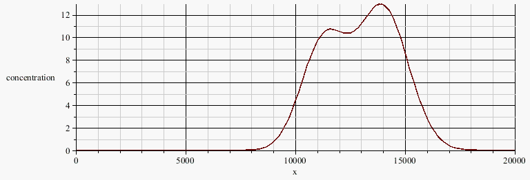

f := unapply(Spline(pts[1], pts[2], x, degree = 2), x):
plot(f(x), x = 0 .. 20000, labels = ["x", "concentration"])

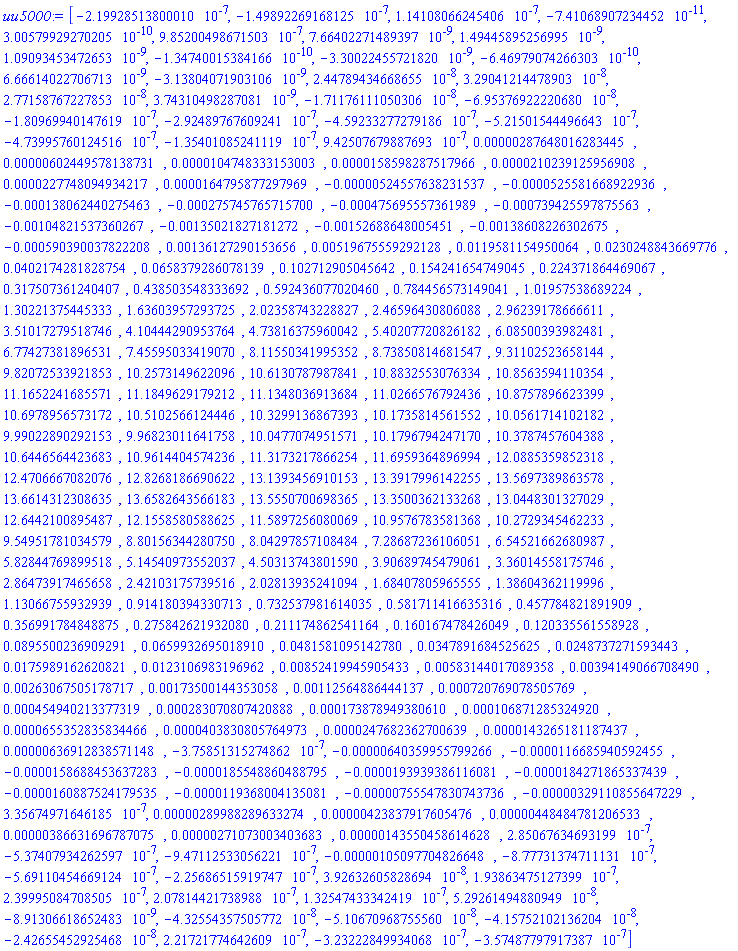

uu5000 := [seq(evalf(Int(E(i-xi, 5000)*f(xi), xi = 0 .. 20000, method = _NCrule, epsilon = 10^(-6))), i = 0 .. 20000, 100)]
[HFloat(-2.1992851380000959e-7), HFloat(-1.4989226916812487e-7), HFloat(1.1410806624540552e-7), HFloat(-7.410689072344523e-11), HFloat(3.005799292702046e-10), HFloat(9.85200498671503e-7), HFloat(7.66402271489397e-9), HFloat(1.4944589525699508e-9), HFloat(1.0909345347265328e-9), HFloat(-1.347400153841658e-10), HFloat(-3.3002245572182045e-9), HFloat(-6.469790742663034e-10), HFloat(6.666140227067126e-9), HFloat(-3.138040719031061e-9), HFloat(2.447894346686553e-8), HFloat(3.290412144789029e-8), HFloat(2.7715876722785253e-8), HFloat(3.743104982870806e-9), HFloat(-1.711761110503056e-8), HFloat(-6.953769222206797e-8), HFloat(-1.8096994014761858e-7), HFloat(-2.924897676092406e-7), HFloat(-4.592332772791863e-7), HFloat(-5.215015444966435e-7), HFloat(-4.7399576012451554e-7), HFloat(-1.3540108524111875e-7), HFloat(9.425076798876926e-7), HFloat(2.8764801628344496e-6), HFloat(6.024495781387309e-6), HFloat(1.0474833315300292e-5), HFloat(1.585982875179663e-5), HFloat(2.1023912595690784e-5), HFloat(2.2774809493421695e-5), HFloat(1.6479587729796864e-5), HFloat(-5.245576382315365e-6), HFloat(-5.2558166892293585e-5), HFloat(-1.380624402754629e-4), HFloat(-2.7574576571570003e-4), HFloat(-4.7569555736198853e-4), HFloat(-7.394255978755631e-4), HFloat(-0.0010482153736026704), HFloat(-0.001350218271812716), HFloat(-0.0015268864800545134), HFloat(-0.0013860822630267539), HFloat(-5.90390037822208e-4), HFloat(0.0013612729015365624), HFloat(0.005196755592921281), HFloat(0.011958115495006439), HFloat(0.023024884366977645), HFloat(0.04021742818287536), HFloat(0.06583792860781386), HFloat(0.10271290504564239), HFloat(0.15424165474904508), HFloat(0.22437186446906676), HFloat(0.3175073612404071), HFloat(0.4385035483336921), HFloat(0.5924360770204598), HFloat(0.7844565731490415), HFloat(1.019575386892244), HFloat(1.302213754453327), HFloat(1.6360395729372545), HFloat(2.0235874322882688), HFloat(2.465964308060876), HFloat(2.9623917866661063), HFloat(3.510172795187464), HFloat(4.104442909537644), HFloat(4.738163759600416), HFloat(5.402077208261823), HFloat(6.085003939824813), HFloat(6.774273818965306), HFloat(7.455950334190702), HFloat(8.115503419953518), HFloat(8.73850814681547), HFloat(9.311025236581445), HFloat(9.820725339218527), HFloat(10.2573149622096), HFloat(10.613078798784128), HFloat(10.883255307633352), HFloat(10.856359411035413), HFloat(11.16522416855706), HFloat(11.184962917921158), HFloat(11.134803691368438), HFloat(11.026657679243602), HFloat(10.87578966233986), HFloat(10.697895657317185), HFloat(10.510256612444557), HFloat(10.32991368673935), HFloat(10.173581456155178), HFloat(10.056171410218234), HFloat(9.990228902921526), HFloat(9.968230116417578), HFloat(10.047707495157132), HFloat(10.179679424716957), HFloat(10.378745760438791), HFloat(10.644656442368278), HFloat(10.961440457423619), HFloat(11.317321786625449), HFloat(11.695936489699424), HFloat(12.088535985231788), HFloat(12.470666708207581), HFloat(12.826818669062217), HFloat(13.139345691015317), HFloat(13.391799614225496), HFloat(13.569738986357798), HFloat(13.661431230863538), HFloat(13.658264356618345), HFloat(13.555070069836518), HFloat(13.350036213326835), HFloat(13.04483013270294), HFloat(12.64421008954875), HFloat(12.155858058862474), HFloat(11.58972560800692), HFloat(10.957678358136778), HFloat(10.27293454622325), HFloat(9.549517810345792), HFloat(8.801563442807502), HFloat(8.04297857108484), HFloat(7.2868723610605075), HFloat(6.545216626809865), HFloat(5.828447698995182), HFloat(5.145409735520372), HFloat(4.503137438015899), HFloat(3.906897454790606), HFloat(3.3601455817574575), HFloat(2.8647391746565836), HFloat(2.421031757395161), HFloat(2.028139352410935), HFloat(1.6840780596555522), HFloat(1.3860436211999592), HFloat(1.13066755932939), HFloat(0.9141803943307134), HFloat(0.7325379816140354), HFloat(0.5817114166353163), HFloat(0.45778482189190894), HFloat(0.3569917848488745), HFloat(0.2758426219320803), HFloat(0.2111748625411637), HFloat(0.16016747842604875), HFloat(0.12033556155892848), HFloat(0.08955002369092911), HFloat(0.06599326950189098), HFloat(0.04815810951427795), HFloat(0.034789168452562476), HFloat(0.024873727159344283), HFloat(0.017598916262082077), HFloat(0.01231069831969616), HFloat(0.008524199459054327), HFloat(0.005831440170893582), HFloat(0.003941490667084899), HFloat(0.002630675051787171), HFloat(0.001735001443530577), HFloat(0.0011256488644413724), HFloat(7.207690785057685e-4), HFloat(4.5494021337731883e-4), HFloat(2.830708074208877e-4), HFloat(1.7387894938060964e-4), HFloat(1.0687128532492048e-4), HFloat(6.553528358344664e-5), HFloat(4.03830805764973e-5), HFloat(2.476823627006392e-5), HFloat(1.432651811874368e-5), HFloat(6.369128385711481e-6), HFloat(-3.758513152748625e-7), HFloat(-6.403599557992656e-6), HFloat(-1.166859405924552e-5), HFloat(-1.5868845363728307e-5), HFloat(-1.8554886048879536e-5), HFloat(-1.9393938611608052e-5), HFloat(-1.8427186533743853e-5), HFloat(-1.6088752417953466e-5), HFloat(-1.193680041350809e-5), HFloat(-7.555478307437356e-6), HFloat(-3.2911085564722923e-6), HFloat(3.356749716461853e-7), HFloat(2.8998828963327384e-6), HFloat(4.238379176054762e-6), HFloat(4.4848478120653275e-6), HFloat(3.866316967870751e-6), HFloat(2.7107300340368345e-6), HFloat(1.4355045861462792e-6), HFloat(2.850676346931986e-7), HFloat(-5.374079342625969e-7), HFloat(-9.471125330562209e-7), HFloat(-1.0509770482664845e-6), HFloat(-8.777313747111306e-7), HFloat(-5.691104546691238e-7), HFloat(-2.2568651591974698e-7), HFloat(3.926326058286941e-8), HFloat(1.93863475127399e-7), HFloat(2.3999508470850535e-7), HFloat(2.0781442173898844e-7), HFloat(1.3254743334241917e-7), HFloat(5.292614948809493e-8), HFloat(-8.91306618652483e-9), HFloat(-4.3255435750577205e-8), HFloat(-5.106709687555605e-8), HFloat(-4.157521021362038e-8), HFloat(-2.4265545292546804e-8), HFloat(2.2172177464260928e-7), HFloat(-3.232228499340677e-7), HFloat(-3.574877979173867e-7)]

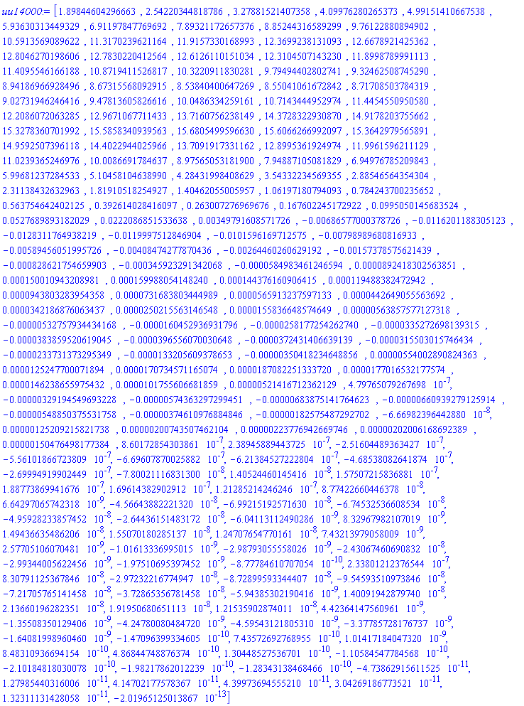

uu14000 := [seq(evalf(Int(E(i-xi, 14000)*f(xi), xi = 0 .. 20000, method = _NCrule, epsilon = 10^(-6))), i = 0 .. 20000, 100)]
[HFloat(1.8984460429666323), HFloat(2.542203448187856), HFloat(3.278815214073577), HFloat(4.099762802653735), HFloat(4.991514106675378), HFloat(5.9363031344932855), HFloat(6.911978477696919), HFloat(7.893211726573761), HFloat(8.852443165892987), HFloat(9.761228808949022), HFloat(10.591356908962199), HFloat(11.31702396211637), HFloat(11.9157330168993), HFloat(12.369923813109331), HFloat(12.667892142536154), HFloat(12.804627019860604), HFloat(12.783022041256418), HFloat(12.612611015103397), HFloat(12.310450714322979), HFloat(11.899878999111325), HFloat(11.40955461661877), HFloat(10.871941152681682), HFloat(10.322091183028114), HFloat(9.794944028027414), HFloat(9.324625087452905), HFloat(8.94186966928496), HFloat(8.673155680929145), HFloat(8.538404006472692), HFloat(8.550410616728419), HFloat(8.717085037843194), HFloat(9.02731946246416), HFloat(9.478136058266164), HFloat(10.048633425916135), HFloat(10.714344495297375), HFloat(11.445455095057982), HFloat(12.208607206328521), HFloat(12.967106771143273), HFloat(13.716075623814897), HFloat(14.372832293087027), HFloat(14.917820375566151), HFloat(15.327836070199165), HFloat(15.585834093956311), HFloat(15.680549959663027), HFloat(15.606626699209665), HFloat(15.364297956589061), HFloat(14.959250739611827), HFloat(14.402294402596562), HFloat(13.709191733116185), HFloat(12.899536192497393), HFloat(11.996159621112872), HFloat(11.023936524697616), HFloat(10.008669178463672), HFloat(8.975650531818998), HFloat(7.948871050818295), HFloat(6.949767852098431), HFloat(5.996812372845334), HFloat(5.104581046389905), HFloat(4.284319984086291), HFloat(3.5433223456935528), HFloat(2.8854656435430406), HFloat(2.3113843263296276), HFloat(1.8191051825492703), HFloat(1.4046205500595659), HFloat(1.0619718079409348), HFloat(0.784243700235652), HFloat(0.5637546424021248), HFloat(0.39261402841609716), HFloat(0.26300727696967563), HFloat(0.1676022451729217), HFloat(0.09950501456835244), HFloat(0.05276898931820286), HFloat(0.022208685153363765), HFloat(0.0034979160857172642), HFloat(-0.0068657700037872615), HFloat(-0.011620118830512255), HFloat(-0.012831176493821891), HFloat(-0.01199975128469045), HFloat(-0.010159616971257486), HFloat(-0.007989896808169333), HFloat(-0.00589456051995726), HFloat(-0.00408474277870436), HFloat(-0.002644602606291918), HFloat(-0.0015737857562143872), HFloat(-8.286217546599032e-4), HFloat(-3.4592329134206765e-4), HFloat(-5.849834612465939e-5), HFloat(8.924183025638507e-5), HFloat(1.5001094320898133e-4), HFloat(1.5998805414824002e-4), HFloat(1.4437616090641532e-4), HFloat(1.1948838247294166e-4), HFloat(9.438032839543576e-5), HFloat(7.316838034449886e-5), HFloat(5.6591323759713274e-5), HFloat(4.4264905556369225e-5), HFloat(3.42186876063437e-5), HFloat(2.5021556314654777e-5), HFloat(1.5583664857464896e-5), HFloat(5.6385757712731825e-6), HFloat(-5.3275793443416805e-6), HFloat(-1.6045293693179578e-5), HFloat(-2.5817725426274037e-5), HFloat(-3.352726981393149e-5), HFloat(-3.8385952061904546e-5), HFloat(-3.965560700306478e-5), HFloat(-3.7243140663913855e-5), HFloat(-3.155030157464335e-5), HFloat(-2.337313732953488e-5), HFloat(-1.3320560937865262e-5), HFloat(-3.50418234648856e-6), HFloat(5.540028908243629e-6), HFloat(1.2524770007189394e-5), HFloat(1.7073457116507357e-5), HFloat(1.8708225133371985e-5), HFloat(1.7701653217757437e-5), HFloat(1.4623865597543186e-5), HFloat(1.0175560668185901e-5), HFloat(5.214167123621291e-6), HFloat(4.797650792676976e-7), HFloat(-3.2919454969322776e-6), HFloat(-5.7436329729945125e-6), HFloat(-6.838751417646233e-6), HFloat(-6.6093927912591425e-6), HFloat(-5.4885037553175774e-6), HFloat(-3.746109768848459e-6), HFloat(-1.8257548729270171e-6), HFloat(-6.669823964428799e-8), HFloat(1.252092158217382e-6), HFloat(2.0074350746210378e-6), HFloat(2.2377694266974552e-6), HFloat(2.02006168692389e-6), HFloat(1.504764981773835e-6), HFloat(8.601728543038608e-7), HFloat(2.3894588944372517e-7), HFloat(-2.5160448936342736e-7), HFloat(-5.561018667238092e-7), HFloat(-6.696078700258816e-7), HFloat(-6.213845272228045e-7), HFloat(-4.68538082641874e-7), HFloat(-2.69994919902449e-7), HFloat(-7.800211168313004e-8), HFloat(1.4052446014541566e-8), HFloat(1.5750721583688112e-7), HFloat(1.8877386994167574e-7), HFloat(1.6961438290291193e-7), HFloat(1.2128521424624616e-7), HFloat(8.774226604463782e-8), HFloat(6.642970657423184e-9), HFloat(-4.566438822213199e-8), HFloat(-6.992151925716301e-8), HFloat(-6.745325366085338e-8), HFloat(-4.959282338574516e-8), HFloat(-2.6443615148317168e-8), HFloat(-6.041131124902863e-9), HFloat(8.329679821070189e-9), HFloat(1.4943663548620636e-8), HFloat(1.55070180285137e-8), HFloat(1.247076547701608e-8), HFloat(7.432139790580089e-9), HFloat(2.5770510607048068e-9), HFloat(-1.0161333699501456e-9), HFloat(-2.987930555580264e-9), HFloat(-2.4306746069083186e-8), HFloat(-2.9934400562245605e-9), HFloat(-1.9751069539745235e-9), HFloat(-8.777846107070544e-10), HFloat(2.3380121237654402e-7), HFloat(8.30791125367846e-8), HFloat(-2.972322167749468e-8), HFloat(-8.728995933444071e-8), HFloat(-9.545935109738457e-8), HFloat(-7.217057651414578e-8), HFloat(-3.7286535678145796e-8), HFloat(-5.943853021904159e-9), HFloat(1.4009194287973976e-8), HFloat(2.1366019628235056e-8), HFloat(1.9195068065111276e-8), HFloat(1.2153590287401112e-8), HFloat(4.423641475609614e-9), HFloat(-1.3550835012940617e-9), HFloat(-4.247800804847201e-9), HFloat(-4.595431218053097e-9), HFloat(-3.37785728176737e-9), HFloat(-1.6408199896045958e-9), HFloat(-1.470963993346052e-10), HFloat(7.435726927689552e-10), HFloat(1.0141718404732006e-9), HFloat(8.483109366941543e-10), HFloat(4.868447488763738e-10), HFloat(1.3044852753670129e-10), HFloat(-1.1058454778456778e-10), HFloat(-2.101848180300784e-10), HFloat(-1.9821786201223902e-10), HFloat(-1.2834313846846617e-10), HFloat(-4.738629156115246e-11), HFloat(1.2798544031600627e-11), HFloat(4.14702177578367e-11), HFloat(4.399736945552101e-11), HFloat(3.0426918677352054e-11), HFloat(1.3231113142805841e-11), HFloat(-2.0196512501386664e-13)]

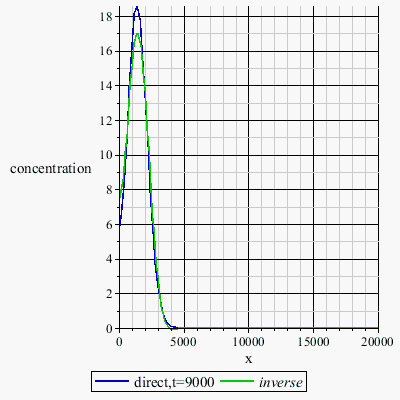

p9 := pds1:-plot(t = 12000, numpoints = 100, color = blue, legend = ["direct,t=9000"], labels = ["x", "concentration"])
p10 := plot(xx, uu18000, color = green, legend = [''inverse''])

plots[display]({p7, p8})
plots[display]({p10, p9})
