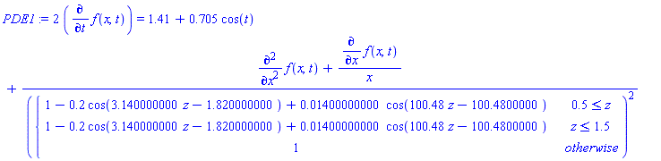

In my problem, L(z) is a piecewise condition.
L(z):
I have to calculate the f(x,t) value at x=0.71,t=1.12 and z=0.71 for L(z)=0..1.

PDE1 :=ra*(diff(f(x,t),t))=+b1*(1+ea*cos(t))+(1/(L(z)^2))*((diff(f(x,t),x,x))+(1/x)*diff(f(x,t),x));
PDE1 := 2*(diff(f(x, t), t)) = 1.41+.705*cos(t)+(diff(f(x, t), x, x)+(diff(f(x, t), x))/x)/piecewise(.5 <= z, 1-.2*cos(3.140000000*z-1.820000000)+0.1400000000e-1*cos(100.48*z-100.4800000), z <= 1.5, 1-.2*cos(3.140000000*z-1.820000000)+0.1400000000e-1*cos(100.48*z-100.4800000), 1)^2
