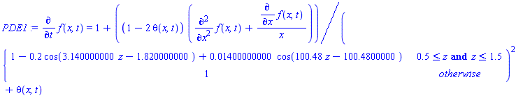

PDE1 :=(diff(f(x,t),t))=1+(1-2*theta((x,t)))*(1/(R(z)^2))*((diff(f(x,t),x,x))+(1/x)*diff(f(x,t),x))+theta((x,t));
PDE1 := diff(f(x, t), t) = 1+(1-2*theta(x, t))*(diff(f(x, t), x, x)+(diff(f(x, t), x))/x)/piecewise(.5 <= z and z <= 1.5, 1-.2*cos(3.140000000*z-1.820000000)+0.1400000000e-1*cos(100.48*z-100.4800000), 1)^2+theta(x, t)

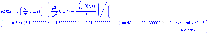

PDE2 :=2*(diff(theta(x,t),t))=(1/(R(z)^2))*((diff(theta(x,t),x,x))+(1/x)*diff(theta(x,t),x));
PDE2 := 2*(diff(theta(x, t), t)) = (diff(theta(x, t), x, x)+(diff(theta(x, t), x))/x)/piecewise(.5 <= z and z <= 1.5, 1-.2*cos(3.140000000*z-1.820000000)+0.1400000000e-1*cos(100.48*z-100.4800000), 1)^2
