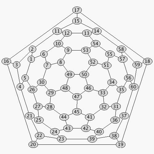

Question: Solve the resistor grid of 1 ohm.
R1 - R31 resistance is 17/11 ohm. (Top to bottom)
R1 - R2 resistance is 16273/25080 ohm. ( Each one element's node to node)
Can any one solve these Electric Circuit?
