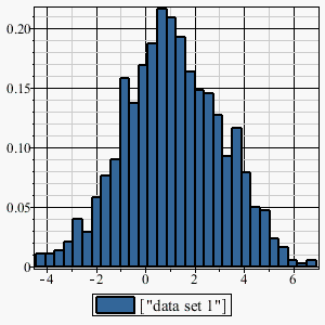

Maple 2022 as opposed to Maple 2021 does not consider this a valid way to define the legend. It works fine in Maple 2021. Maple 2022, want's it defined in a list. This works but, the square brackets and quotation marks appear when I don't want them to. The legend shouldn't have these extra quotations and brackets, just the desired name.
Histogram(s, legend = ["data set 1"], size = [300, 300])

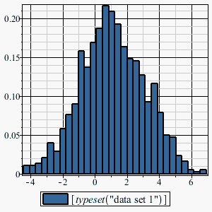

I tried the typeset command. It doesn't seem to be recognized anymore.
Histogram(s, legend = [typeset("data set 1")], size = [300, 300])
