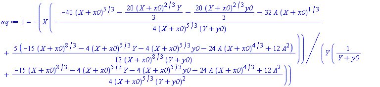

eq:=1 = -X*(-1/4*(-40*(X + x0)^(5/3) - 20/3*(X + x0)^(2/3)*Y - 20/3*(X + x0)^(2/3)*y0 - 32*A*(X + x0)^(1/3))/((X + x0)^(5/3)*(Y + y0)) + 5/12*(-15*(X + x0)^(8/3) - 4*(X + x0)^(5/3)*Y - 4*(X + x0)^(5/3)*y0 - 24*A*(X + x0)^(4/3) + 12*A^2)/((X + x0)^(8/3)*(Y + y0)))/(Y*(1/(Y + y0) + 1/4*(-15*(X + x0)^(8/3) - 4*(X + x0)^(5/3)*Y - 4*(X + x0)^(5/3)*y0 - 24*A*(X + x0)^(4/3) + 12*A^2)/((X + x0)^(5/3)*(Y + y0)^2)));
1 = -X*(-(1/4)*(-40*(X+x0)^(5/3)-(20/3)*(X+x0)^(2/3)*Y-(20/3)*(X+x0)^(2/3)*y0-32*A*(X+x0)^(1/3))/((X+x0)^(5/3)*(Y+y0))+(5/12)*(-15*(X+x0)^(8/3)-4*(X+x0)^(5/3)*Y-4*(X+x0)^(5/3)*y0-24*A*(X+x0)^(4/3)+12*A^2)/((X+x0)^(8/3)*(Y+y0)))/(Y*(1/(Y+y0)+(1/4)*(-15*(X+x0)^(8/3)-4*(X+x0)^(5/3)*Y-4*(X+x0)^(5/3)*y0-24*A*(X+x0)^(4/3)+12*A^2)/((X+x0)^(5/3)*(Y+y0)^2)))
