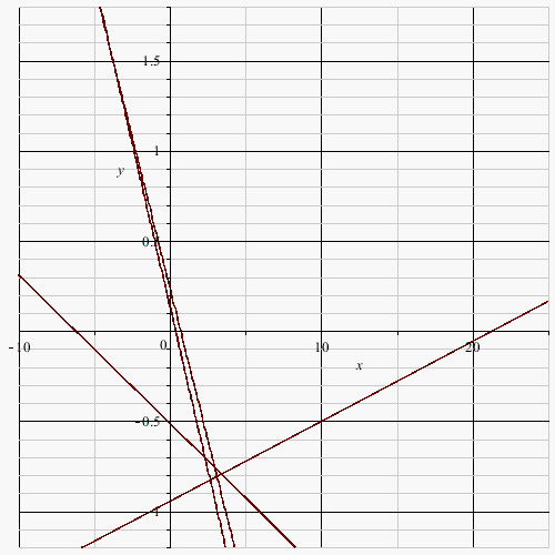

plots:-implicitplot([l12, l34, l13, l24])

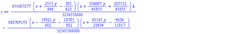

c := simplify(c2*lambda+c1)
(655607277/3256558808)*(x+(2515/846)*y-305/423)*(x+(556007/45855)*y+285532/45855)*lambda-(880709193/32565588080)*(x-(19921/882)*y-18785/882)*(x+(65165/23634)*y-4636/11817)

plt1 := plot(Y, X = -10 .. 10)
plt2 := plots:-implicitplot([c])
plots:-display(plt1, plt2, colour = ["Red", "Green"])

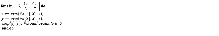

for i in [-7, 13/3, 42*(1/7)] do x := eval(Pn[1], X = i); y := eval(Pn[2], X = i); simplify(c) end do
0
