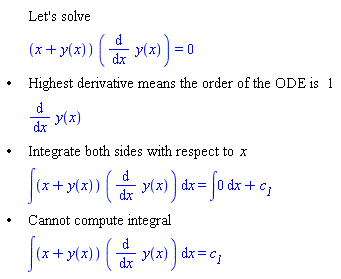

Question: why ODESteps(ode) unable to solve this first order quadrature ode?
This ode can be solved by just looking at it
ode:=(x+y(x))*diff(y(x),x)=0;
We see the solution is y=-x and y=c__1 because either (x+y)=0 or y'=0
But for some reason ODESteps(ode) says it cannot compute integral.
Any idea why?
26348
interface(version);
`Standard Worksheet Interface, Maple 2024.0, Windows 10, March 01 2024 Build ID 1794891`
Student:-ODEs:-ODESteps(ode);
ode := (x+y(x))*(diff(y(x), x)) = 0
"[[,,"Let's solve"],[,,(x+y(x)) ((ⅆ)/(ⅆx) y(x))=0],["•",,"Highest derivative means the order of the ODE is" 1],[,,(ⅆ)/(ⅆx) y(x)],["•",,"Integrate both sides with respect to" x],[,,∫(x+y(x)) ((ⅆ)/(ⅆx) y(x)) ⅆx=∫0 ⅆx+`c__1`],["•",,"Cannot compute integral"],[,,∫(x+y(x)) ((ⅆ)/(ⅆx) y(x)) ⅆx=`c__1`]]"
Download odestep_quadrature_unable_to_solve_maple_2024.mw

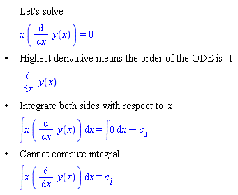

update:
Here is another simpler example that also confused it
26348
interface(version);
ode:=x*diff(y(x),x)=0;
ode := x*(diff(y(x), x)) = 0
"[[,,"Let's solve"],[,,x ((ⅆ)/(ⅆx) y(x))=0],["•",,"Highest derivative means the order of the ODE is" 1],[,,(ⅆ)/(ⅆx) y(x)],["•",,"Integrate both sides with respect to" x],[,,∫x ((ⅆ)/(ⅆx) y(x)) ⅆx=∫0 ⅆx+`c__1`],["•",,"Cannot compute integral"],[,,∫x ((ⅆ)/(ⅆx) y(x)) ⅆx=`c__1`]]"
Download odestep_quadrature_unable_to_solve_v2_maple_2024.mw

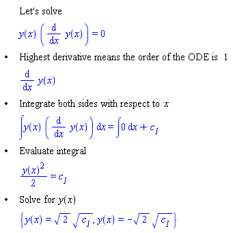

Here is another one which it gets wrong.
26348
interface(version);
ode:=y(x)*diff(y(x),x)=0;
ode := y(x)*(diff(y(x), x)) = 0
"[[,,"Let's solve"],[,,y(x) ((ⅆ)/(ⅆx) y(x))=0],["•",,"Highest derivative means the order of the ODE is" 1],[,,(ⅆ)/(ⅆx) y(x)],["•",,"Integrate both sides with respect to" x],[,,∫y(x) ((ⅆ)/(ⅆx) y(x)) ⅆx=∫0 ⅆx+`c__1`],["•",,"Evaluate integral"],[,,((y(x))^2)/2=`c__1`],["•",,"Solve for" y(x)],[,,{y(x)=sqrt(2) sqrt(`c__1`),y(x)=-sqrt(2) sqrt(`c__1`)}]]"
dsolve(ode);
y(x) = 0, y(x) = -c__1
The correct solution is given by dsolve, which is y=0 and y=constant (I do not know why dsolve put minus sign in front of the constant, but it is still correct).
