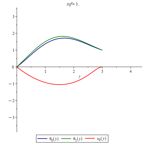

Question: Animation of the plots
How to get the animation graphs for eta =0..10

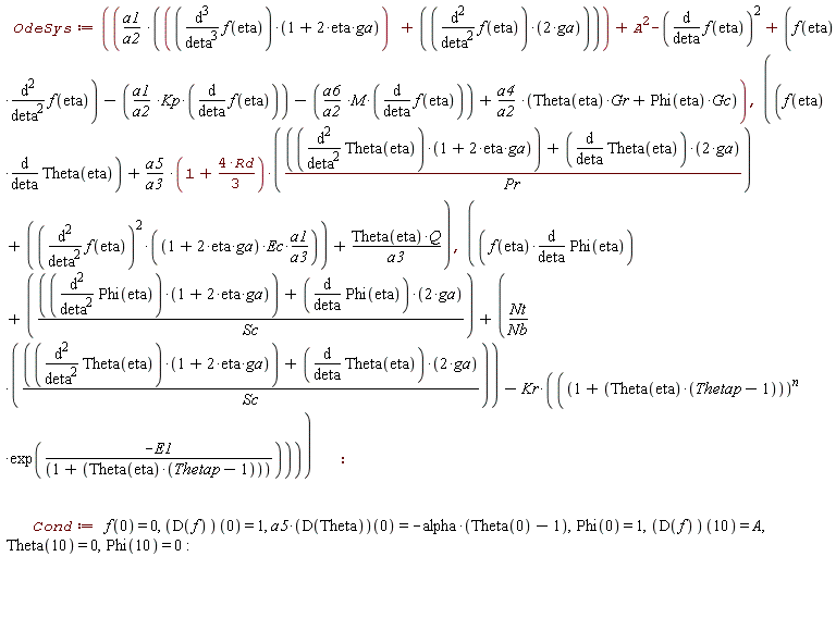

OdeSys := a1*((diff(f(eta), eta, eta, eta))*(2*eta*ga+1)+2*(diff(f(eta), eta, eta))*ga)/a2+A^2-(diff(f(eta), eta))^2+f(eta)*(diff(f(eta), eta, eta))-a1*Kp*(diff(f(eta), eta))/a2-a6*M*(diff(f(eta), eta))/a2+a4*(Theta(eta)*Gr+Phi(eta)*Gc)/a2, f(eta)*(diff(Theta(eta), eta))+a5*(1+4*Rd*(1/3))*((diff(Theta(eta), eta, eta))*(2*eta*ga+1)+2*(diff(Theta(eta), eta))*ga)/(a3*Pr)+(diff(f(eta), eta, eta))^2*(2*eta*ga+1)*Ec*a1/a3+Theta(eta)*Q/a3, f(eta)*(diff(Phi(eta), eta))+((diff(Phi(eta), eta, eta))*(2*eta*ga+1)+2*(diff(Phi(eta), eta))*ga)/Sc+Nt*((diff(Theta(eta), eta, eta))*(2*eta*ga+1)+2*(diff(Theta(eta), eta))*ga)/(Nb*Sc)-Kr*(1+Theta(eta)*(Thetap-1))^n*exp(-E1/(1+Theta(eta)*(Thetap-1))); Cond := f(0) = 0, (D(f))(0) = 1, a5*(D(Theta))(0) = -alpha*(Theta(0)-1), Phi(0) = 1, (D(f))(10) = A, Theta(10) = 0, Phi(10) = 0

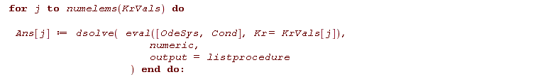

KrVals := [0.1e-1, .1, .2, .3]
for j to numelems(KrVals) do Ans[j] := dsolve(eval([OdeSys, Cond], Kr = KrVals[j]), numeric, output = listprocedure) end do

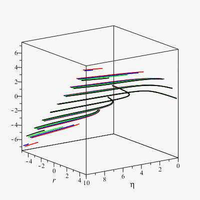

plotA1 := display(seq(plot3d(r*(eval(f(:-eta), Ans[k]))(eta), eta = 0 .. 10, r = -5 .. 5, color = cols[k]), k = 1 .. nops(KrVals)), linestyle = "solid", style = contour, thickness = 1)
Download ode_plots_animation_graphs.mw
i need like this demo plot
